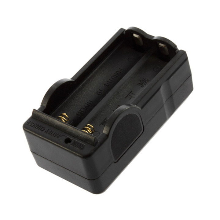

        Originally posted by Fabian View Post

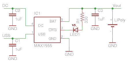

        Hi Waikiki_Sweep. I'm searching for a way to re-use Li-Ion batteries in my MD's, and one of the things I am having difficulties with is to find a DIY charger that I could use with confidence. Can you tell me what kind of charger you use for your MD? it would be great if you have a schematics too.
        Fabian
        I am using cheap chargers from eBay. http://www.ebay.com/sch/i.html?_nkw=18650+charger You can buy one starting $2.45 free shipping.
        Quality not always great but from 5 chargers I have selected 3 working good. You can always check result with testers to be sure that charger cut of charge at 4.2 volts. (Some of them did not)
        If you want to build one DIY you can use chip MAX1555
        http://datasheets.maximintegrated.co...51-MAX1555.pdf

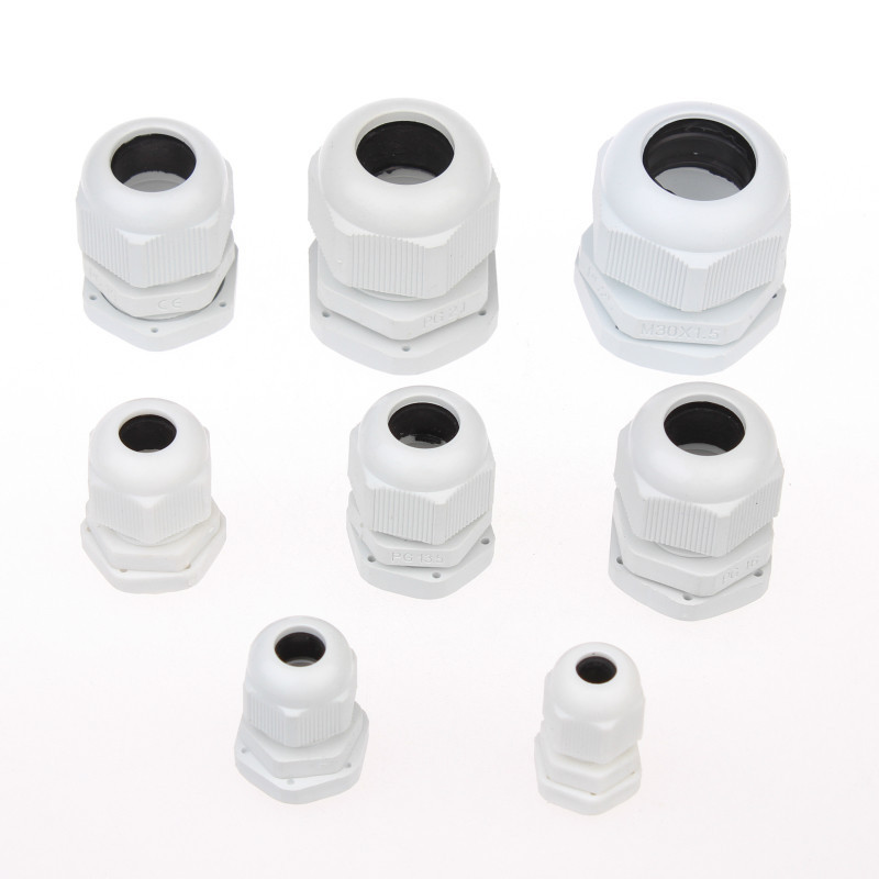

            Cable Gland Waterproof
            Do not forget to buy Cable Gland on eBay. For example http://www.ebay.com/itm/130750191474
            20pcs PG7 PG07 Waterproof Connector Gland Dia. 3.5-6mm Cable
            It will help you to waterproof your coil and headphone cables where they go to box.
            Buy as smaller size as possible that fits your cable diameter to get better waterproofing.
            It is cheap, easy to install, easy to insert and remove cables when repair is needed.
            Also seller shipped it from China less then in one week. That is surprising.

            No. D1(mm) D2(mm) L1(mm) L2(mm) L3(mm) L4(mm) B1(mm) Cable Range(mm)
            PG7 12.0 8.1 9 5 15 14.0 6.4 3.5-6
            PG9 16.0 11.0 9 5 15 16.0 8.6 4-8
            PG11 17.9 13.0 9 5 18 18.0 10.7 5-10
            PG13.5 20.2 15.0 9 5 20 19.0 13.3 6-12

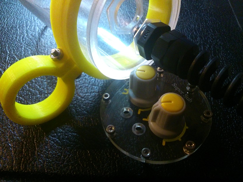

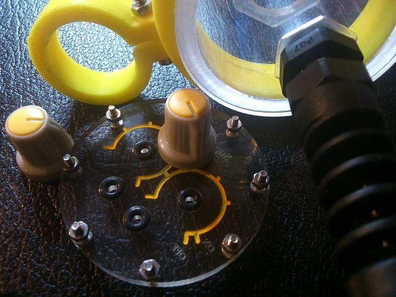

                Hi everyone this is my new design of waterproof box. Its very easy to make. only you need the next materials acrylic, glue, screws, o-rings etc. In few days Ill explain the making procedure
                  Where did you get a pipe?

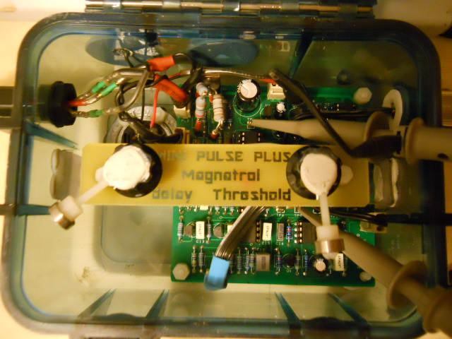

                    Hello Waikiki_Sweep
                    Which brings me to an idea: Could I not use the water proof Cable Gland for potentiometer? (Pot with long shaft) At least to the circuit to protect against splashes.
                    Dirk
                    Surely I can do that in a device-a plastic bag even in stormy weather ....

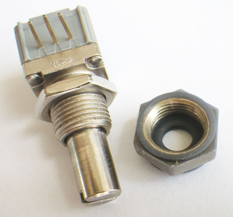

                      Originally posted by Dixix View Post
                      Hello Waikiki_Sweep
                      Dirk
                      That is interesting idea. Probably it may works. You just need to buy smaller of Cable Gland and use some lubricant like silicone lubricant for O-rings. I am using corn oil to lubricate O-ring in my waterproof camera case detector. It works well for few years already but with time corn oil hardening and I have to clean it out.
                      Do not use mineral oil based lubricants because it will destroy rubber ring inside Cable Gland.
                      I have used more expensive solution in my detector: HEXSEAL from Digikey. It is nut with silicone sealing you can put on regular potentiometer.
                      http://www.geotech1.com/forums/showt...867#post153867
