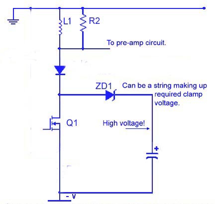

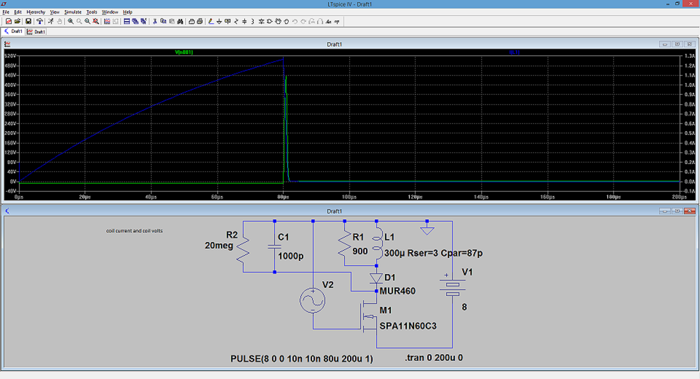

            • Been looking at snubbers. Wondering if adding C1 sized to limit voltage would work or what is the best way?
              • C1 will be in series with the diode intrinsic capacitance (C across the coil) and delay settling the FB voltage, C is the enemy R is your friend.
                • The zener is chosen for the desired clamp voltage. It behaves as a normal diode during the spike and behaves as a zener when the FET turns on. The cap can be a 1uF or similar non-polarised. Nothing gets hot. You could also use a separate FET and a normal diode in parallel with the zener with a resistor to slow down the discharge but the method does work as shown.
                  Don't touch the terminals when charged!
                  • Originally posted by crane View Post
                    Thanks for the replies, looks good. I needed to order some parts and wanted to try eliminating the fet avalanching.

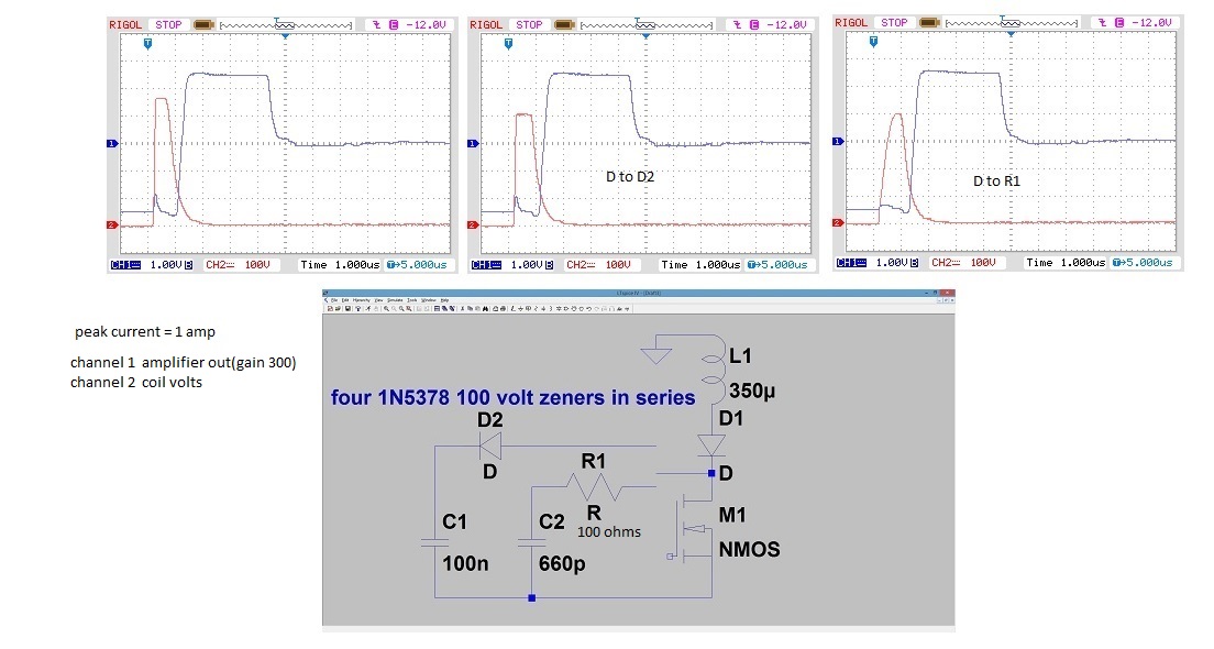

                      The circuit looks good. The 100n capacitor seemed to be enough for 1 amp peak current. Tried another circuit. Both add a little to the delay time. Is there a reason for the snubber other than protecting the Mosfet? Is a snubber needed at lower peak currents?
                        Didn't notice any difference monitoring integrator out with the different circuits yesterday. I have been playing with the coil current in a control loop and noticed the circuit with the zener diodes eliminated a glitch in the current loop, so I'll be using it.

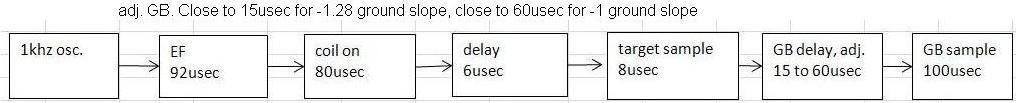

                        • Made a new controller. Tried the sequence from reply 102. Looks like it works ok. Did a ground decay in excel. The times I get in excel using a -1.25 slope match what I get on the bench with ground that charted about -1.25. Excel predicts a 23usec TC hole. What would be best hole TC to try for?

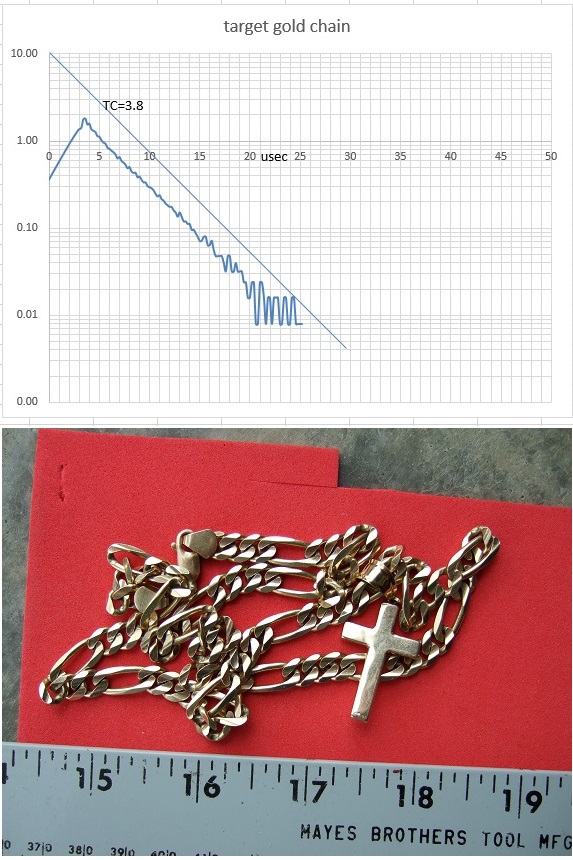

                          • Charted a gold chain. Recorded as shown in picture. Lower TC than I expected.

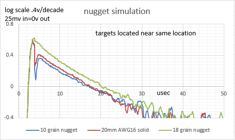

                            • Detector circuit not working to test distance measurement, so I tried the 10grain(TC=6.6usec), 18grain nugget(TC=5.4usec) and a 20mm piece of AWG16(TC=5usec) solid copper wire from charts reply#15 with target response tester. Signal strength not as high as I would like with 200mm figure eight coil but think results aren't bad. Need to finish my detector to see how distance measurement compares. Interested in someone trying detection distance with a 20mm piece of AWG16 solid copper wire.
                              Added links from reply#15(Gold Results)
                              http://www.geotech1.com/forums/attac...9&d=1543333008
                              http://www.geotech1.com/forums/attac...0&d=1543333065
