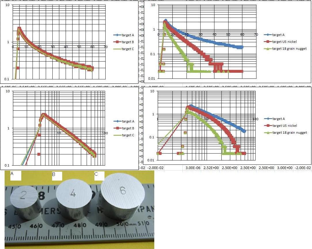

    Charted some aluminum targets.
    • #92
      Hi Green
      The aluminium time constant does not appear to be a very good match to the gold nugget time constant.
      Thank you again for your charts,
      Chet
          Thanks Green,
          My first impression of these targets is that they are very large and their size is more representative of very large gold nuggets not generally found by most detectorists. The smallest of these simulators is said to represent a 20 gram (300+ grain) nugget and is indeed a huge target. The sheer mass of these simulators results in the long T/Cs.
          I lean toward simulators of much smaller targets in the 1/3 gram (5 grain) as it is far more probable to find these size nuggets in this area. A 0.7 grain 1/8"diameter cylindrical aluminum slug does a good job of emulating a 5 grain nugget in my testing and the T/C is much shorter as well.
          Dan

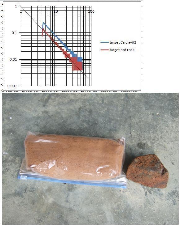

            Some different clay and a hot rock from Ca. Wondered if a hot rock and ground had a similar decay. Looks close.

                        Wondered why that would be true when the three test pieces charted the same decay slope. Charted the 2 and 2,4,6 together. They charted the same. Agree, the nugget shape has a lot to do with the TC. When charting the 10 and 18 grain nuggets the 18 grain had a shorter TC than the 10 grain.

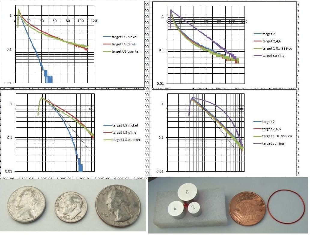

                        Charted some other targets including a 1 oz .999% copper coin. Added the clay decay curve to the log-log charts. I've been trying to pick the best delay and sample times to GB. Looking at the decay curves, a longer delay between the target and GB sample would make more sense than what I've read. Coil on time was 80 usec for the tests. On time does effect the ground and longer TC slopes. The chart time scale is usec., with zero being gate off.

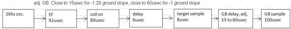

                          Not as long a delay as I was thinking. Control sequence for small gold. My best guess looking at recorded data. May be all wrong or won't work.
                          • Hi Green,
                            Those are good views on ground balancing. Moving the ground balance sample time out past small gold time constants makes sense.
