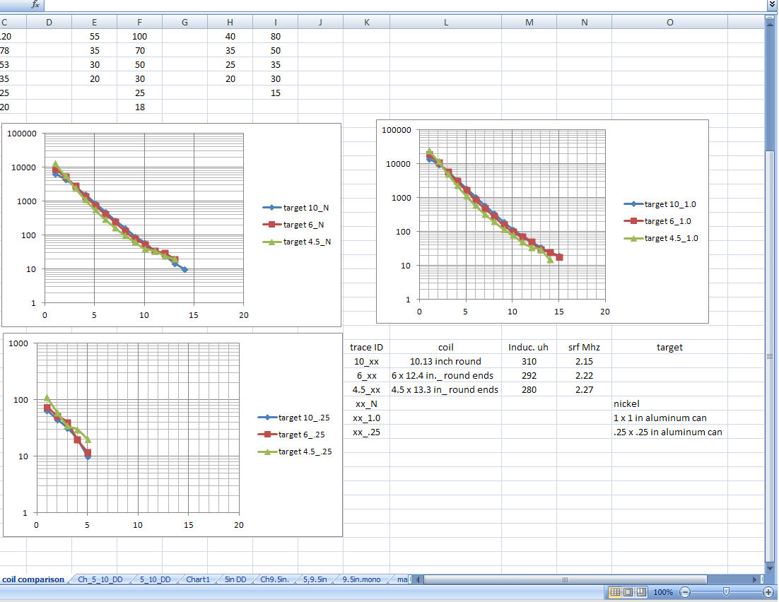

    I've read it takes 64 times the power to double the detection depth. The plotted data shows it takes about 10 times the current to get the same signal for each 5 inch increase in depth. If the detection depth is 5 inches it would take 10 times the current to double the distance. If detection depth is 10 inches it would take 100 times the current to double the depth. Is my thinking wrong or are the plots wrong?
    Well it depends... On my current Bandito build I found better air depth with less power.
    Others with the Natilus have reported greater ground depth with less power.
    You see it's all about seeing the target not getting a signal to a certain depth. A higher
    power can magnetized the soil making it hard to see deep...
    Now a PI on beach sand might be able to use your 100x power to see a bit deeper...
      Also, If you move the coil slower you will get more signal vs noise , the average of the random noise will tend towards zero.
      So, if you moved the coil really slowly, say 1 cm every hour, and take lots of measurements, and store it in a PC.
      You may have more depth... without any increase in power.
      If you put the coil on a GPS position plotting cart, and allowed it to slowly autonomously scan a track over a few hours, maybe we would get more depth without any increase in power (perhaps)
      Or, if you sense the peak current in the target during the pulse switch ON or OFF, rather than the decaying remnants of this signal a few 10's of usecs later, you could possibly get more depth.
        Detection depth is also increased by the use of larger search coils.
        To double the detection depth each loop of any given IB coil design have to be 4 times larger diameter.
        So if you could pick up a quarter dollar at 15" with figure of 8th search coil with 8" loop diameter, to double that depth you will need the diameter of the loops to increase to 32", four times the diameter of the small loops.
        There is no need to raise the power consumption in this case, but the coil loops would be way too big.
          Detection depth is increased by obtaining an increase in signal to noise ratio, reduce the transmit power as not to excite the minerals in the soil and improve the the receiver performance, most metal detectors have pathetic front end receivers.
