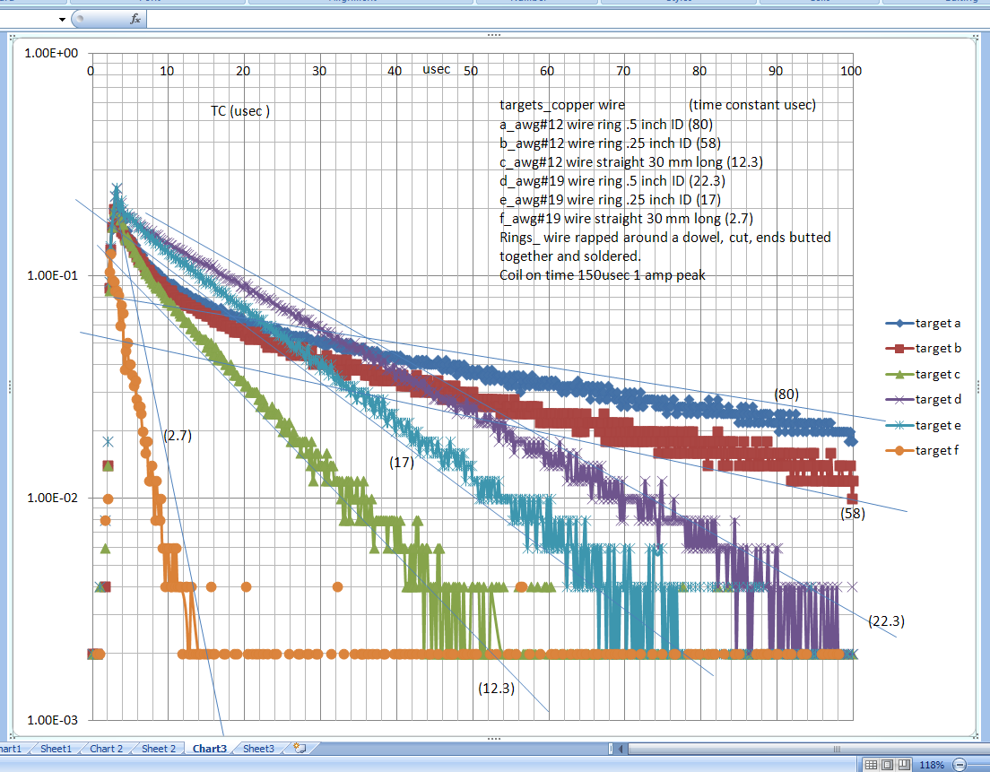

        • Reply #129 I recorded some data using lead solder, couldn't plot the time constant for a straight piece. Today I recorded some copper wire targets to see how much shorter the time constant is for a straight piece vs a loop. Don't know if the ratio would be the same for lead. If it is the time constant for a straight piece of lead would be less than .3 usec. (reply 135, Tried to flatten the solder, couldn't get it wide enough).
            Just for fun I melted the 39mm piece of .8mm 60/40 solder into a .133" X .090" naturally flattened bead and my detector set wide open and at 8us delay sees it pretty solidly at .5 inch, a very tough target. Then pounded it on an anvil to a .256" X .022" disk and it was solidly detected at 1.375". Pounded it again into an oval .378" X .320" X .015" thick and it is detected at 2". It would be good to know how a pure tin target responds.

                              I don't think a material has a time constant. If I measure the time constant of squares cut from an aluminum can the time constant changes with area. Which brings up the question of what should our test targets look like? For a PI I think we should have short and long time constant targets. Maybe we could define what type targets we need for the different type detectors.
                              • If you take a square of copper and an identical square of lead you will see the difference of TC.
                                I use targets of the same surface area but different thickness or different metals or different alloys. They have different TC's.
                                Titanium in general, for example has a very short TC, but the different alloys of titanium again have different TC's.
