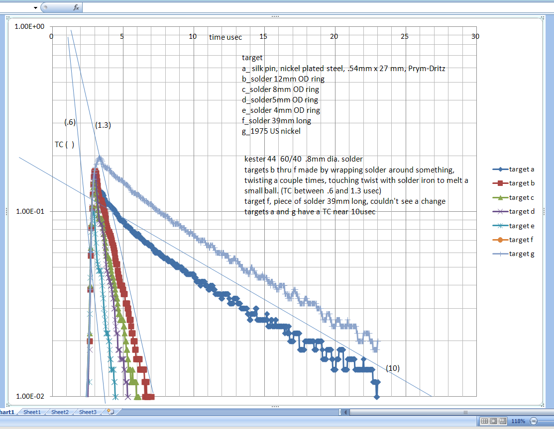

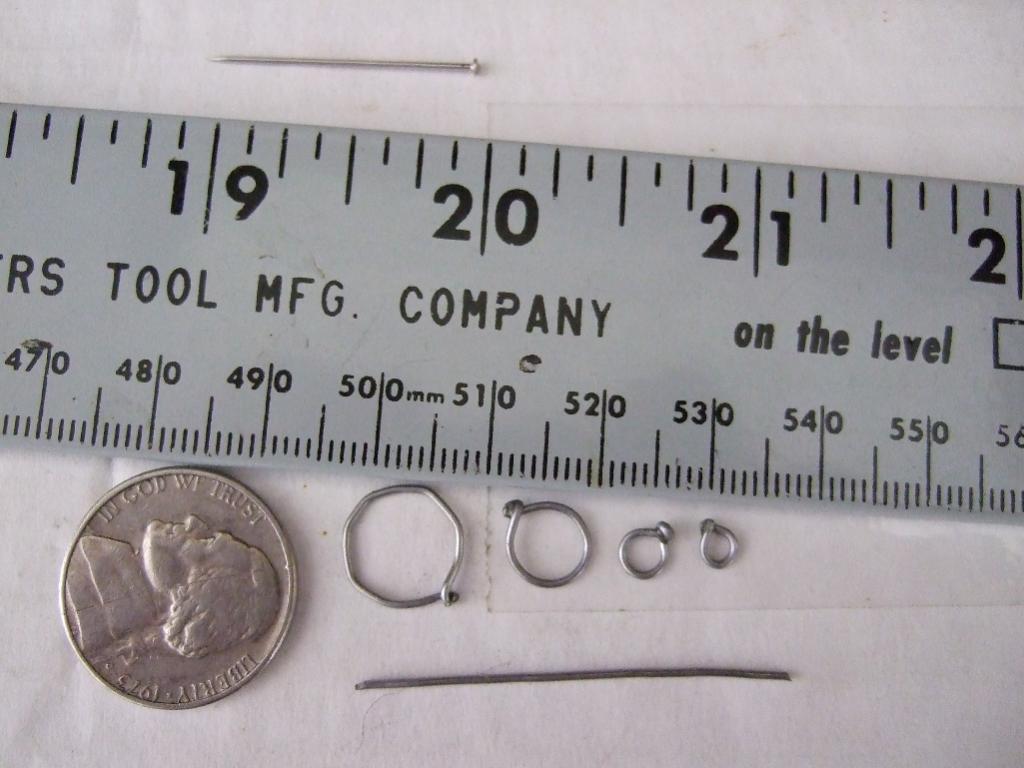

                  • Been trying to understand what it takes to detect hypo needles. Stainless has a conductivity about 1/10 of nickel. Solder was mentioned as a possible test target. Conductivity between stainless and nickel. I plotted some targets made with solder, a nickel and a silk pin. Couldn't see a 39 mm piece of solder until I wrapped the solder in a circle. Wondering if amplitude or a short time constant is the reason. Is a VLF detector better for detecting straight low conductive targets?
                          What diameter of solder did you test?
                          Dan
                          • (What diameter of solder did you test?)
                            .8 mm. Was hoping someone could test a piece 39 mm long. Info is on the graph reply #129. I'm thinking it has a very short time constant but really don't know. All I know is I can't see it with my test setup. Maybe if I could sample at less than 3 usec. Graph is a plot of change in amplifier out.
                            • Thanks I should have looked closer at the attachments before asking. I could not detect the 39mm solder sample with any reliability, could get intermittent detection but it was not what I call reliably correlated to the target passing the coil.
                              Dan
                              • In the test above the solder sample was simply a 39mm straight piece of the 8mm solder, resin core. Did not form it into a loop. I wonder if it would be detectable if it was pounded into a 6mm wide strip?
