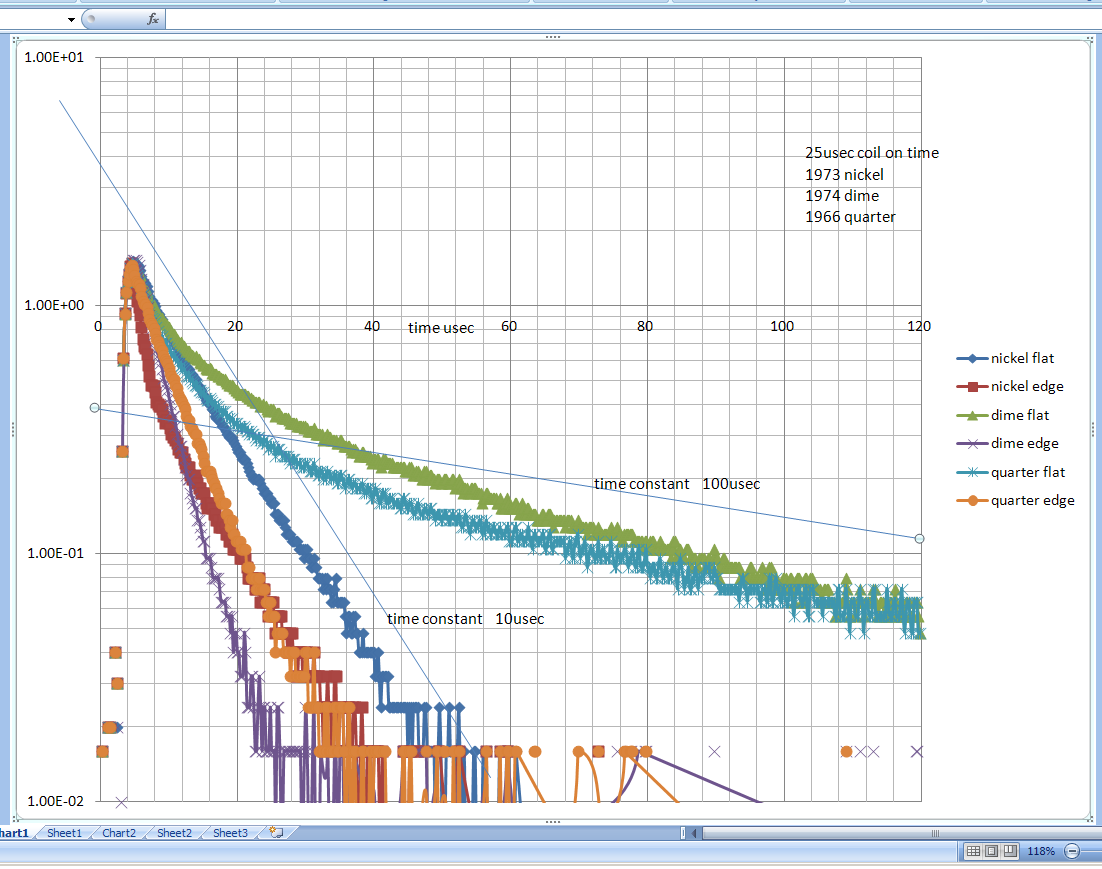

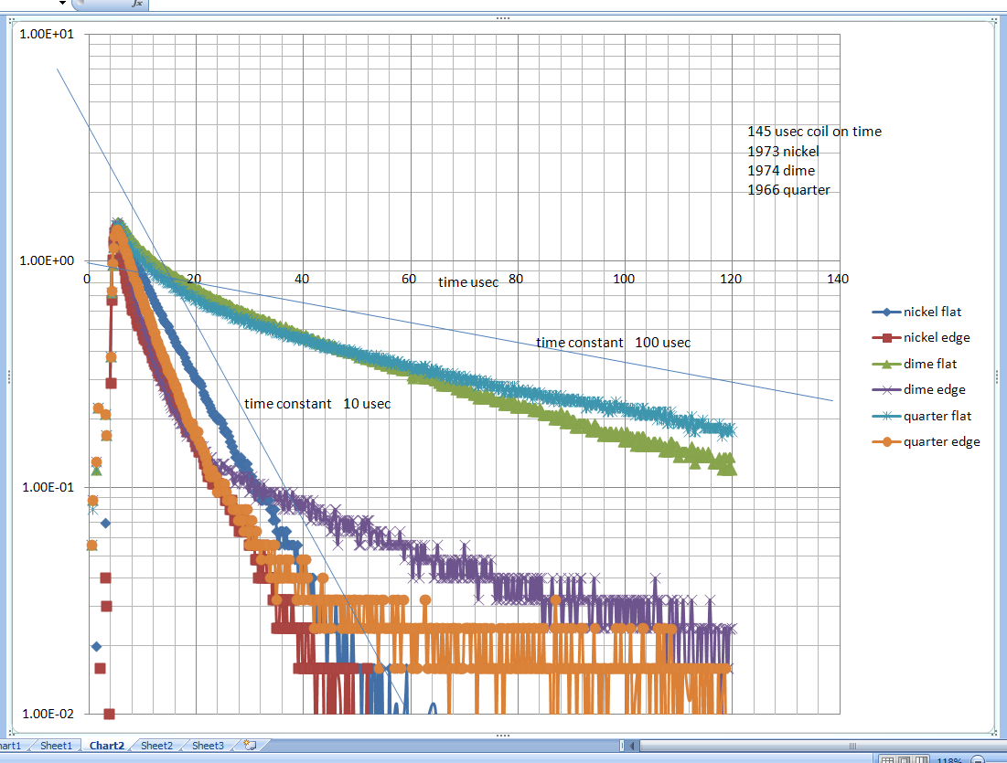

        [can you explain in more detail about time constants cause im very confused by this.] reply #11
        I charted a nickel, dime and quarter decay curve at two coil on times, 25 usec and 145 usec. The coins are plotted flat and on edge to the coil. The nickel plotted the same at the two on times. The dime and quarter plot a straighter curve and a higher time constant with the 145 usec on time. The coins on edge have a shorter time constant. The plot is amplifier out vs time (target signal recording - no target signal recording) The dime on edge shows a decay curve similar to flat at a lower amplitude, why I don't know, maybe not centered?

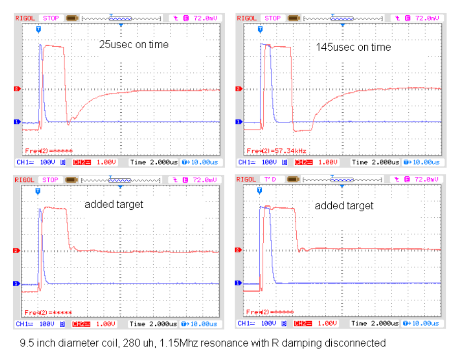

                      Including a scope picture. Coil volts and amplifier out (2 stage, gain 300) The coil is shielded with aluminum foil. Get some ringing if not shielded. Get some overshoot with a 1k damping resistor (under damped). The circuit should critical damp with a 1k resistor, it does with LT spice. Changing R damping to 500 ohms still looks under damped and takes the same time to go to zero. I've read about adding a target to balance a induction balanced coil. Can add a target to reduce the overshoot. Don't know if it matters. Maybe not the same problem as daverave but still a problem. I would be interested in seeing some scope pictures of what the no target decay should look like and how important it is to be zero volts. I've posted the overshoot problem before, sometimes thinking I've solved it. I haven't, any suggestions appreciated. The scope probe across the coil lowered the resonance a little but didn't seem to effect the problem.
                        Try the trick of connecting a 10k pot in series with a 220R resistor, and put both in parallel with a 1k2 resistor. Fit this network in place of the damping resistor, and adjust for critical damping. Then disconnect and measure the total resistance, and fit a damping resistor of the nearest preferred value.

                            With the resistor network trick it's easy to test this theory and determine how much ringing is ok.
                            In the past I've found that a small amount of ringing does increase sensitivity, but too much has the reverse effect. Setting up a PI correctly is all about compromise.
