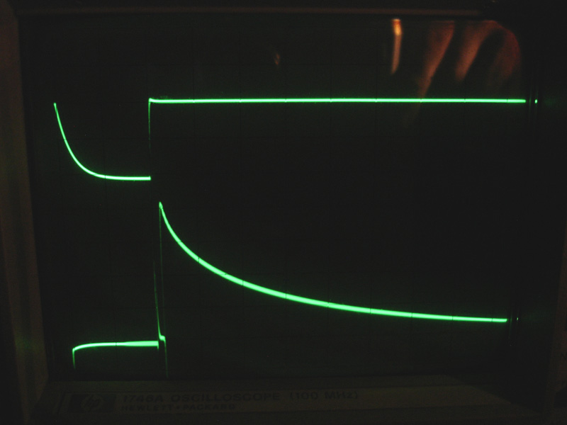

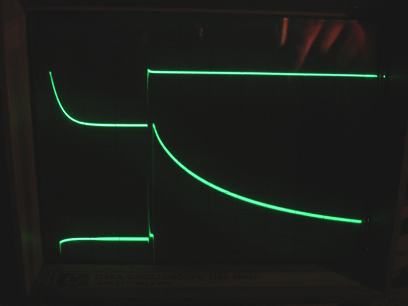

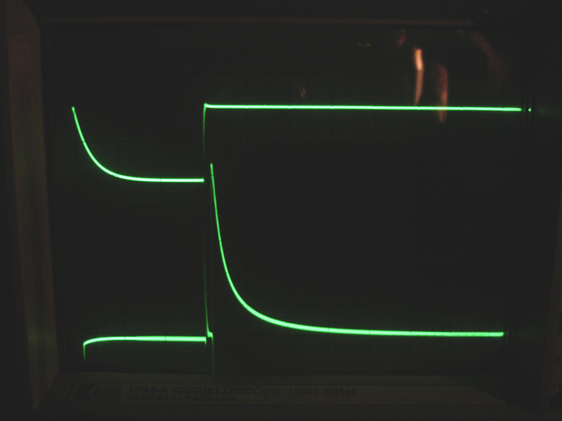

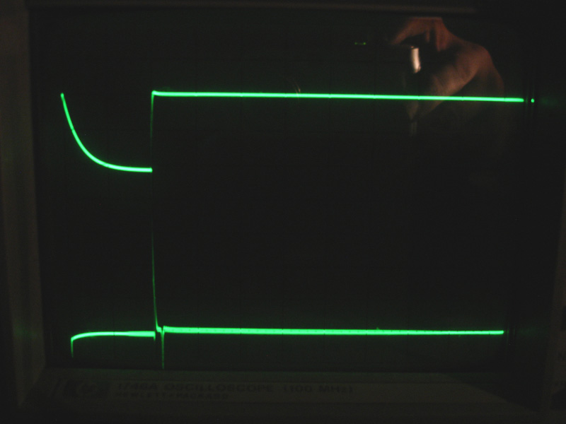

      Of course , I did it many times .... at first , I predicted this theoretically , and then tested in real experiments . It's not a problem to show it , although I use another technology in my projects ( bipolar square wave ) , I have a little experimental rig that contains a classic PI power chain and front-end . In this setup I have a NE555 pulse gen ( with manual duration and period setting ) , power switch ( BU1508AX ) , little test coil ( 420 uH , 1,6 Ohm wire , 390 Ohm parallel ) with serial resistor limiting the current , and a simple bipolar switch ( flyback pulse blanking ) to prevent oscilloscope overload by a strong hi-volt pulse just after a power switch shutdown , power supply is 24 V ....
      So I took some pictures on the real scope . First picture is an idle signal , without any target - Click image for larger version
ID:	341428 . Upper trace is the coil current , lower trace is the signal after switch ( coil flyback pulse cancelled ) , 100 uS/div . Then we can see the signal from the massive metal target with a large TC ( thick copper ashtray ) with the ON pulse duration 50 uS . On the next picture ON pulse is 100 uS , then 200 and 300 uS . So we can see how the signal magnitude depends on power pulse length - before "current saturation" and after it . And after 100 uS ( where the current is steady ) we can see what I call a "target charging"
      By the way , a similar effect can be observed on ferrous targets too , but I haven't a ferrous target with large enough TC - so to watch the effect I need more "fast" coil . I took 2 pictures on the ferrous target ( big iron hammer ) too , with the noticeable effect , where the signal height is 10% more on 300uS point than that on 150 uS ( with the same coil current ) ... but of course , if I make a coil with a less inductance and thus more rapid current rise - it must be the same pictures that I had on my copper target , but with shorter timing of course .
      • #63

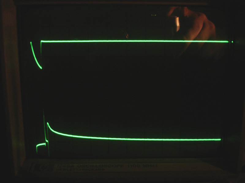

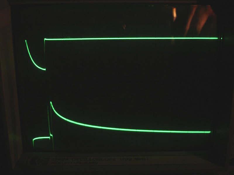

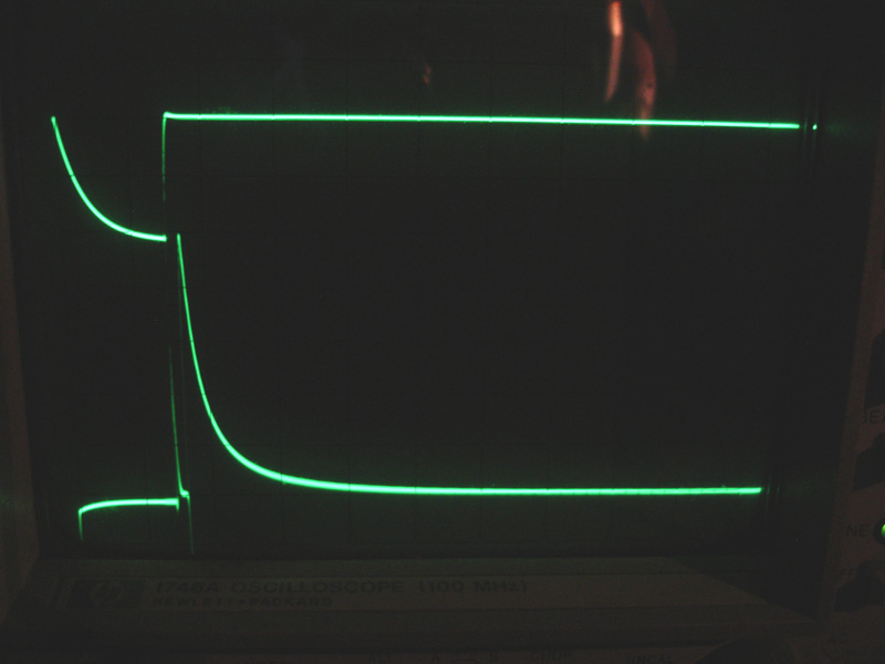

        And here are these 2 pictures of a ferrous target . As we can see - the "target charging" effect is still present here , but obviously more weak - because the target has lower TC and being "saturated" on less ON pulse duration , so when we use longer pulse ( 300 uS instead of 150 ) we can watch only 10% signal growth . I think that if I use a coil with 100 uH inductance ( and several times faster current rise ) - it might be possible to see the same drastical effect , like that in the previous case ....
            What ferrous target did you use?
            I assume it is physically much smaller than the massive copper plate?

                  You see , Qiaozhi , in reality the current stops to grow at least after 150uS point , so you cannot explain the signal growth in that way ... it's a pity that I made a photos too dark , so we cannot see the CRT scale . Tomorrow I'll make another photo with the scale illumination and higher current trace resolution ...
                  • #69
                    It really smaller in length , but heavier - it's a simple iron hammer with a wooden handle . I can make a photo of both targets ( and the coil ) - it isn't a problem .

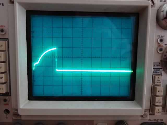

                        This looks more like a MOSFET sustaining some kind of relaxation oscillation. Could you see what happens at a MOSFET gate?
                        Hi Davor,
                        this is a picture from my MOSFET gate, 5V/Div 20uS/div.

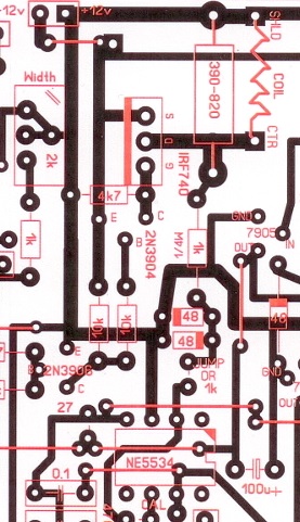

                        And a part of the schematic.

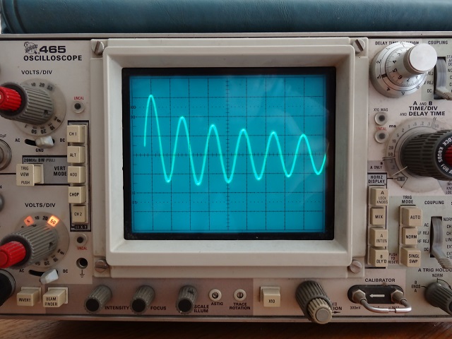

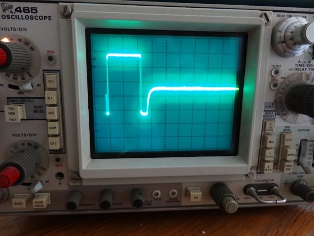

                          Dan, and all interested
                          There is another way to measure the Self Resonant Frequency (SRF) of a coil. Place a coil to measured (coil under test) on top of a fully functioning PI machine's coil. Attach the scope to the leads of the coil under test. Turn on the PI machine and through inductance the coil under test will be stimulated by the square wave pulse of the TX pulse. In the coil under test will be a ringing that tapers off. Measure the space between the peaks of the two highest rining pulses. That distance represents the time of the resonant frequency unloaded by the MOSFET COSS and any other circuit capacitance. Make sure that there is no damping resistor in the coil as the SRF ringing will not be easily seen.
                          This test will reveal the result of the PI coil under test inductance in parallel with:
                          1. The coil turn-to-turn capacitance
                          2. Capacitance based onthe Dielectric constant of the wire insulation and space between windings
                          3. Capacitance based on the dielectric constant of the spacer material and thickness of the space between the coil wire bundle and the shield
                          4. Capacitance of the length of coax wire between the coil and the PI control box.
                          5. Scope probe capacitance
                          Joseph Rogowski
                          Hello Joseph!
                          Thanks for this great tip. I have meassured my coil now with your instruction.
                          Now i get 1.6 uS~625 kHz.
                          Scope-Settings are 50V/Div and 1uS/Div.
                          I will test some other coil´s to see differences with shield and without.

                            OK, so gate is clean, and those are only coil oscillations.

                              For calculation of the dumping resistor Dan´s (Baum7154) variant is correct. Attached is a picture with the calculated 324 Ohm dumping resistor.
