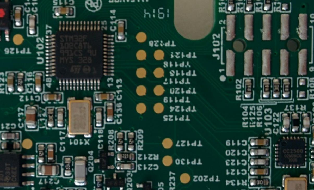

                    Sample images of the audio rx module show a STM32F102C8T6 working in conjunction with a T.I CC2500 transceiver ic.
                          greylourie, where do you see these sample images ? I do not see them in the "internal images" link at the FCC site https://apps.fcc.gov/oetcf/eas/repor...cc_id=Z4C-7000
                            On the third page of the "Internal Photos" pdf.
