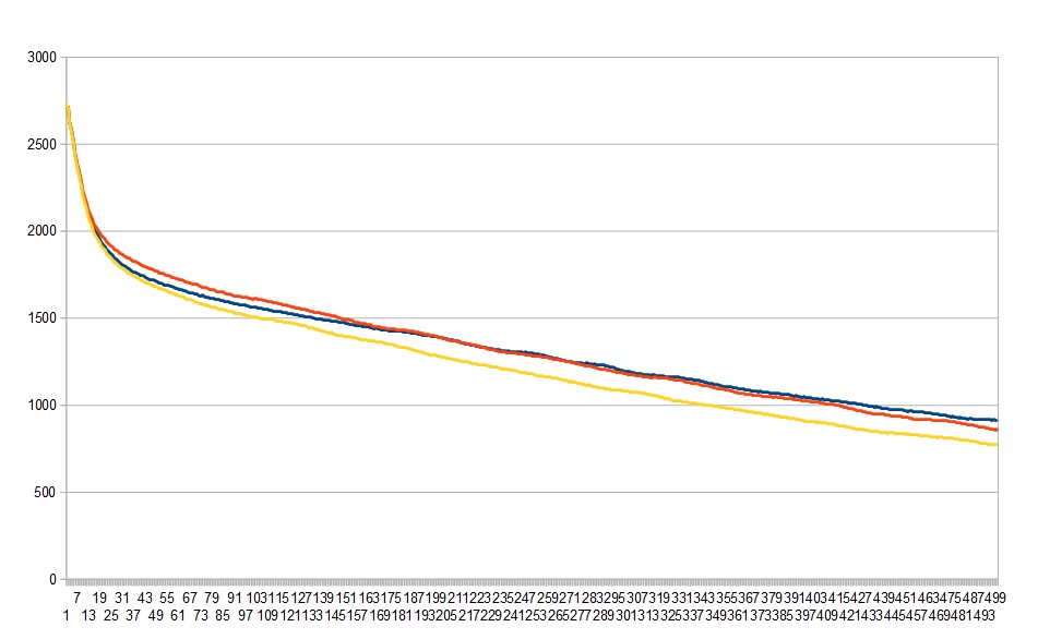

          STM32 the is the way to go. STM32F3 or F4 can sample 12 bits at 20nS
          You can setup a nice ADC/DMA stright to your buffer then process it. It is absolutely amazing what that chip can do. Plenty of memory, 72MHz, DAC for sound or to drive coil, etc....
          Here is a sample plot from the simple PI detector. Signal sampled after the first and only opamp (used to shift and expand signal to the ACD range)
          plots of "base line - no target", "steel" and "gold".
          After you have the profile then slow/fast integrators are done in software to detect target.
          I fried my STM32F3 (12V charged cap plugged into 3.3V ooops); Just got STM32F4 nucleo but did not have time to play yet, the spec are spectacular .
