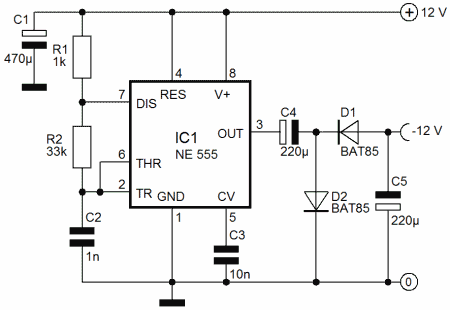

                By th way, the 555 can also be configured as a negative voltage generator instead of the ICL7660 or the LT1054.

                            Another Option: The ICL7662 is good up to 20 Volts.
