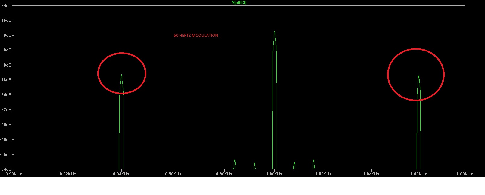

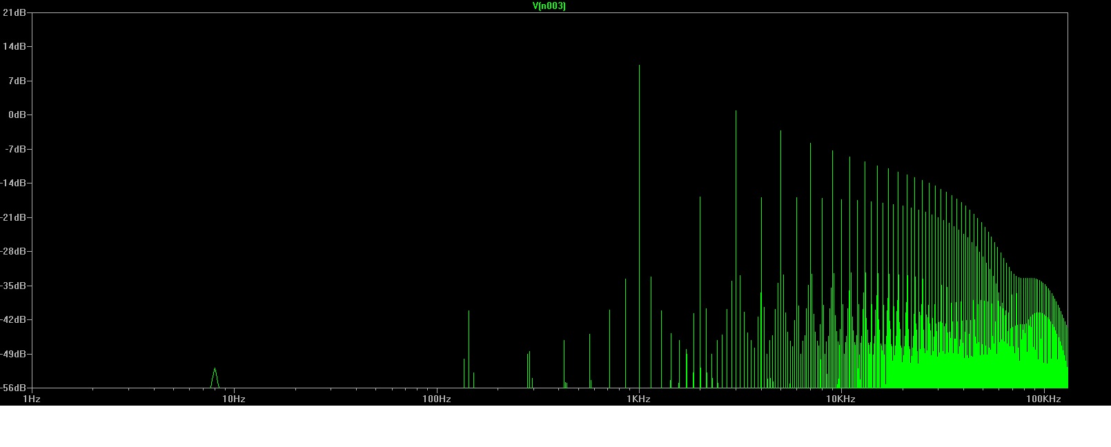

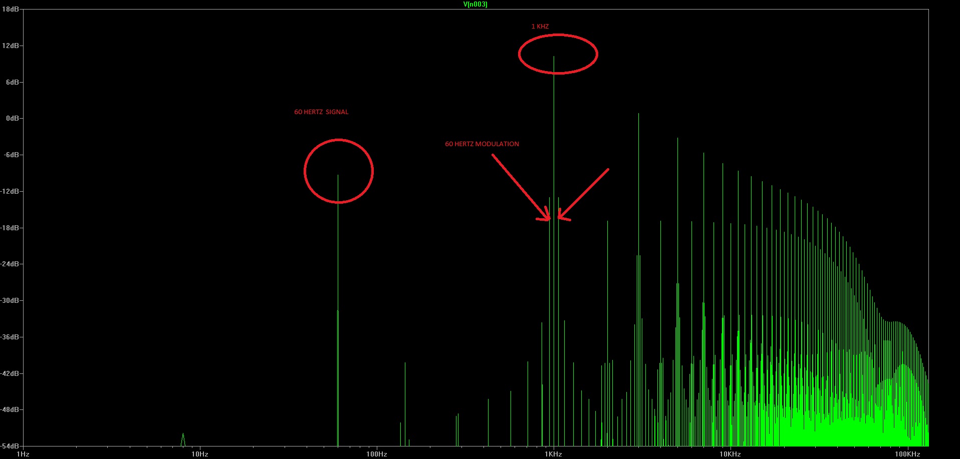

    The impact of EMI including very low frequencies down to DC should not be underestimated in a PI. The front end of a PI is a natural modulator and signal frequencies in the the frontend are mixed or undergo CONVOLUTION. The pictures below illustrate this ... the first pic is the spectrum of a signal from a PI operating at 1kHz with substantially no noise. The next two pics show the effect of a 60 Hertz signal on the PI signal. You should be able to see that the 60 Hertz is modulated onto the spectral components of the PI signal. The thing about CONVOLUTED signals is that they cannot be removed with a filter. Even though I have used a 60 Hertz signal to illustrate in practice ALL signals ( ie noise / EMI etc etc) from DC to up will be convoluted / modulated onto the PI signal and demodulated with your "wanted" signal.

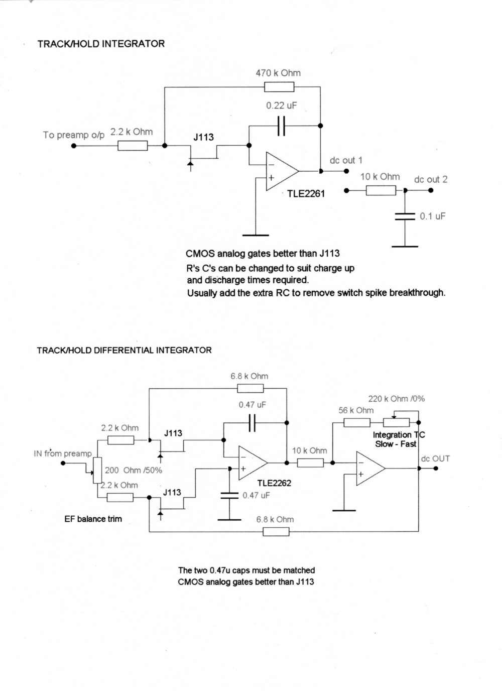

                    My prefered analogue integrator
                    This is an arrangement that works well. It has the benefit that the capacitors 'hold' until the next sample i.e. there is no leak down through a parallel resistor.
                    In the differential version the loop gain controls the time constant, so you can have an external pot to vary the 'response speed' or 'noise averaging'.

                    Eric.
