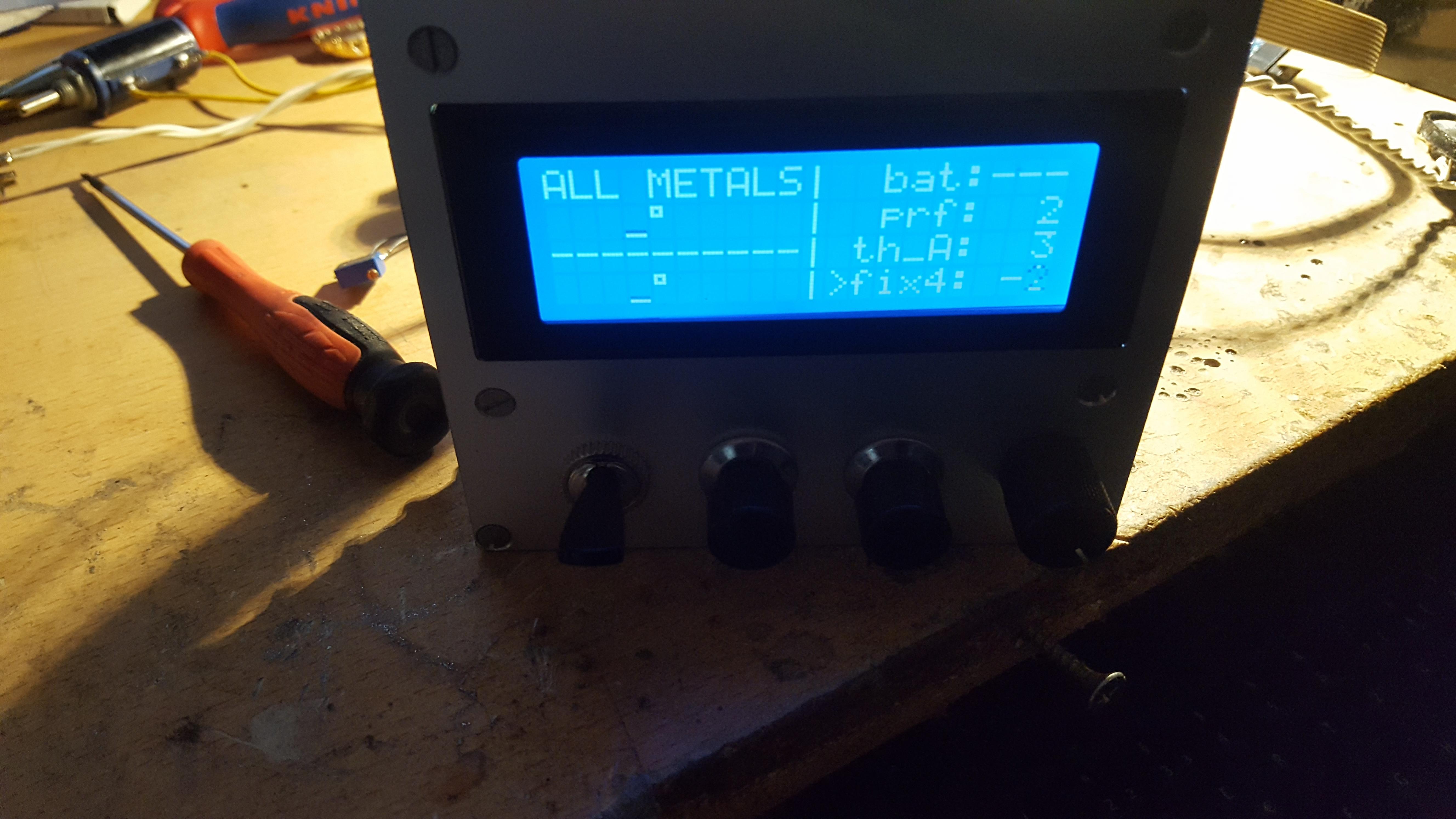

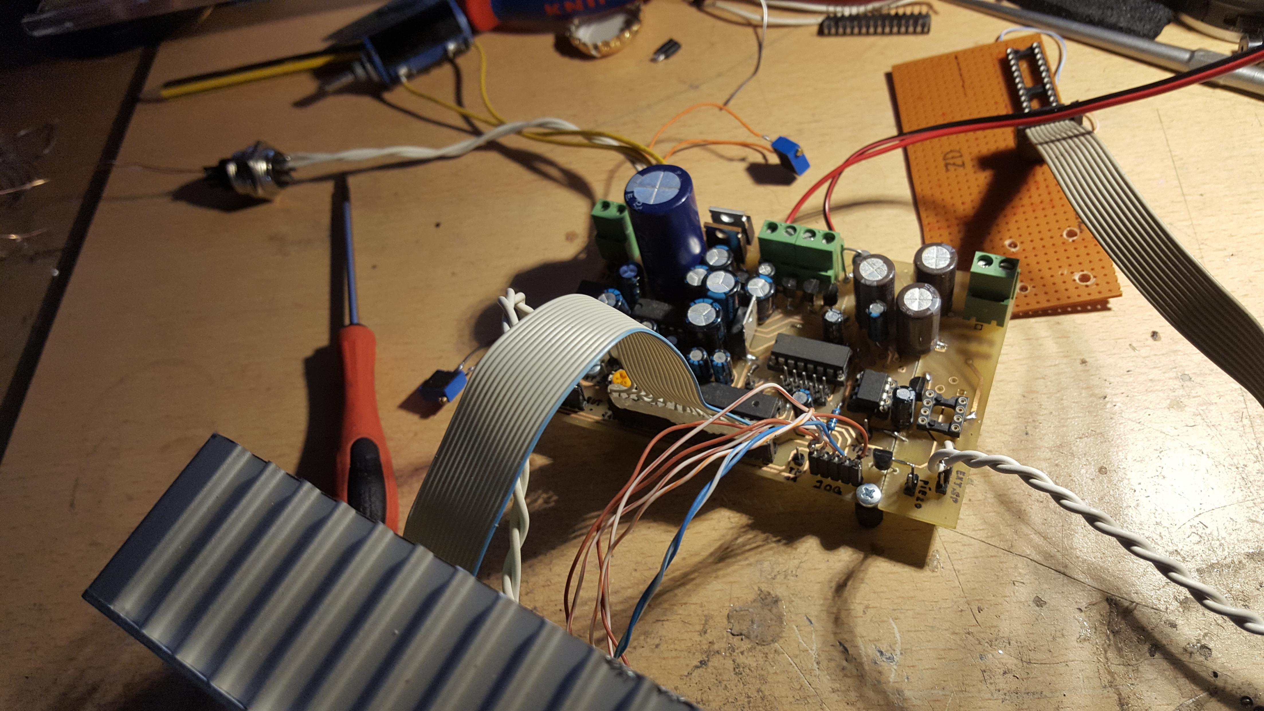

          • #50
            OK, i have tested the file from Orbit post #10 and it works. The hex from mikipn post #45 also works. They are both demo firmwares. This means that if i switch into disc mode the detector stays in all metal mode because of the limitation. Another important fact:
            If i try to change parameters in the settings, the detector resets. The only alterable parameter without a following reset is fix/mov. But setting the parameters would be mandatory necessary to adjust the detection level (smp0) and many other. The value of this level is about 220 with my home made coil in demo mode. With my full hex and with properly set smp0 parameter the detection level is about 600 and has a much better reach distance.
