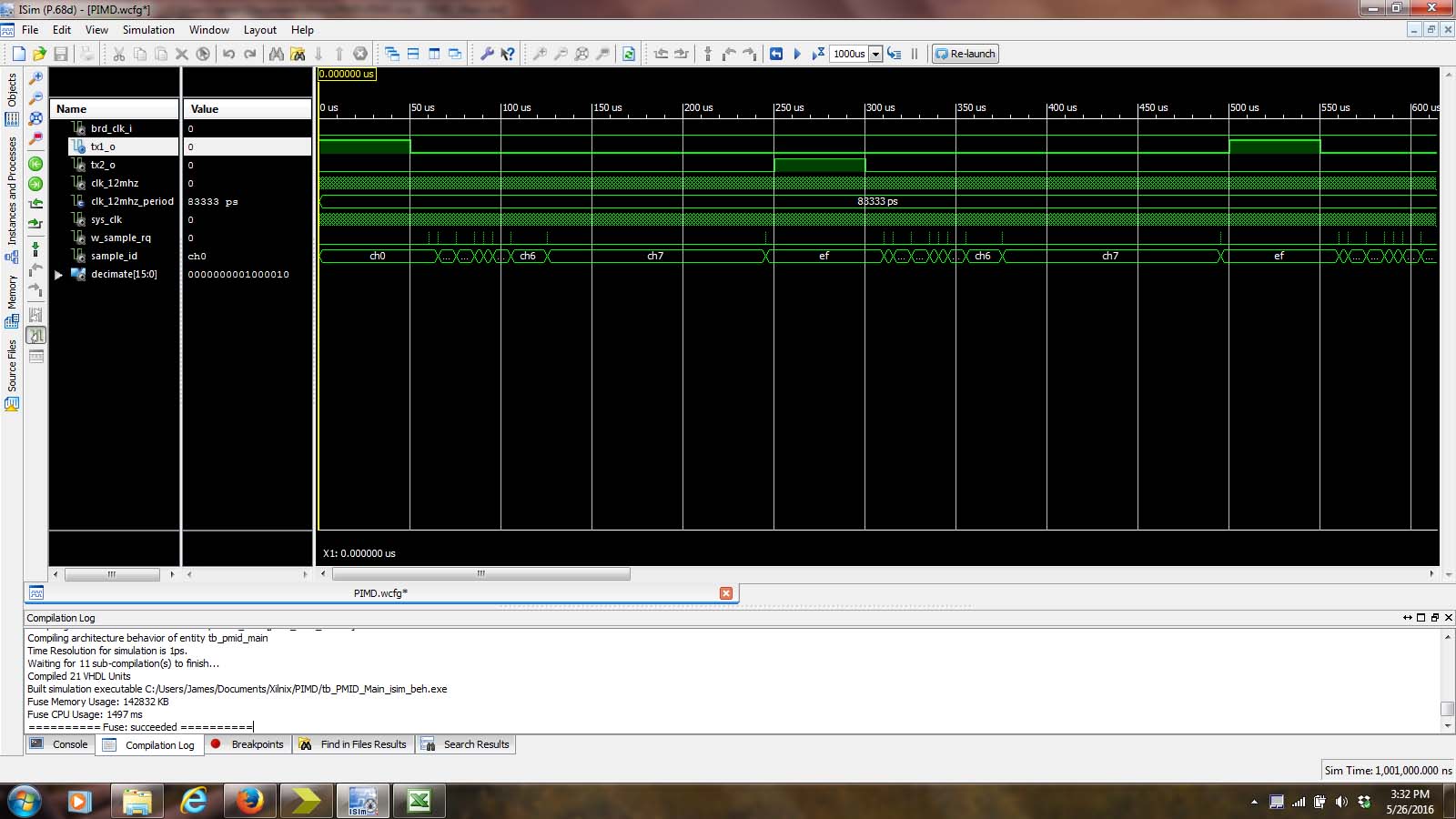

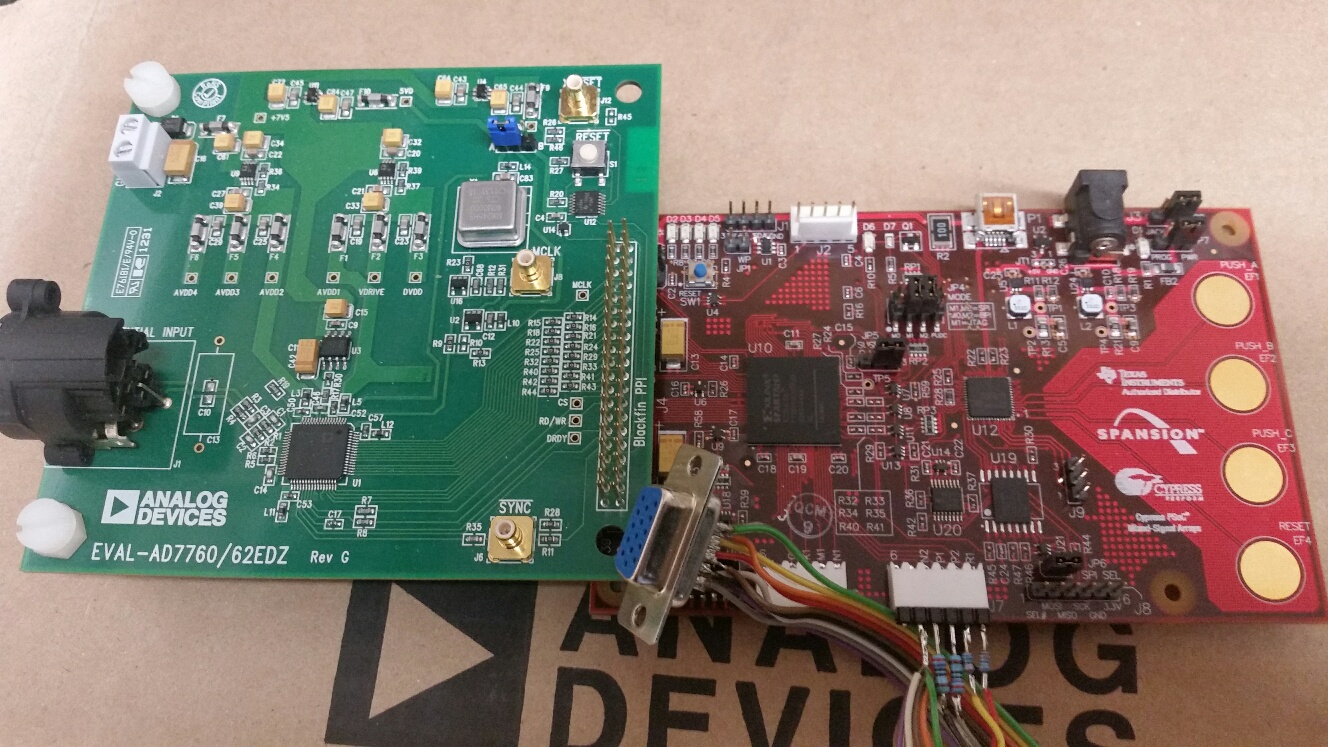

              Well, my FPGA board and StickIt MB arrived via UPS today. Meanwhile, I have been coding up the VHDL to implement the Metal Detector. I have coded the main timing functions for the TX pulses (TX1 and TX2) and RX sample requests. The current VHDL is shown in PIMD_Main_vhdl.pdf. I have tried to add enough comments the VHDL to add clarity for others to follow.
              The code synthesizes and the run of the code on the simulator testbench results are shown in Click image for larger version
              I have not yet started the code for the UI, RX filtering, GND/minerilization filtering, threshold detection, CFAR, or detector output. Next I have to generate the FPGA programming bitstream for the current functionality to load into the FPGA. That will let me test out the TX and RX sample requests on the real hardware ( http://www.geotech1.com/forums/showt...RX-FE-platform ).
              The plan is to build a UI that responds with LEDs and tones to allow the user to select the parameters to be changed with a mode switch, change the parameters with "+" and "-" switches, go back to normal operation with an End/PinPoint switch. The parameters that can be changed are PRT/PRF (within bounds), filter cutoff (2.5, 5, 7.5, 10,15, 20, 30, 40Hz), RX sample timing (within bounds), threshold, and audio volume to name a few. The UI will be last to implement.
                One determination I have made is that the Spartan 6 LX9 would be more than sufficient for this project. The LX25 is super overkill! I have developed the VHDL for over 50% of the functionality and have used 1,669 out of 30,064 FLIP FLOPS (5 %), 5 out of 52 RAM Blocks (9%), 9 out of 38 DSP48 slices (23%) of the LX25. For the LX9 that would translate to 15% for FLIP FLOPS, 16% for RAM Blocks, and 56% for DSP48 slices. Of greatest concern, when I started this project was DSP 48 multiplier slices which are used extensively by the DSP filters. I have implemented all 3 filters to be used by this application and each filter used 3 DSP48 slices. I cannot see the remaining functionality to be developed requiring 7 DSP 48/multiplier slices.
                To date, the following functionality has been developed:
                1. The cclock generator process which generates the 100 MHz system clock from the 12 MHz board clock
                2. MD timing process, which generates the MD TX pulses and sample requests to the ADC.
                3. The ADC driver process which takes the sample requests, starts the ADC conversion, and shifts in the 18 bit converted ADC data for each of the 8 data samples and the EF sample.
                4. ADC Service process, which takes the ADC samples (8 data samples plus 1 EF sample. It pre-stages these samples then adjusts ou the EF sample from the data samples before sending the data samples to the Input CIC filter and the GB CIC filter.
                5. An 9 channel Input CIC filter which integrates the samples, filters them with an intermediate stop band of 3 Hz - 50 Hz with decimation down to 15 Hz -250 Hz depending on UI selection, for the final FIR filter.
                6. An 8 channel GB CIC filter which filters the GB/mineralization path to 0.1 Hz to 0.005 Hz, depending on the UI selection.
                7. The GB CIC Filter service process, which takes the output of the GB CIC filter for each sample of the 8 sample channels and stores them in ram.
                8. The Input CIC Filter service, process which takes the output from the 8 data sample channels, adjusts out the corresponding GB CIC Filter output, and send the result to the Final FIR filter.
                9. The 8 channel Final FIR filter, which filters the adjusted 15 Hz – 250 Hz decimated output of Input CIC Filter and filters to a final bandpass of 2.5 Hz – 40 Hz depending on the decimation rate of the Input CIC Filter that was selected by the UI.
                Each of the above processes run concurrently at the system clock speed of 100 MHz.
                Left to develop are the back-end processes to compare the collected data, determine threshold detection and Constant False Alarm Rate (CFAR), and determine appropriate output response. Also the processes that constitute the UI that will control the parameters of the MD timing and digital filters.

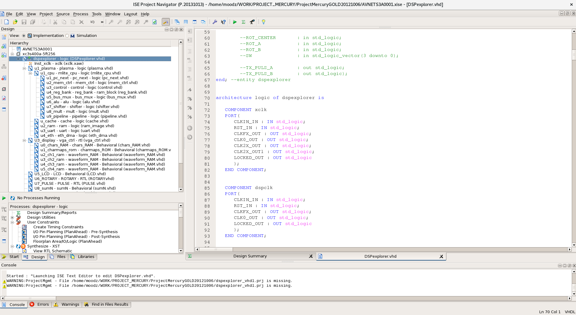

                                I went down the FPGA road 3 years ago ... It will either inspire or intimidate you LOL.
Name:	Screenshot from 2016-08-10 15-05-29.png
                                200 Mhz FPGA with 24 bit ADC sampling @ 2.5 Mhz or 16 bit @ 40 Mhz.
                                50 Mhz MIPS type 32 bit CPU
                                4 channel VGA Waveform display.
                                Serial console
                                Rotary switch encoder.
                                Pulse generators
                                Sound synthesiser
                                LCD driver.
                                etc etc.
                                ... in the end I went back to $5 Pic32 chip ... it does a better job.
