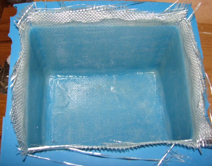

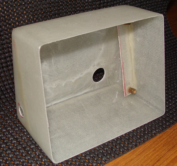

        • If your lucky enough to have a 3-D printer you could make one.
          I will probably end up up making one using epoxy and fiberglass cloth. Like I did once before.
          Think I have something around here I can use as a mold.

          • Originally posted by SVEN1 View Post
            [ATTACH]37757[/ATTACH]
            [ATTACH]37758[/ATTACH]
            Interesting, same thing i tried with car bumper's, but in my case it was polyester resin, not epoxy.

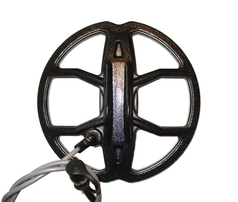

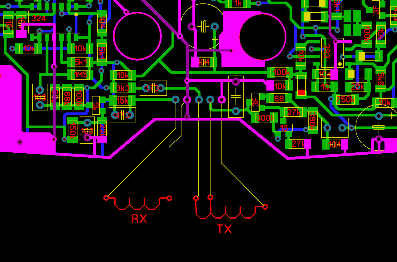

                  Tell me, what kind of probe are you using? The size, number of turns and wire diameter?
                  • Originally posted by Artyom View Post
                    It is the same coil as on video i posted earlier on this topic.
                    I tried to make closest copy of original Golden Mask coil:
                    TX= ~0.7mH, 2.9 ohms + one more turn for 5th pin on connector, wire 0.45mm
                    RX= ~6mH, 24.5 ohms, wire 0.25mm
                    Don't exactly remember number of turns, usually i make more turns and than by measuring inductance i lower the number of turns until i get closest to desired inductance.
                    That's why i never try to remember exact number of turns.
                    I guess the closest you can get is to see this my Corel file.
                    I scanned part of original coil (since my scanner is A4) best as it could fit, to get as closest to original dimensions and shape.
                    I am using Corel 9 for long period, kinda used much on it. So you'll have to have Corel 9 to be able to open this file.

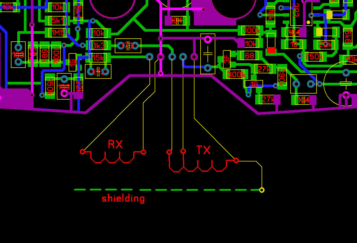

                      • why not connected to this contact. draw your wiring diagram which connect the shielding of the sensor?

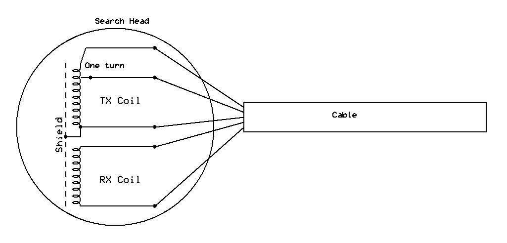

                          • You showed factory sensor connection with 5-pin connector. If the sensor to make and use the connector on the 4th contact, whether a connection is possible by connecting the collector Q7 and C37?
                            • If im right, shield is connected after feedback turn on TX...
                                Yes, correct!
