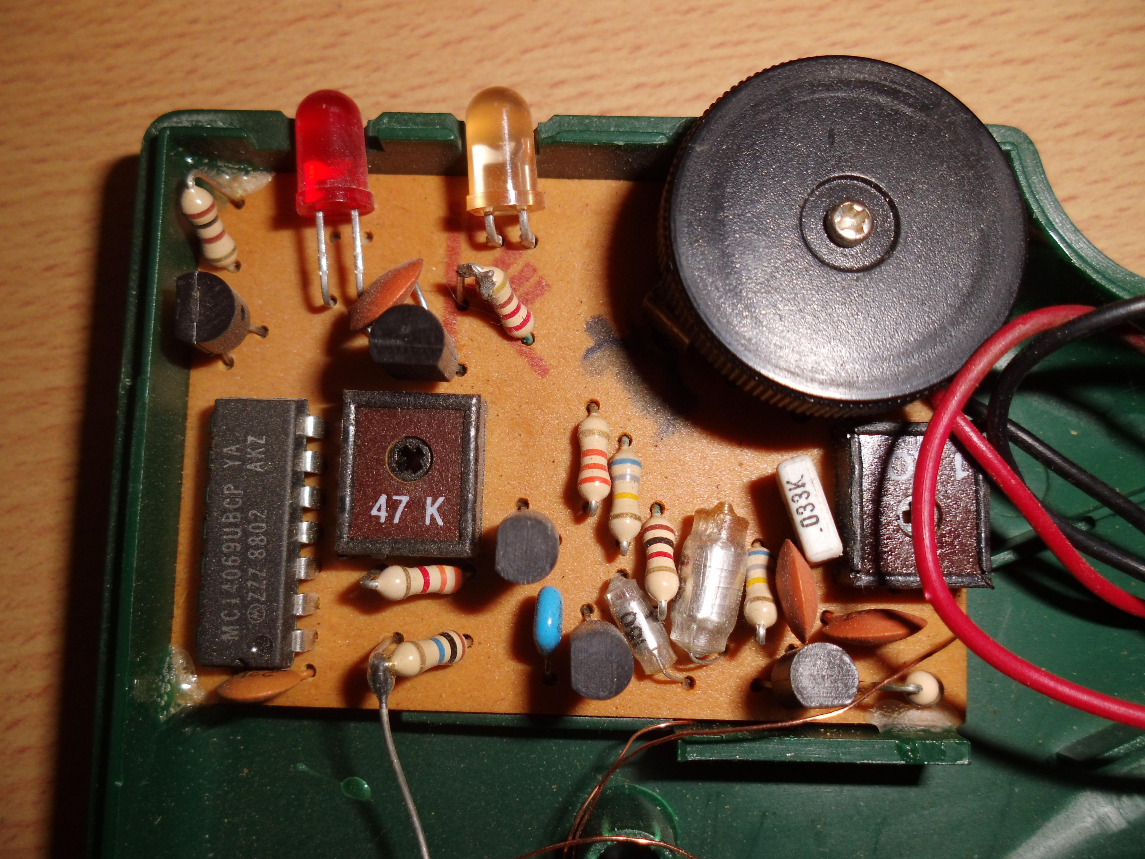

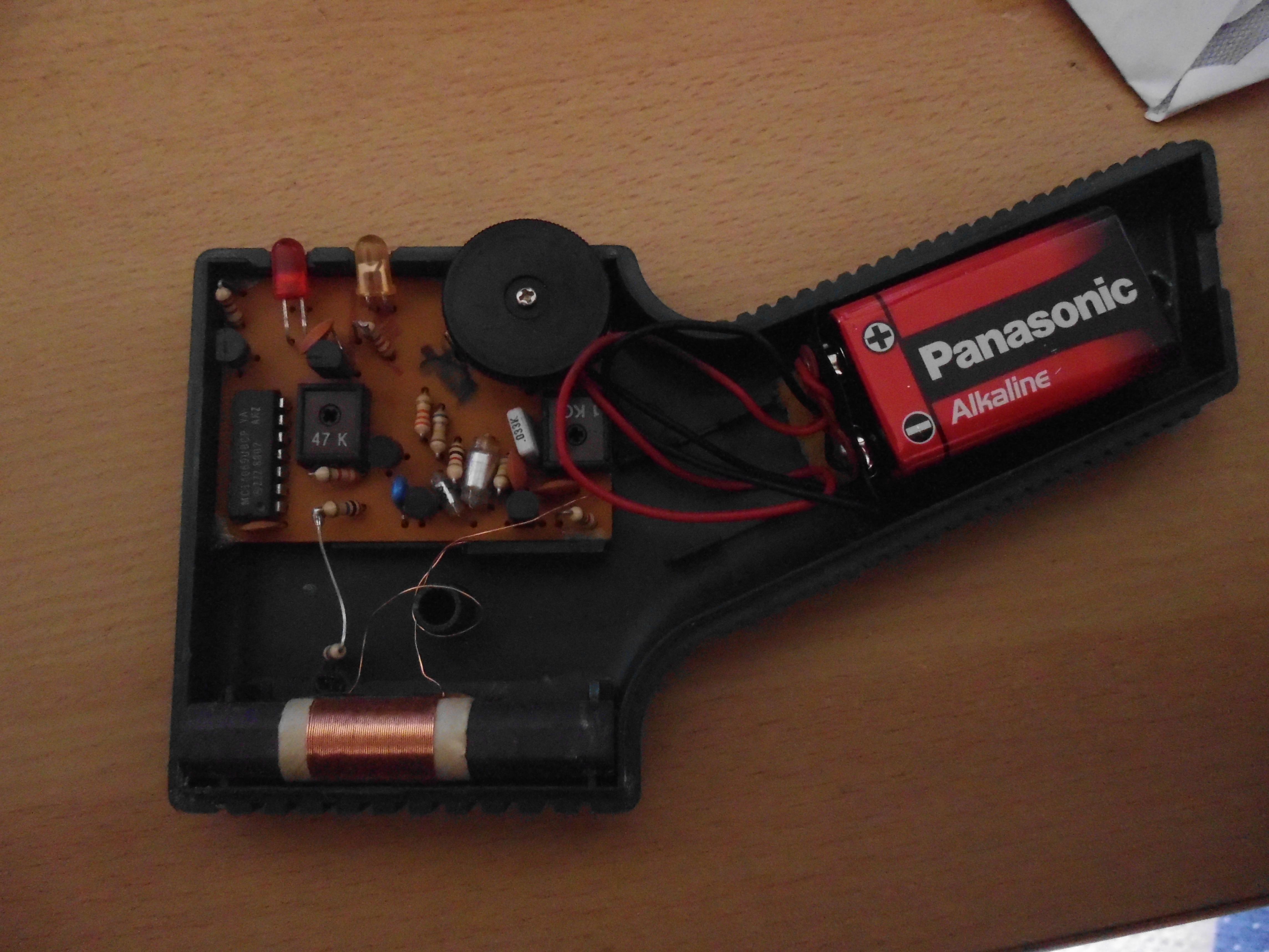

          This is my tool, i want to use the housing from it. Do you think i can use this potentiometer with switch to turn it on and adjust it?
          Do you think your circuit is better than this? The left side with the ic is just for electricity detection.
          I think i can use this ferrite rod or maybe the whole coil.
            Why mess that up ? Keep it intact. Circuit calls for a 10K pot and you can find them about any place. See that one is using a 4069. Ferrite can be had from old AM radio's .
              Because i want to use this enclosure, i will keep the board intact or maybe all.
              I have exactly the same tool and this has a depht of about 10cm for a 1 euro coin.
              This has exactly the same circuit but not the electricity thing and only 2 cm for a euro.
              I cannot see a 4069 in my tool.
              By the way, i soldered the parts at a board but not connected everything, i have used a 4093 ic.
              I wasnt sure about the connection of the potentiometer because it has 3 connectors.
              One belongs to the 1k resistor and one to the 4,7nf capacitor but where needs to be the third?
              Im new to electronics, i only have built one Tesoro Golden Sabre Light and one BFO.
                It's the only IC on the board. MC14069UB.. https://www.google.com/search?biw=11...psgZDH2Hq1spM:
                  Yes, i just saw it , i have thought its an other type because of so much letters and numbers.
                  But a 4093 is not the same, or is it?
                  You said it works too. Or was it a 4096?
                    No Different Animals. http://www.edaboard.com/attachments/...al_ic_list.pdf
