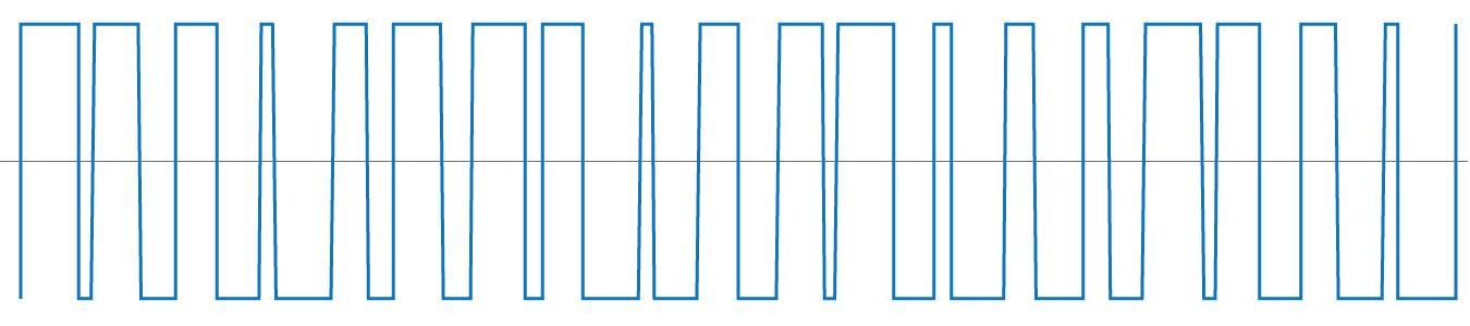

                          I'm not expecting the 'multi-IQ' waveform 'scope traces' to be super-realistic, but what freqs do you think are present in that square-wave? It looks like a 4:1 ratio to me, ie. 5kHz / 20kHz.

                              Hard to tell exactly, but it looks like 3 frequencies. The overall waveform spans the fundamental, and there is definitely a 3rd harmonic term.

                                I've had a tinker with the waveform image, I think I've pieced together a full cycle of the signal, attached:
                                It looks like there's a 5:1 ratio. There's a component that appears to have 3 cycles, for 15 cycles of the highest freq component. What else?
