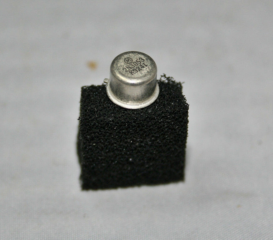

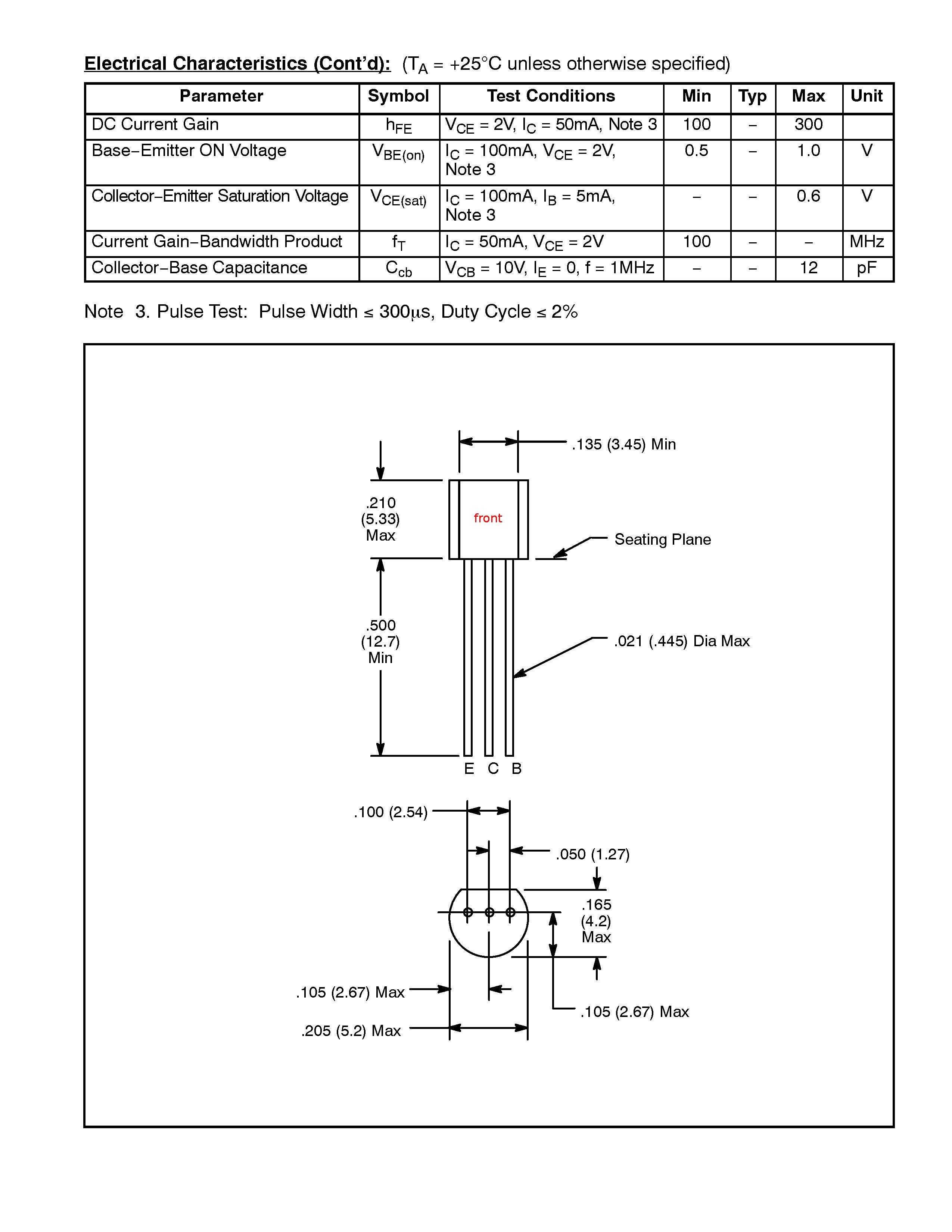

  • to92 is just the package type, this number is not on transistor. Look for these types, if you find one, post the number on it. I will then tell you if you have a winner.
    • i know there is loads of the first image one's. (index) with different numbers on. i have two old CB Radio boards that have a lot of then on the boards. i think they mainly start with CN on them.
      • Perfect! One of those should work. just record the numbers on a few of them and post. I''ll check to see which one will work.

          • C2076. Remove this one. Post a pic of the one you chose, then i will show you how to orient legs to put on new board. In fact i will show you now. refer to pic

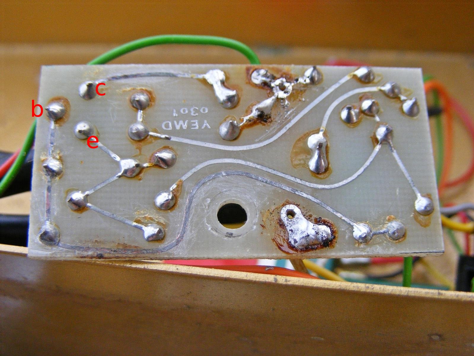

                              • Looking at pic two on post #110 I think your PCB tracks, may be broken /corroded and measure Hi resistance.
                                I would get some methylated spirit and a small paint brass and give them a good clean. I would do that to all PCB’s.
                                Then I will just measure the resistance of the tracks make sure that is NOT hi or broken
                                I think will make a difference.
                                Give it a try.
