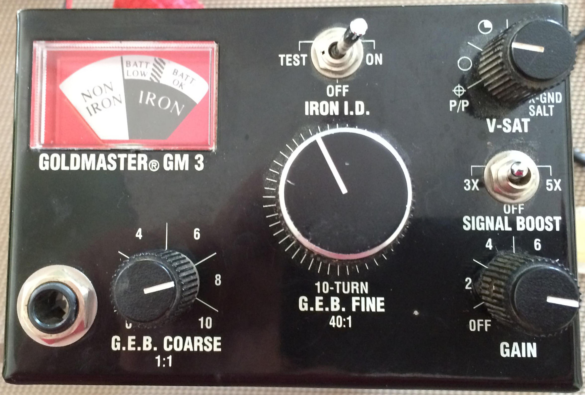

                • #68
                  what is your interest in 18KHZ ?
                  more productive way is to buy faulty GMT3, to give the board to me for desolder.
                  then i do PCB and everybody gets - PCB, schematic, full part list and good project of 48kHz gold detector.
                  • #69
                    • #70
                      Gm3 50khz very good machine. Fisher gold bug 2 even better.
                      • #71
