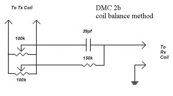

        I do have a drawing of the Search Loop material, and the PCB that went into the actual coil, so am posting those in the forum right now.
        Melbeta

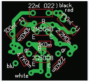

        And the photo of the Pre-Amp PCB that went inside the coil of the detector...
Name:	2N5088 Pre-amplifer Coil.jpg

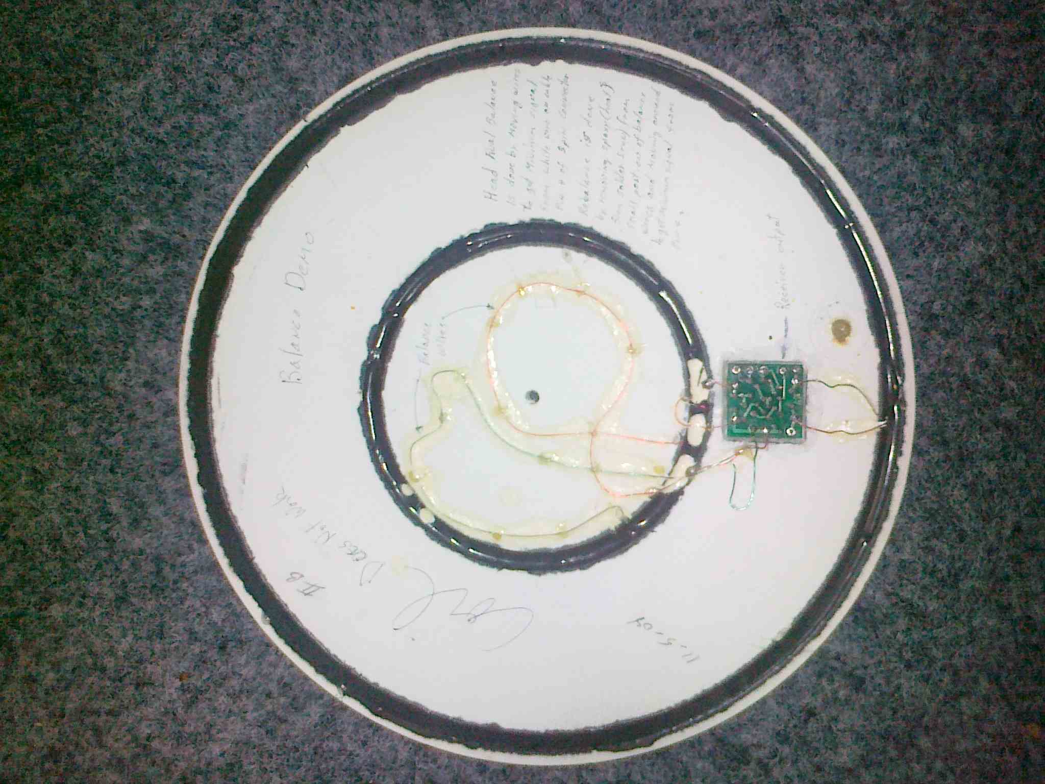

          And I do have a bit more info on what is inside the coil itself from postings that another person in the past made. That person took the coil apart and tried to duplicate it. I will have to search for it and see what I have on the inside of the coil.

          Found the photo of the inside of the Nautilus coil that used the Pre-Amp PCB. Attached below...
Name:	inside coil lo res_001.jpg

              Lots of info people, thanks.I am drawing a schematic of the 2b, reverse from layout that I traced out from original pcb. It's hard work, will take some time to gather all parts onto single page.

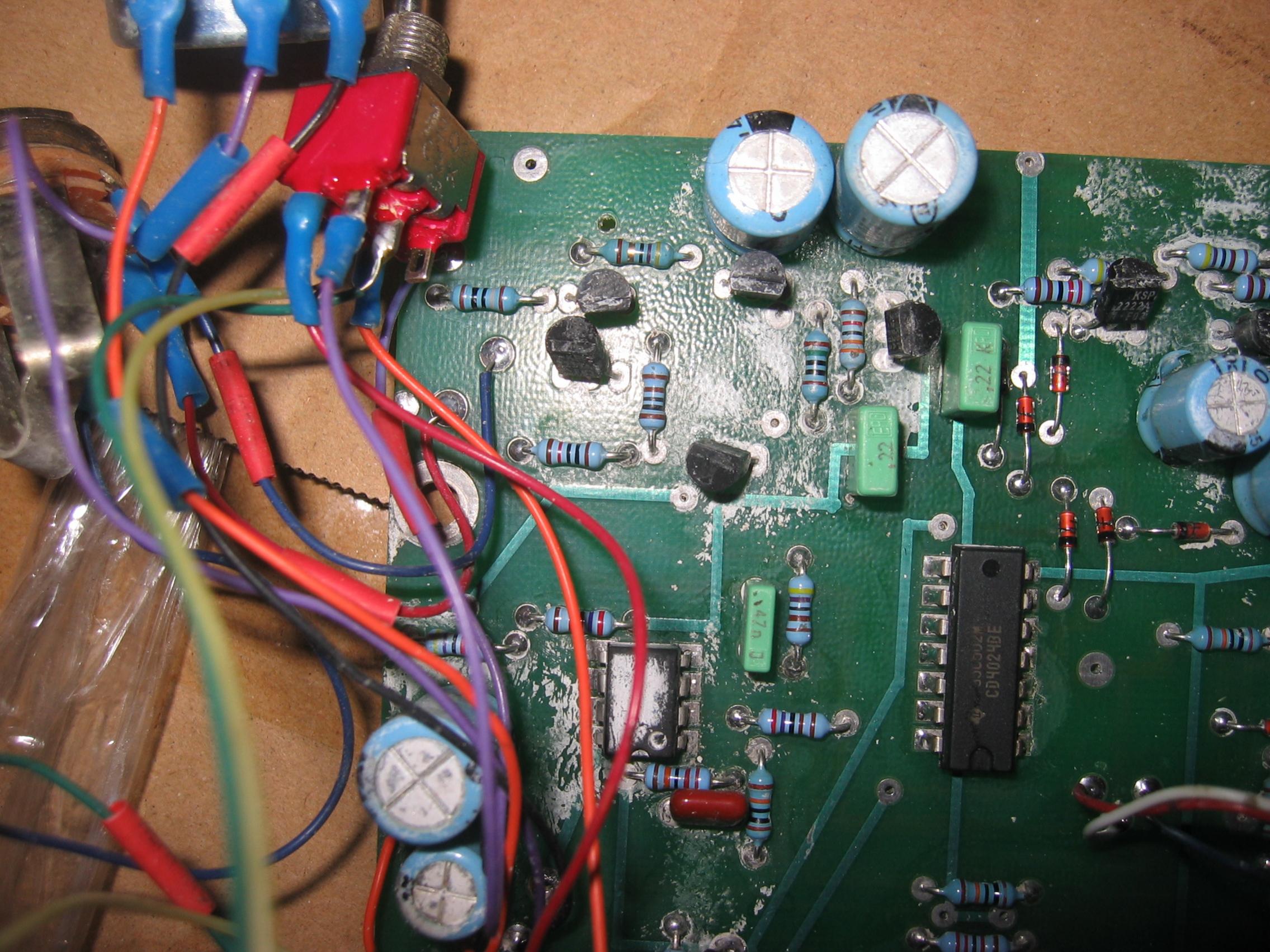

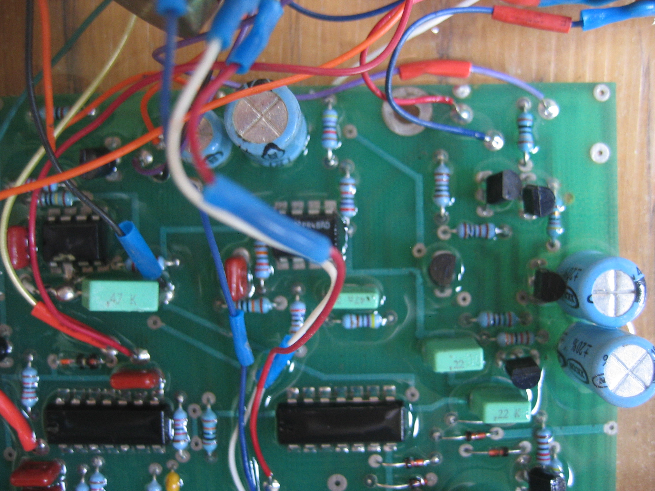

              I have everything figured out except for the motion discrim/ ground balance discrim dpdt switch wiring. I can't make heads or tails of it. On photos I have, there is wire going from one of the audio output to this switch, then through the switch and onto a non inverting input of one lm358 via a resistor. To me this makes no sense whatsoever. I think whoever was tinkering with that device got it all wrong!
                As you can see from pics, the purple wire at top of switch goes to top right hand corner of pcb with is one of the headphone outputs. Then when switch is thrown, it connects to opamp input, crazy wiring. I think this is botch job.
                The second speaker output goes to headphone jack, which is as it should be.
                Maybe I missed something.
                  Now I know what I missed, it's the switch marked SLB on/off. Somehow this switch is tied up with audio.
                  I think I may give up, simply don't have enough info to do complete job of it.
                    Mission accomplished! All details of this device have been completed. All is well. Will be posting file with COMPLETE details soon, including component parts list, pcb layout, schematic, wiring diagrams for ALL controls etc.

                              Members, thanks for pic of coil, I did not have this one. Can you make out what is written on inside of coil? Also, thanks for posting null circuit, it matches the one I reversed draw from pics.
