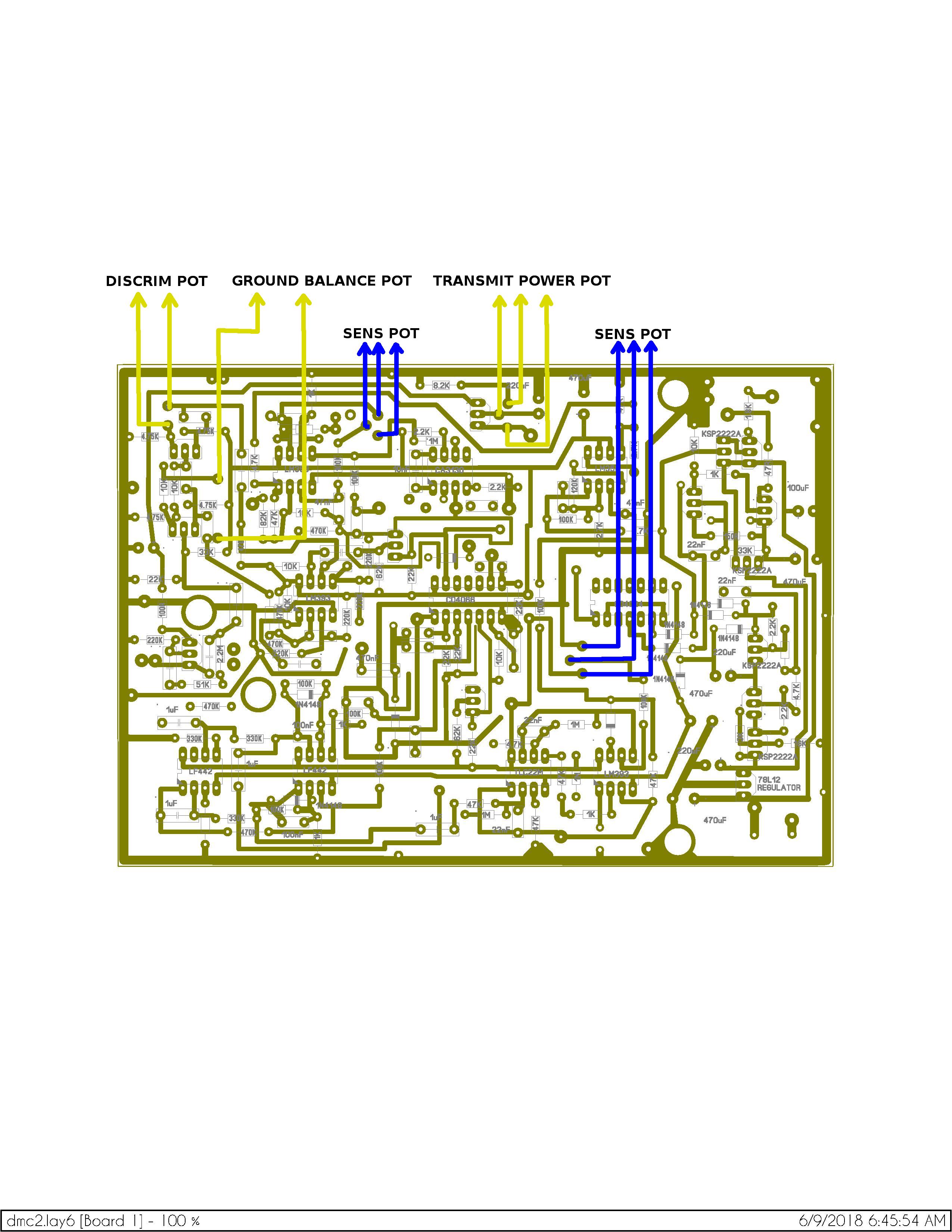

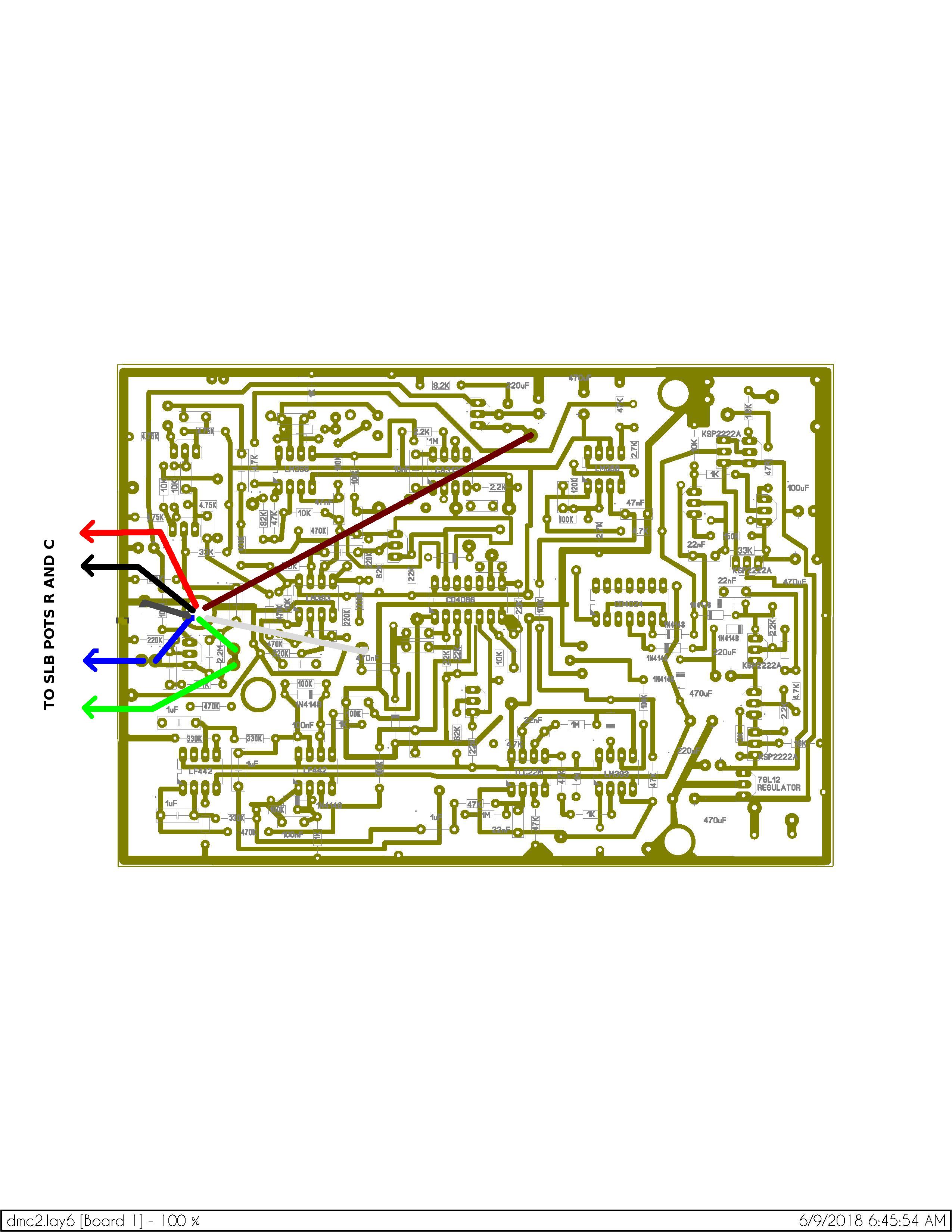

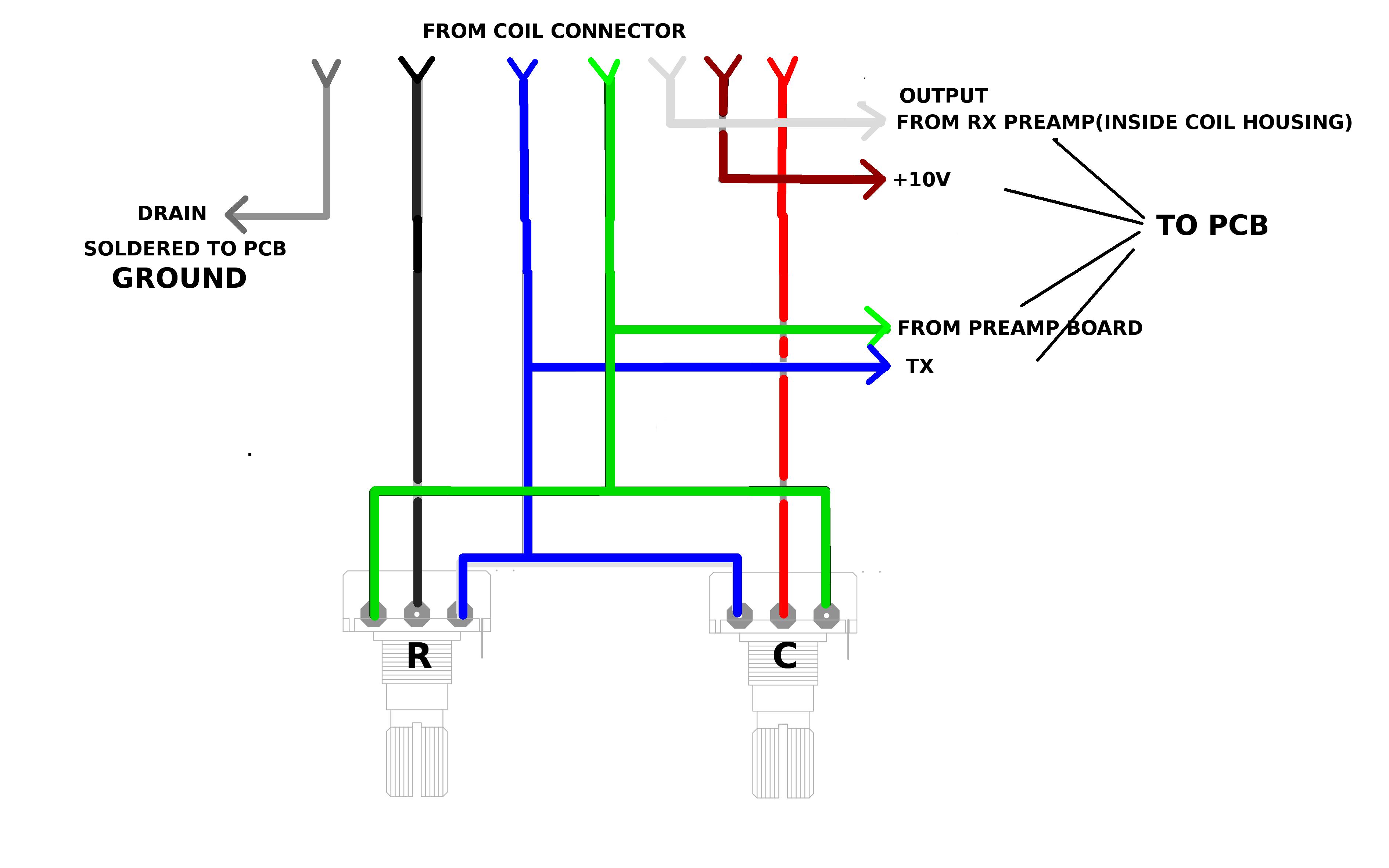

    Here is wiring for the SLB pots. Ive even worked out where the wires connect on pcb.The coil connector is 8 pin connector. Again, its all coming together slowly but surely.
      Coil wire to pcb placement
        Pots to pcb wire placement

          I would be interested if it was re-designed with a conventional coil, with the pre-amp on the main board, and simple power supply / voltages.
          It seems that the main 'special' feature of the machine is the way it processes the coil signal, not the unorthodox coil, with its internal pre-amp.
            Yes, the Rx preamp is in coil housing. I think there are certain advantages to this way. Also a properly balanced double D coil should work well. There is nothing special about power supply. Just a 12 volt regulator and circuit like TGSL to generate negative voltage. The transmit power pot can be excluded. There are many possibilities for mods but first I must construct original. This device has excellent reputation for deepseeker.

              The reason for the pre-amp being located in coil was to reduce noise while using cheap cable. The Minelab Soverign and X-terra are examples. The Soverign used unshielded control cable when it first came out, the x-terra used cat5 twisted pairs. Most manufactures use custom cable now with dual coaxial and control wires if needed. With proper cable you could put the pre-amp on the main pcb. But even good cable adds noise, capacitance and resistance

                  Thanks guys for some good information. I will be starting construction in couple days time beginning with the main pcb.
                  I have question about search loop balance(SLB). Actually I would like to exclude this feature completely. Does varying the supply voltage of tx oscillator affect the frequency of tx coil, it shouldn't, hence the reason for search loop balance pots. Just a cursory look at pcb seems to suggest the transmit power pot controls Vcc of tx oscillator.

                  As for preamp in coil, I'll bring it to the main box, but apart from main pcb just in case I can get an original coil. no worries.

                      The Tx power control only changes the amplitude not the frequency.

                          Thanks again, that is what I knew. But you never know what's going on until you see a schematic. This detector has a very strange audio driver configuration on output of one of the channels,( top right corner of pcb) I thought both would be same as dmc2, but one of them is quite different.
