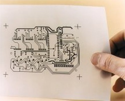

    • Thanks, I have made several pcb with toner transfer method with good results, but this time I couldn't find the high gloss paper I would normally use, not a problem, only delay until I find something that works.
      • https://www.ebay.com/itm/A4-Laser-Pr....c100005.m1851
          Some ordinary glossy magazines work fine.
          • Originally posted by Koala View Post
            work fine look link https://www.google.lt/search?q=trans...=1531512838706
            • In other Thread I saw link to Youtube video where chemical transfer method was used to transfer layout from paper to copper board. A mixture of cleaning petrol(whatever that is, sounds like ordinary kerosene), linseed oil and isopropanol was used. the thing came out perfect. I am tempted to try this method as it looks very easy.
              I will have board ready by tomorrow. Next day I begin to place components.
              I did find high gloss paper, turns out I had a few sheets left in old draw that I put away so long ago that I forgot about it.
