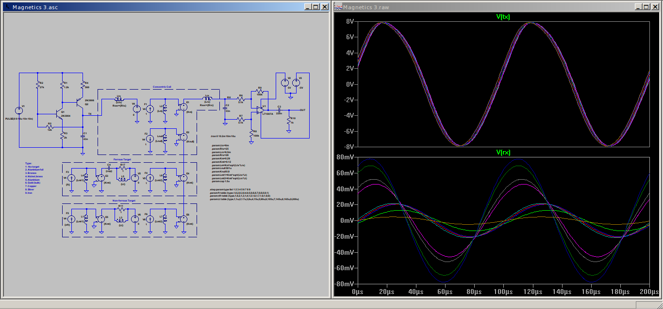

      However, in the meantime, I've modified the original simulation slightly. Apparently, when you define a mutual inductance that is less than unity, LTspice splits this into two separate parts:
      1) A completely non-coupled "leakage" inductance equal to (1-K)*Lx.
      2) A completely coupled "mutual" inductance equal to K*L.
      Hence, in this particular simulation, with K1 set to 0.29 we should set Knull to 0.71 (as LTspice seems to be considering Knull as a leakage inductance). In which case Lnull should be set to 996uH to achieve the correct balance. In fact, the result is even closer to reality. Also, Rx need to be rotated by 180 degrees.
        In Ltspice it is possible to simulate a simple balanced coil using two inductors with a coupling coefficient (K). A metal target can then be created using a paralleled inductor and resistor, so that the time constant () of the target is defined by L/R. By adding suitable coupling coefficients between the TX inductor and the target, and likewise for the target and the RX inductor, it's effect on the RX signal can be determined.
        However, there are a couple of problems here. Firstly, this approach does not provide any distinction between ferrous and non-ferrous targets. Secondly, the manner in which the RX signal is phase-shifted for various targets, and the changes in amplitude, means that this method is only appropriate for DD coils.
        In order to simulate a concentric coil, you can add a third (nulling) loop that is electrically connected to the TX loop, and inductively connected to the RX loop with a suitable coupling coefficient. In this case you must be careful how you define the coupling coefficients, otherwise Ltspice simulation will fail with the "non-physical winding possibility" error message. With this topology, all targets give a phase-shift left and an increase in amplitude, but still no distinction between ferrous and non-ferrous.
        Carl suggested the use of a core model, if that was available in Ltspice. In fact, Ltspice does have a hysteretic core model based on a model first proposed by John Chan et al, but extended with the methods in US Patent 7502723. But ... sadly ... the Chan model, as implemented in Ltspice, does not support mutual inductance. In other words, you can only use the Chan model if you have a single-winding inductor, which is not at all useful in this case.
        To cut a long story short, the only available approach seems to be finding a method of providing mutual coupling of the various inductors without using the built-in coupling coefficient (K). Then it might be possible to attach the core model to the target inductance. To test this theory I placed a zero-volt voltage source (i.e. a short-circuit) in series with the TX loop, and linked this to a CCCS to inject the TX current into an inductor that represents the mutual inductance between the TX and RX loops. The value of the mutual inductance is calculated as:
        The voltage generated across the mutual inductance is then transferred to the RX loop using a VCVS with a gain of Km (where Km represents the coupling coefficient between the TX and RX loops). The result is a balanced coil arrangement that does not use the built-in coupling coefficient (K). Simulating this setup provides the same result as the original configuration.
        A nulling coil was then added to the mix, using the same method, but with the TX current injected into the mutual inductance associated with the nulling coil in anti-phase. Initially Knull was set to unity, and Lnull was swept around a range of values to find a suitable balance point. Once a suitable point was established to within 1uH, the balance was fine tuned by adjusting Knull. The final value of Knull was found to be 0.9, which seems a reasonable value for a nulling coil wound on top of the RX loop. The nulling coil inductance was found to be 581uH.
        In the case of the TX and RX loops, these are magnetically coupled. In the case of the nulling loop, this is electrically connected to the TX loop and magnetically connected to the RX loop. However, for the metal target, this is magnetically connected to both the TX and RX loops, so the model is somewhat more complicated, requiring the use of two mutual inductances. The TX current is injected into Lmt1 (the mutual inductance between the TX loop and the metal target) and the voltage generated across Lmt1 is transferred to the target inductance / resistance combination. Next, the current flowing in the target is transferred to Lmt2 (the mutual inductance between the metal target and the RX loop) and the voltage generated across Lmt2 is transferred to the RX coil. This setup gives similar results to the original setup, but still without any discrimination between ferrous and non-ferrous targets.

        Although we have all the information required, the simulation results still did not match reality..
        Eventually I had to abandon the use of the core model, and created a simple ferrous target with the addition of a series capacitor. The complete simulation is attached.
        This is a stepped simulation with 9 separate targets, as follows:
        1. No target
        2. Aluminium foil
        3. Bronze
        4. Nickel, brass
        5. Aluminium
        6. Gold (bulk)
        7. Copper
        8. Silver
        9. Iron
        The simulation makes extensive use of the table function to connect the different models. Note that the last target (iron) phase-shifts left (like all other targets) but decreases in amplitude when compared to the residual RX voltage when no target is present. Also, if you sufficiently increase the coupling coefficient (Kmt) for iron, the RX signal will flip over and start to increase in amplitude. This is the same as happens in reality when a large chunk of iron gets close to the coil.
        In conclusion, this methodology allows both ferrous and non-ferrous targets to be simulated with a balanced coil arrangement, with the ability to demonstrate ferrous / non-ferrous discrimination. The model may not be perfect, but at least it provides a basis for further development if necessary. It may also be possible to simply revert back to the original coupled inductor version, but using the new ferrous model. At the moment I don't know the answer as I haven't tried it yet. I just wanted to present this here for your delectation, and give others to chance to play around with the Chan core model.

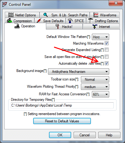

                          @Qiaozhi, you may want to prune the LTspice files prior to zipping. Raw and FFT files are most certainly not needed. There is a setting that will help you maintain your disk less cluttered:
