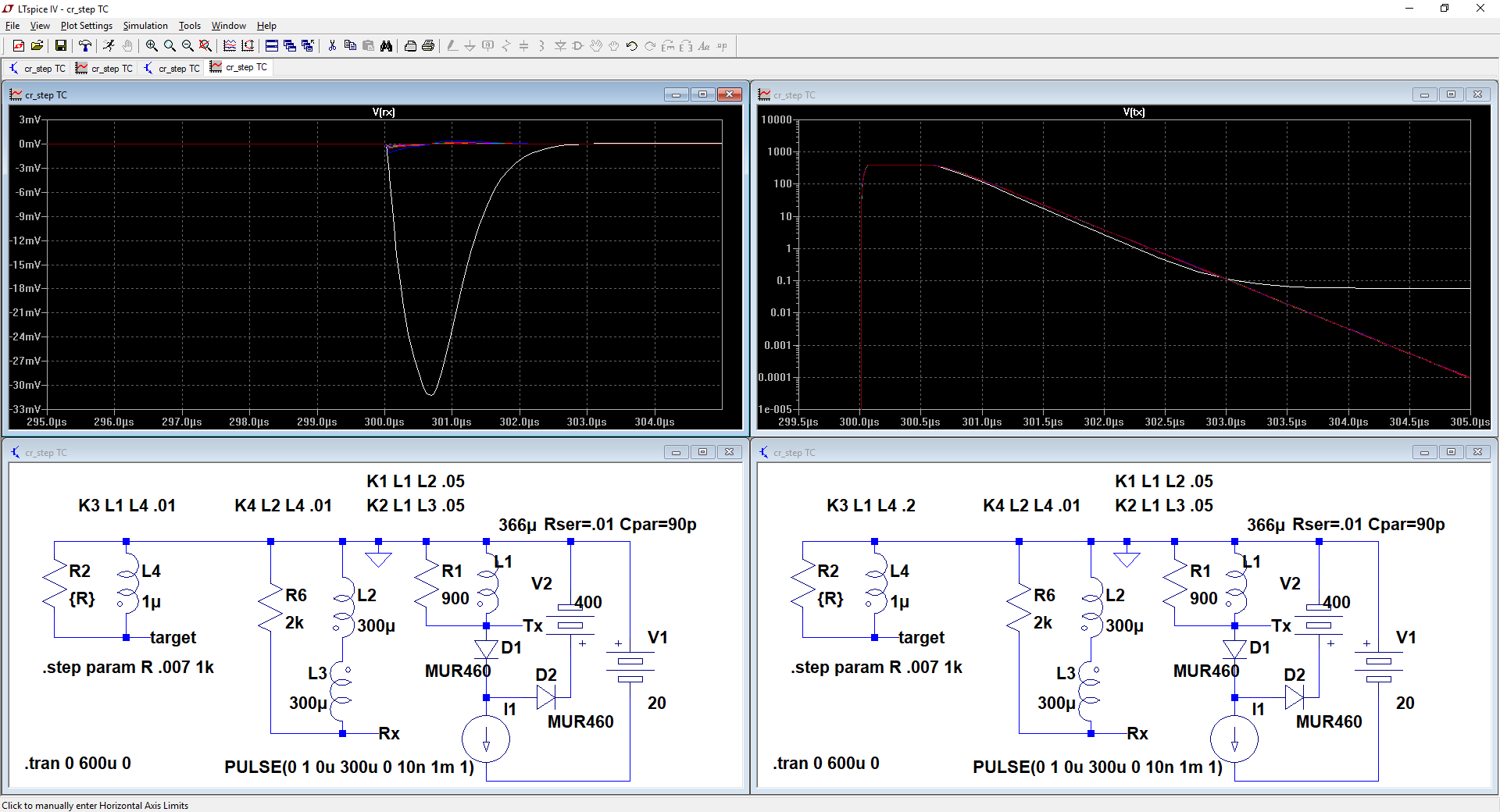

          Not a brainwave but a question. Most of the thread has been trying to get the ferrous or non ferrous target simulation to act the same as a VLF. How should they act with a PI? If I look at Rx with a IB coil, signal during coil decay is same polarity as signal after coil decay with a ferrous target. Opposite polarity with a non ferrous target. Thinking mono coil decay should be faster with a non ferrous target. Used the simulation posted earlier to look at Tx. Increased K3 coupling from .01 to .2 so I could see decrease in decay time like I was thinking. Don't know how to simulate a ferrous target to see if coil decay time increases. Does it make sense that coil should decay faster with a non ferrous target?

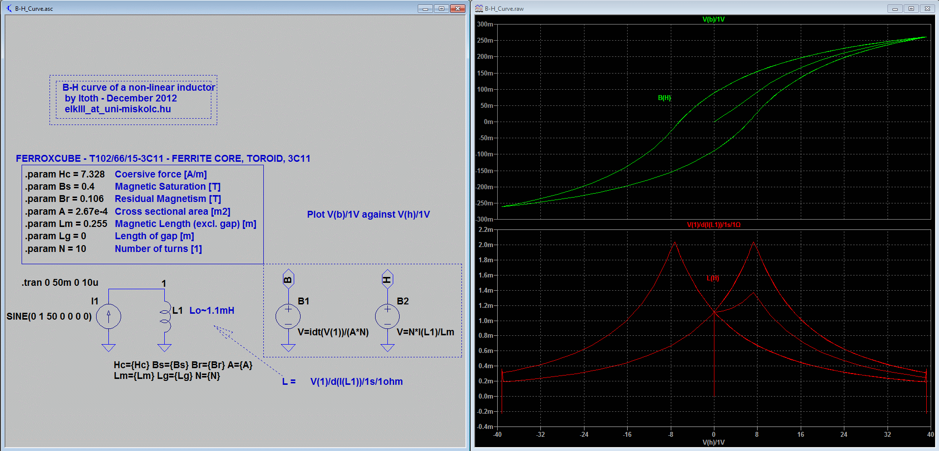

            The whole point is that there was no precedent in literature giving a generic ferrous target model so far. Mine seem to work, with a few touches, but I have to perfect the non-linear B-H behaviour. If I make it, we'll have the first model of a ferrous target.
            As for the Chan model, It is very simple to feed with parameters. There is a LTspice how-to appearing on different places on Internet, but I don't think I saw the original source. Enjoy...

              That's the whole crux of the problem. There's a dichotomy here, in as much as the phase-shift of the ferrous target is incompatible with the amplitude change. If your model displays the correct amplitude decrease, the phase-shift is wrong ... and vice versa. Unfortunately, it looks like we would need to model the magnetic field structure around the coil in order to get the correct results. How it would react with a PI is the question. If we fudge the model to work for a VLF, then you just cannot rely on the results if tested with a PI.

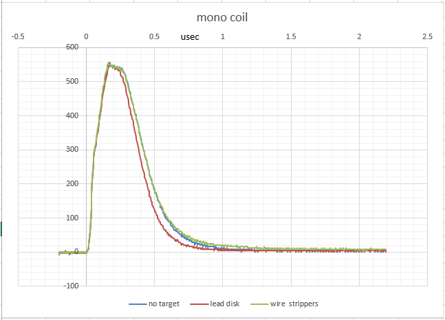

                  Tried charting coil decay with ferrous and non ferrous target. Used a small mono coil and fairly large targets to get a good signal difference. Non ferrous target charted same as simulation.

                    If only it was in a log amplitude scale...

                      Essentially you are correct.
                      A non-ferrous target has eddy currents generated in its surface, and these create a magnetic field that opposes the applied field. In effect, it distorts that overall field and upsets the coil balance. A ferrous target, on the other hand, concentrates the applied field in its interior. This also distorts the overall coil balance. Whether the ferrous or non-ferrous target produces the decrease in amplitude depends on which side the loops are mis-nulled. For the DD coil, you have to negate the coupling coefficient between TX and RX in order to flip over to the other side, whereas the concentric coil can be swept through the balance point by adjusting inductance of the nulling coil and/or its associated coupling coefficient. So, in the case of a VLF detector simulation, it is obviously possible to adjust the coil balance in such a way that it accounts for the overall field distortion for the various targets. Maybe that's the best solution we have for this scenario, and it certainly accounts for the observed effects.
                      In the case of a PI detector with a mono coil, there is no balance to upset. Hence it appears to be impossible to see the difference between ferrous and non-ferrous targets, or to include these effects in the simulation.
