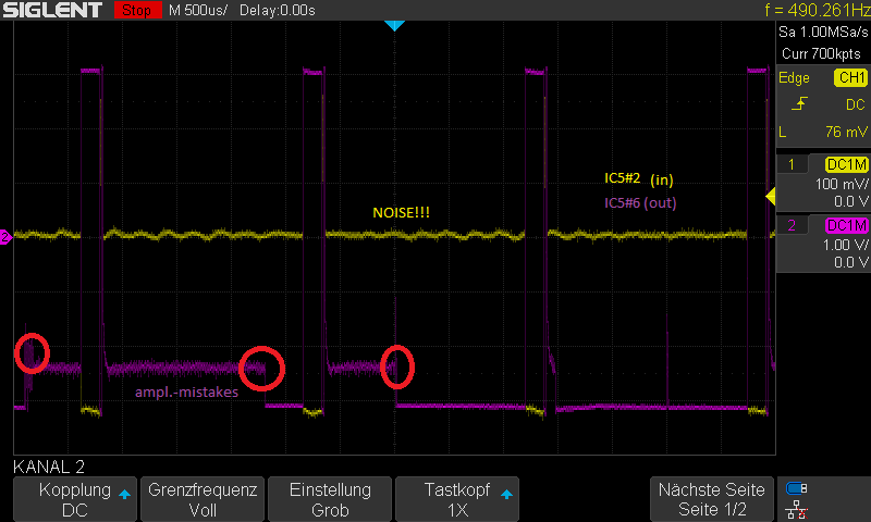

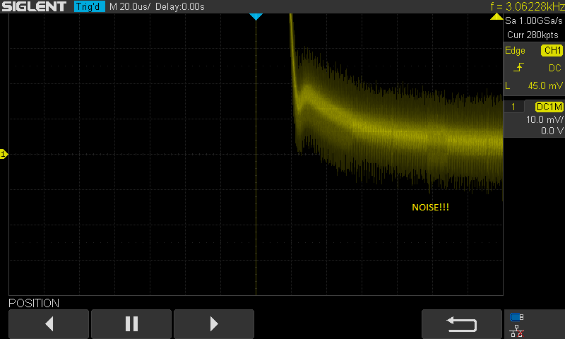

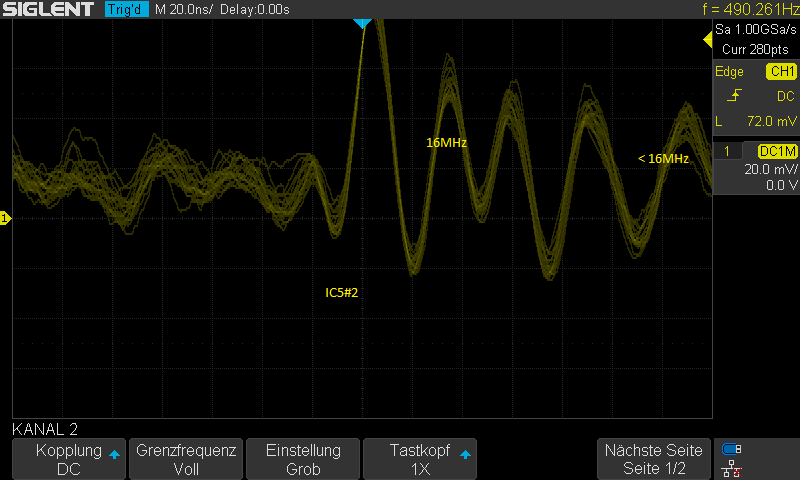

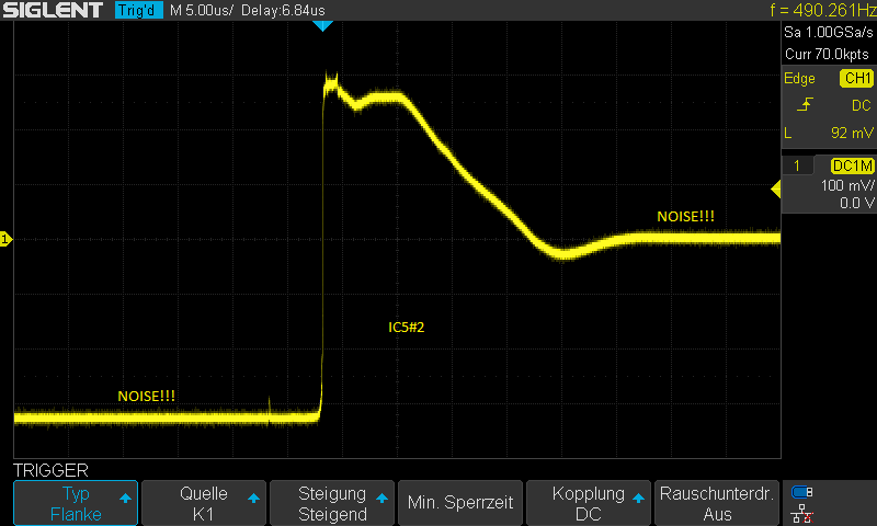

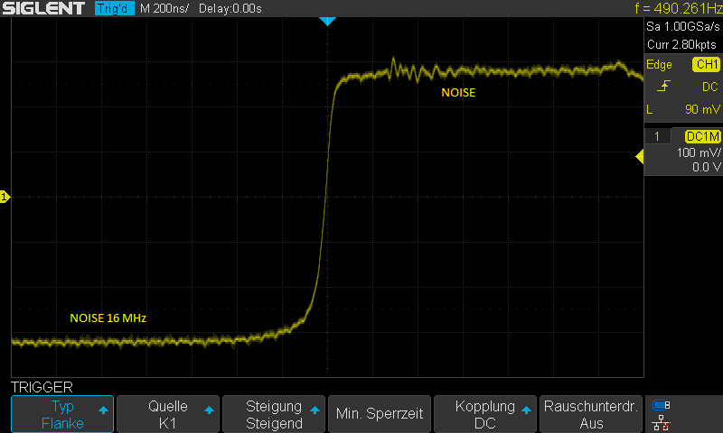

    I figured out one main hardware-problem, Diethelm always said: "Pay attention on D5, D6 and D7".
    The Signal after R7 seemed to be strong noisy (± 200mV p.p. @ 16MHz), and after R27 (IC5#2) it got stronger... The noise causes amplification-mistakes, so the signal at the output (IC5#6) seemed to "dance", it was out of control.
    First i tried to reduce the level with a pulldown -> no good idea...
    So i tried to figure out the reason for the noise with focus on XT1 and XT2 and the capacities, because there is no other 16MHz-source on Board. There was everything okay.
    Hm... So i had a look in the Datasheets of the components and figured out, that D5, D6, D7 have "high capacities", the signal began to swing through the coil and capacities, first @16 MHz, then slower, so i changed them.
    D6+D7 now are BAT42 - diodes.
    D5 now is a SMBJ5.0CA - supressor.
    Now the noise is much lower (25mV p.p.) and the signal at IC5#6 much "clearer".

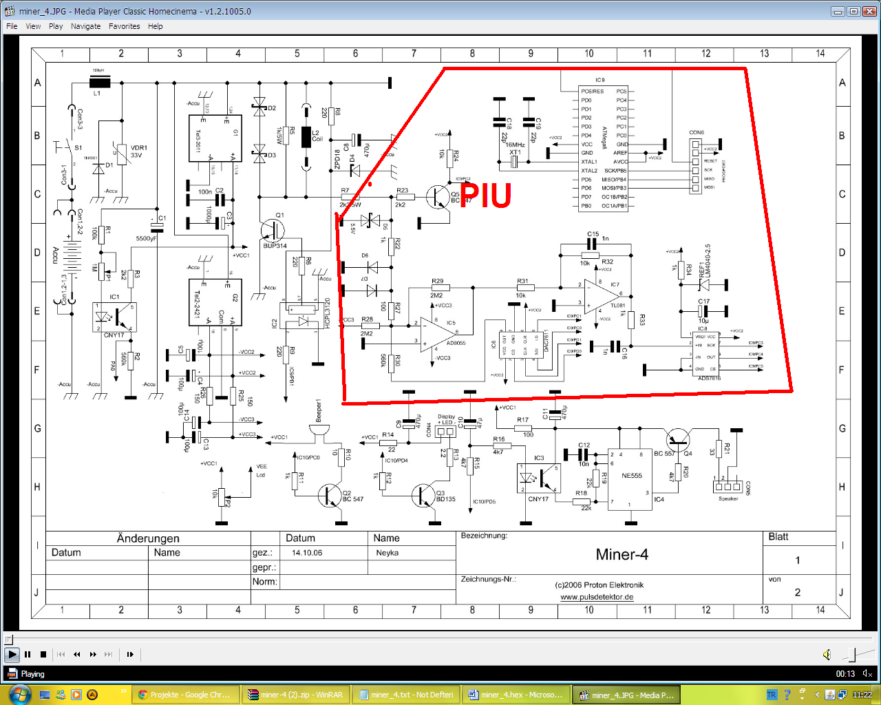

    I only have a schematic for Miner 4 in my archive (see attached).
    If you have schematics for the Miner series, please upload them here. Click on "Go Advanced", and then "Manage Attachments".

                        Another Fact about the PIU i figured out:
                        Diethelm wrote, the coil is initialized automatically. That's fact.
                        IC6#8 is the output of DAC7611. It is connected to IC5#2, the "receive-signal-input" of AD8055. The primary measurement seems to be done over Q5 - it "sends" the received signal to AtMega8. During "startup" AtMega8 "calculates" a "correction-signal" and sends it to DAC7611 (D-A-converter), so the correction-signal can be added or substracted from IC5#2.
                          Pictures of Noise
                          Noise (old configuration) on IC5#2 amplified to IC5#6

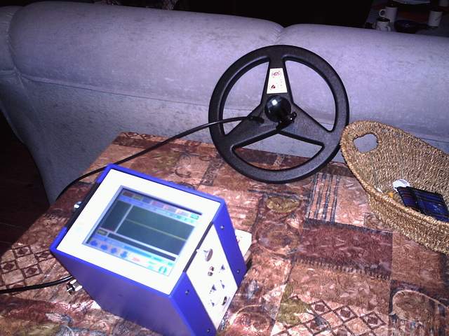

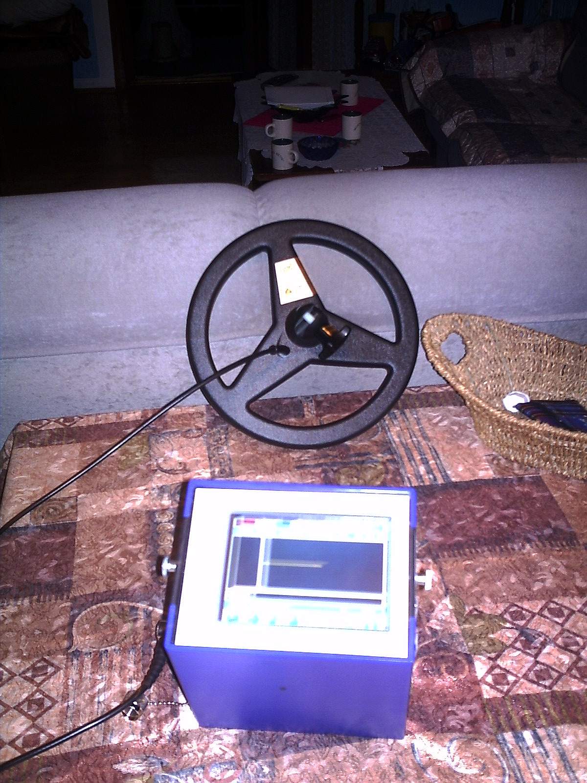

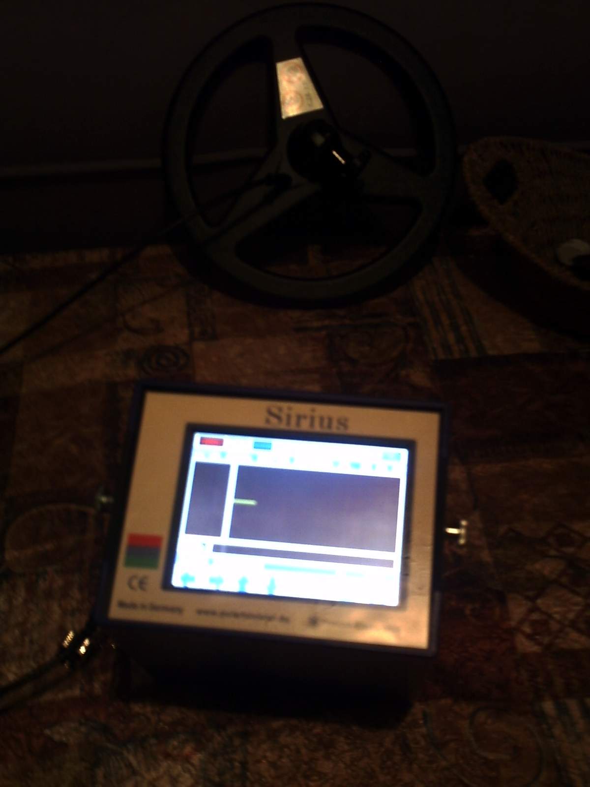

                            For the BUP314 is likely to find a much cheaper replacement is also easier to obtain.

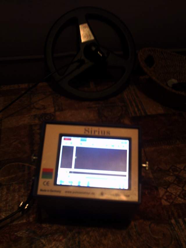

                              Excuse me in advance, i don't want to be understood as spoiler or party breaker, i just want to tell my own experiences here.
                              Back in 2008. i met for the first time those products.
                              It was the peak of their offer, the "Sirius" model. (photos bellow)
                              When unpacked it was impressive how is looking. Quite nice and "looking sharp" package.
                              Large color display. Offering a lot "jingle&bells". Breathe taking.
                              But... after just few seconds on trying to operate it; it was total disappointment , even more than that.
                              Graphical user interface lags, delays, slows down, sometimes deaf on commands. Processing them so slowly and with horrific annoyance.
                              In shorter words; horror. In addition; useless horror.
                              Ok, the "digital part" was obviously done pretty ambitiously for the time.
                              Let's try to see the performances of the "core" itself; the hidden PI detector inside.
                              So i spent 4 hours (yes, whole 4 hours in continuity) on my addict (extra large space with extra comfort for such purpose) trying to walk through adjustments and presets and finally to make it work right.
                              No way! I failed. It performed so poorly and so useless that i was quiet disappointed.
                              Very slow and inert response. Complete deafness on small and medium sized targets. Only extra large targets are detected and only on short distances.
                              At the time i had White's Spectrum with 25cm coil. It easily outperforms the Sirius in all the possible tests, by TRIPLE of the achieved distances in air.
                              For example; ashtray made of bronze with silver coating: Sirius detected it barely at 40cm distance in the air. No matter what ever i tried in adjustments. And all that with slow and inert and mum response.
                              6 hours later i was sure 100% that it is complete useless piece of junk. Overpriced by many times.
                              Complete disaster.
                              Later on i contacted with several other people and exchanged experiences. I got more less the same reports from them too.
                              Year or two after that i tried to make Minipuls2. So i made it. It worked. Not god at all. Again slow response, inert and deaf on most of the targets. Useless. In short words.
                              Now... i think that something very wrong is in the core concept of all those coming from the same "kitchen" (author).
                              So, on question "is it worth it"; i would answer like this: "Yes, maybe, ONLY if you dramatically from the roots change the core concept."
                              And even than not to expect any higher price for that. All those were heavily overpriced for what they offer in performances.
                              Wide famous DIY Delta Pulse beats the crap out in any aspect of testing or working on real terrains in real searching... compared to all models from the list we see here.
                              11 years later i am sure that a lot of improvements can be done on some of those projects. Because now we have available much better material, more powerful micro controllers and large open source knowledge base.
                              So now situation is quite different.
                              Passionate expert with a lot of enthusiasm can do something from all of that.
                              That would be my answer on that question.
