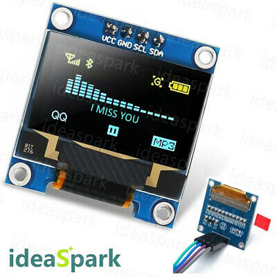

                I saw a wonderful deal on eBay for Arduino kit, it was the display options which caught my eye.
                https://www.ebay.com/itm/Arduino-Kit...wAAOSwbDpegZHY

                    Splendid offer!
                    Impossible to find anything affordable close to that.
