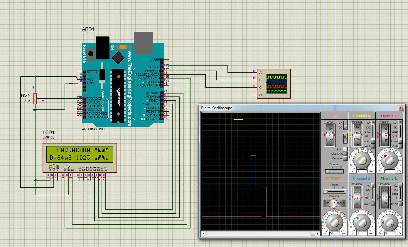

        I've been trying to master out the Proteus and its simulator.
        Just to experiment with various gate drives these days.
        But i can't force it to work in one case.
        If i want to replicate Barracuda timing circuit and place CD40106 in simulator, its power pins are hidden.
        Clicking on its properties i can see the hidden pins and designate them power supply connections.
        But i have narrow choice.
        Either Vdd or Vss or GND.
        So i put battery in simulator and named its pins reversing them, so plus pole to be Vss and minus pole to be Vdd.
        When start simulations; it stops giving me errors!?
        So i can not use neither one chip and supply it between GND and Minus, because of that.
        Maybe is impossible in Proteus. And maybe i just don't know how to do it.
        Anyone more skilled with Proteus here?
        Simple two stage inverter can do the drive job just fine. With 2uS delay, which can be compensated later in code.
        I solved the problem how to implement Atmega in Barracuda and yet how to supply it "normally" between 0 and 5v.
        All i needed was level shifter made from inverters.
        Adding MUR460 between drain and coil benefited me 7uS more to lower main delay, from 35uS to 28uS.
        But adding level shifter added 2uS back again.
        So by now as it is; it can sample not earlier than 30uS.
        Detection on iron targets is never better.
        But more work is in progress...
        • #64
          No response?
          As usual, i am on my own.
          Success after few attempts.
          Anyway... Proteus is real bijou!

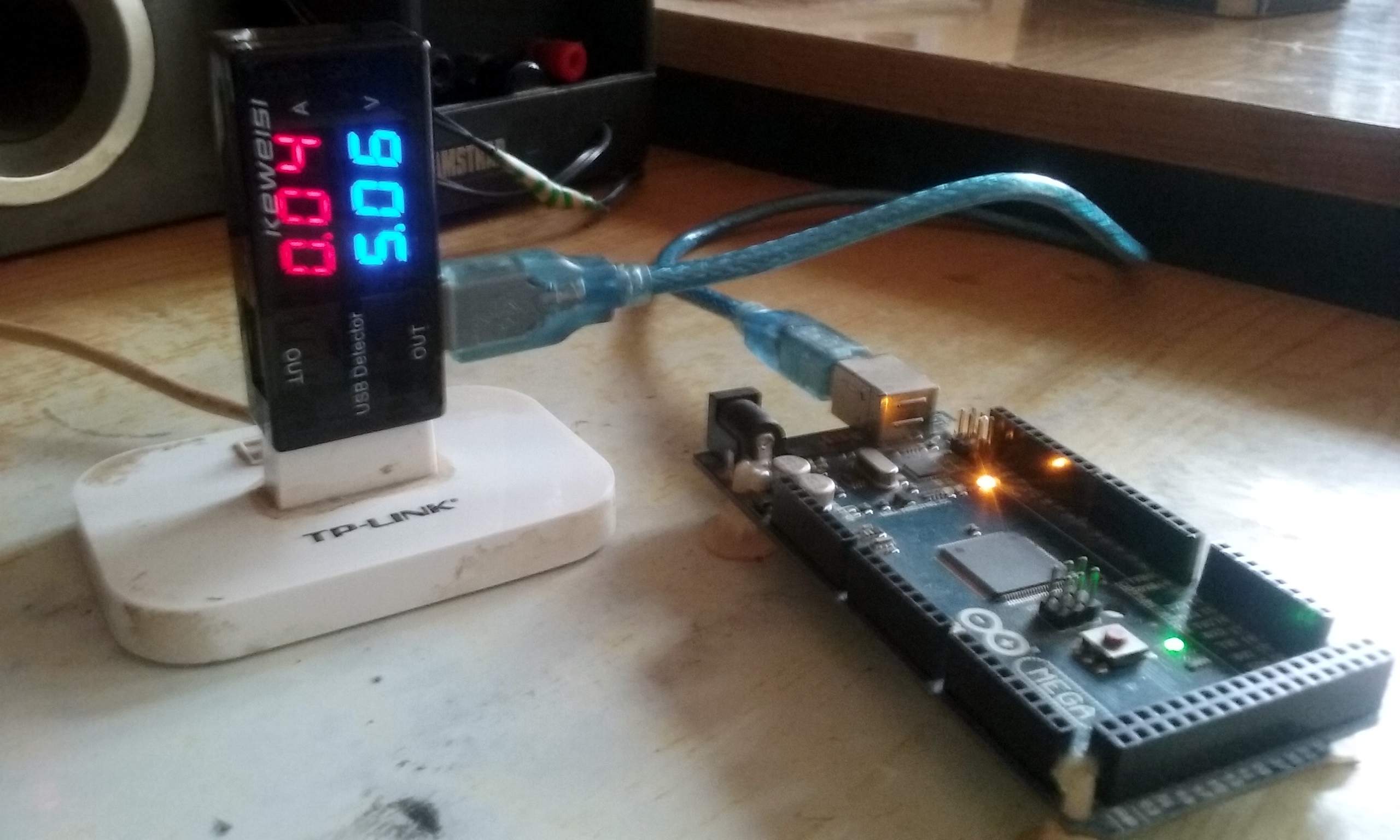

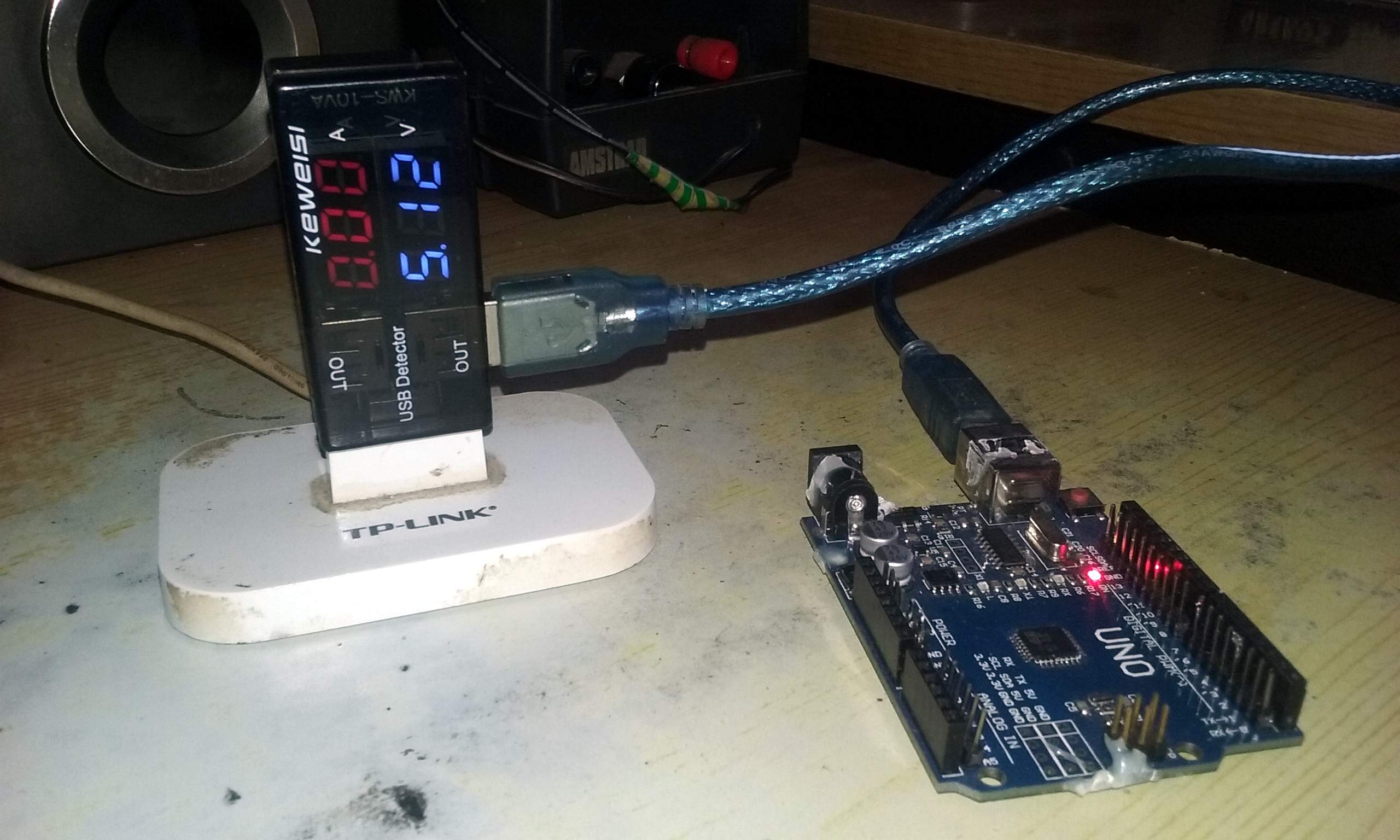

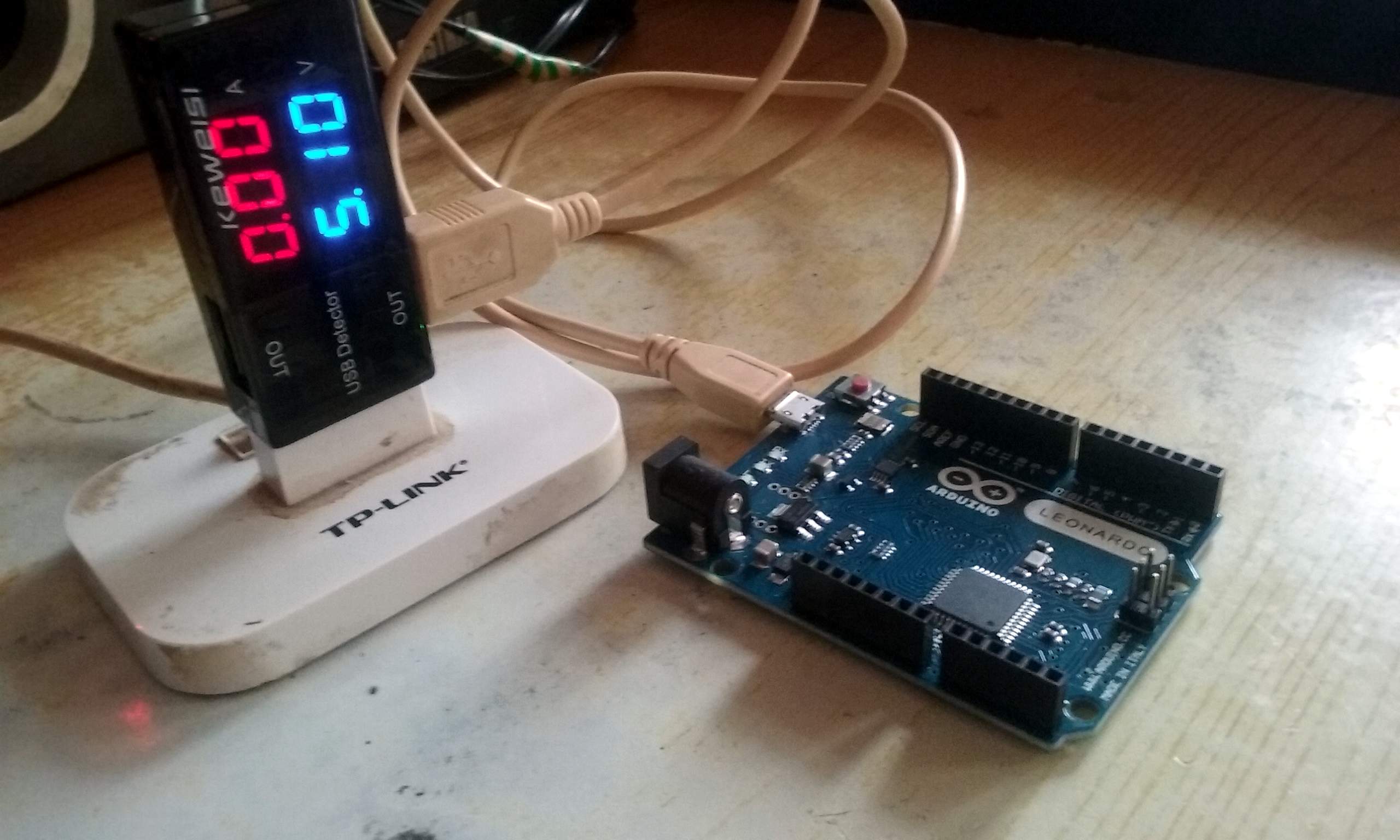

              Powering my UNO on the +5 and gnd pins it draws 45mA with no load on any output pin, thats with both on-board LEDS on
              • #67
                Funny! It never occurred me to measure current drain at those boards!
                So i checked now to see.
                Leonardo and UNO draws less than 10mA.
                Mega draws more, which leads me to suspect that something is wrong on the board.
                Which would be no wonder at all, that Mega was tortured hard during last couple years.
                Simplest check you can do is to check digital pins and their state.
                Are there any voltage on those or is anyone shorted to ground.
                Most frequent fault is digital pin shorted to ground due excessive load put on it.
                As i recall; 20mA is maximum per digital pin.
                Here are my measurements:
