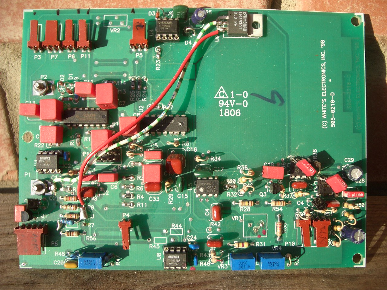

    can you show your pcb? i want to see a number of series. whites used through numbers for whole pcbs.
      I can't find my mod schematic, you'll have to show me what you're doing.

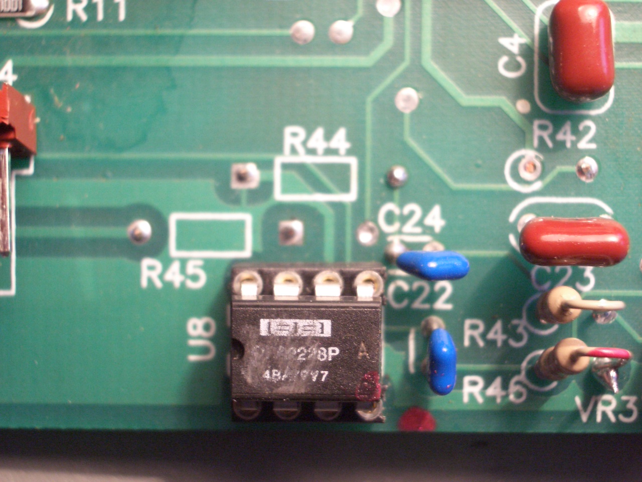

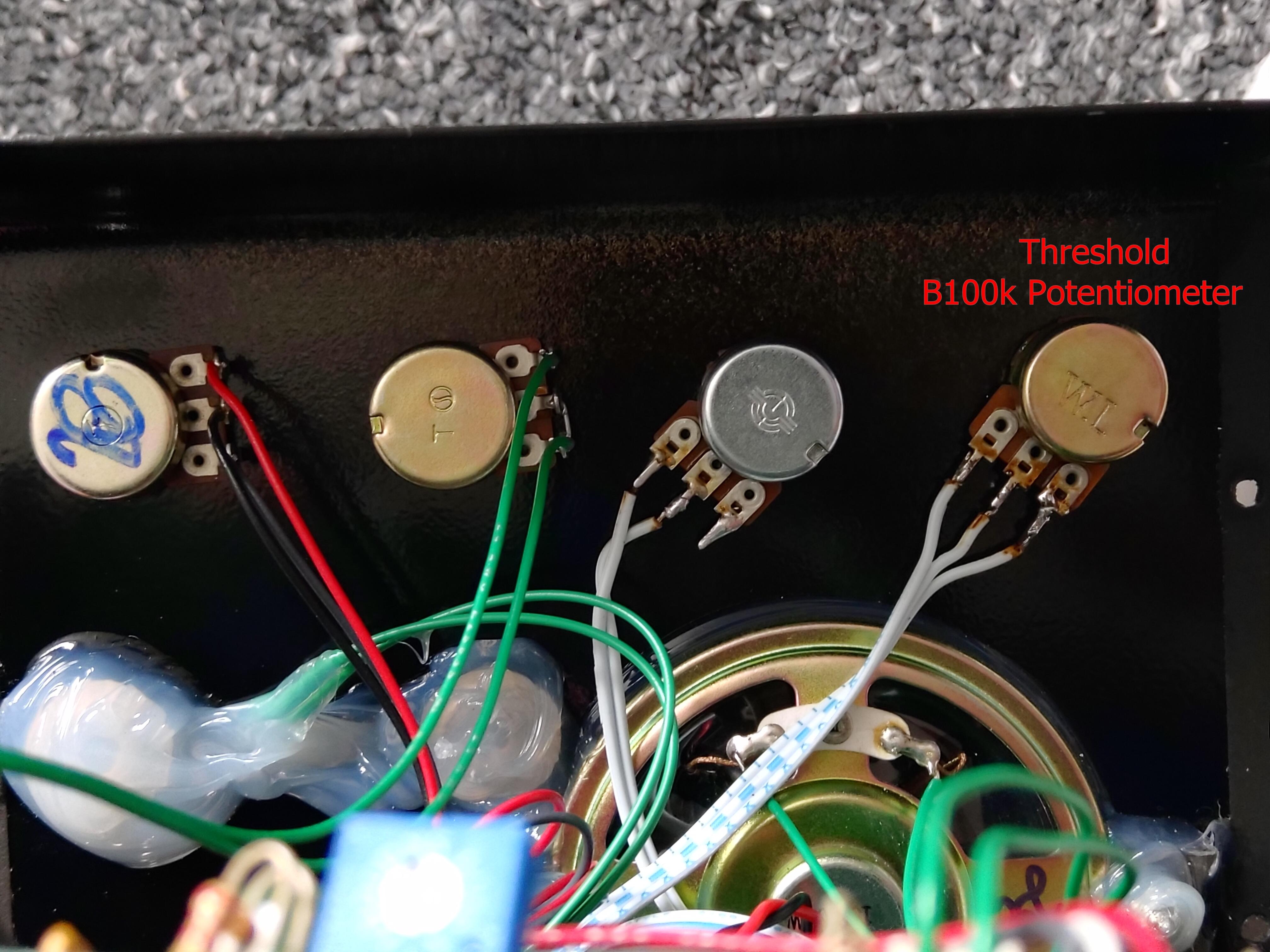

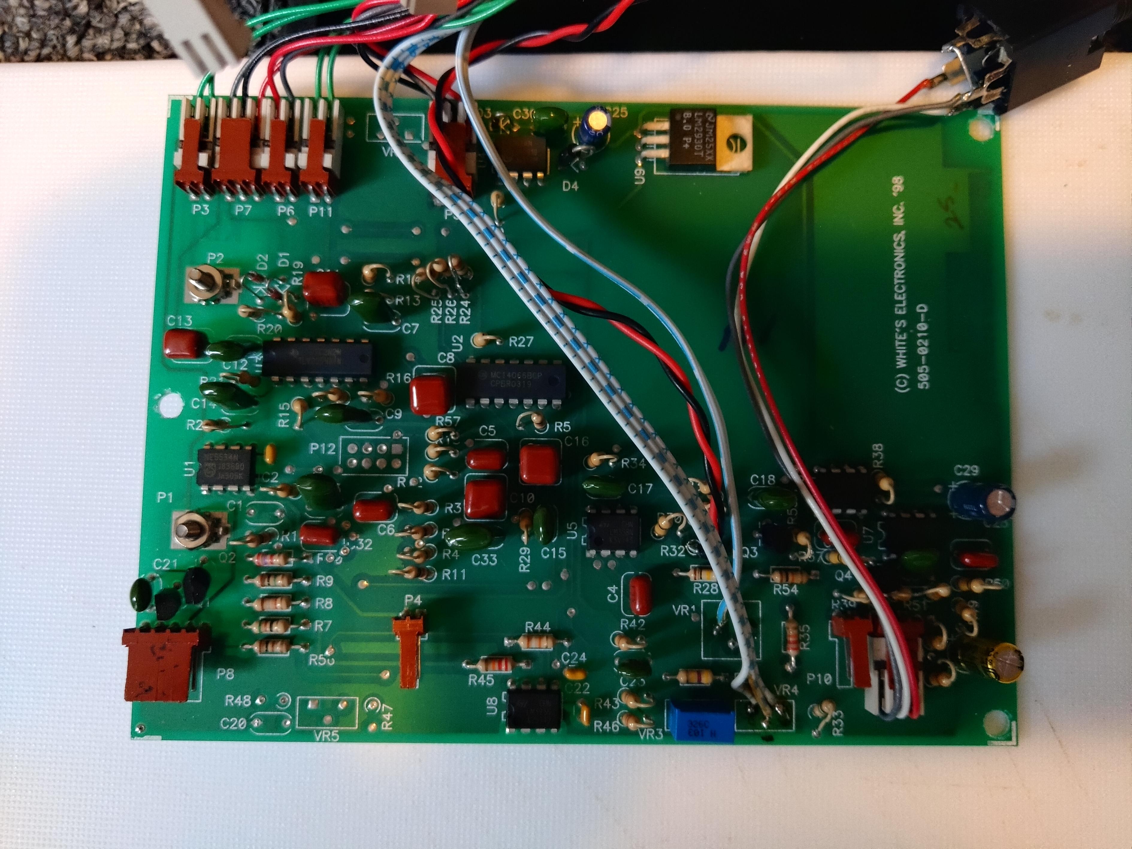

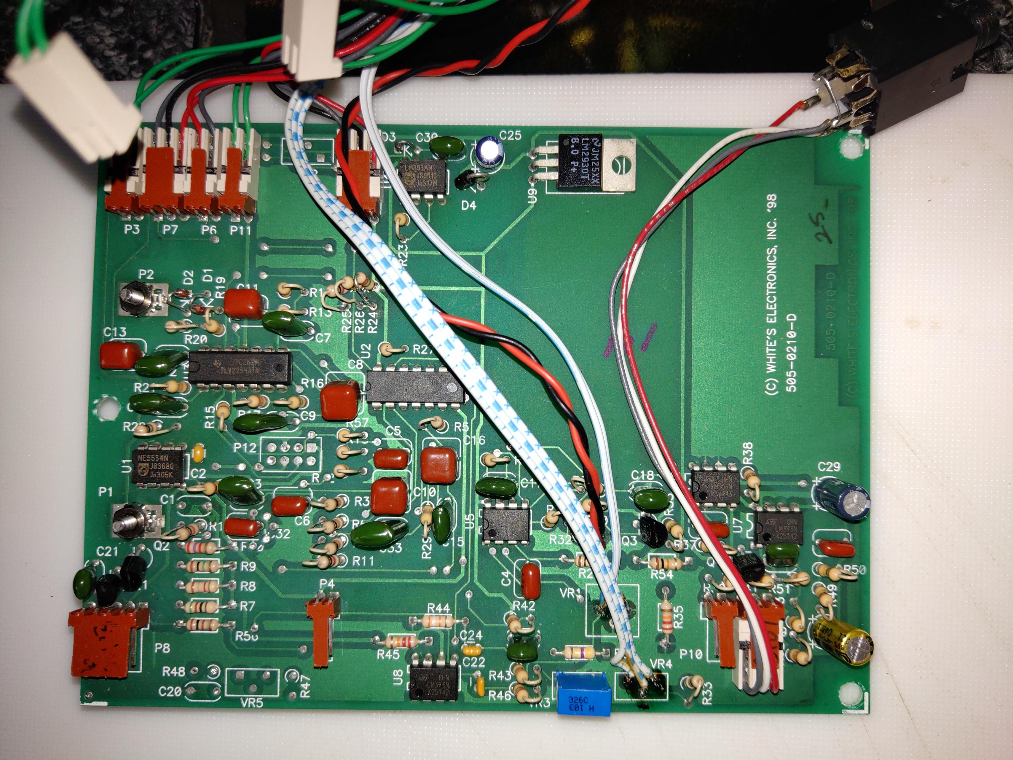

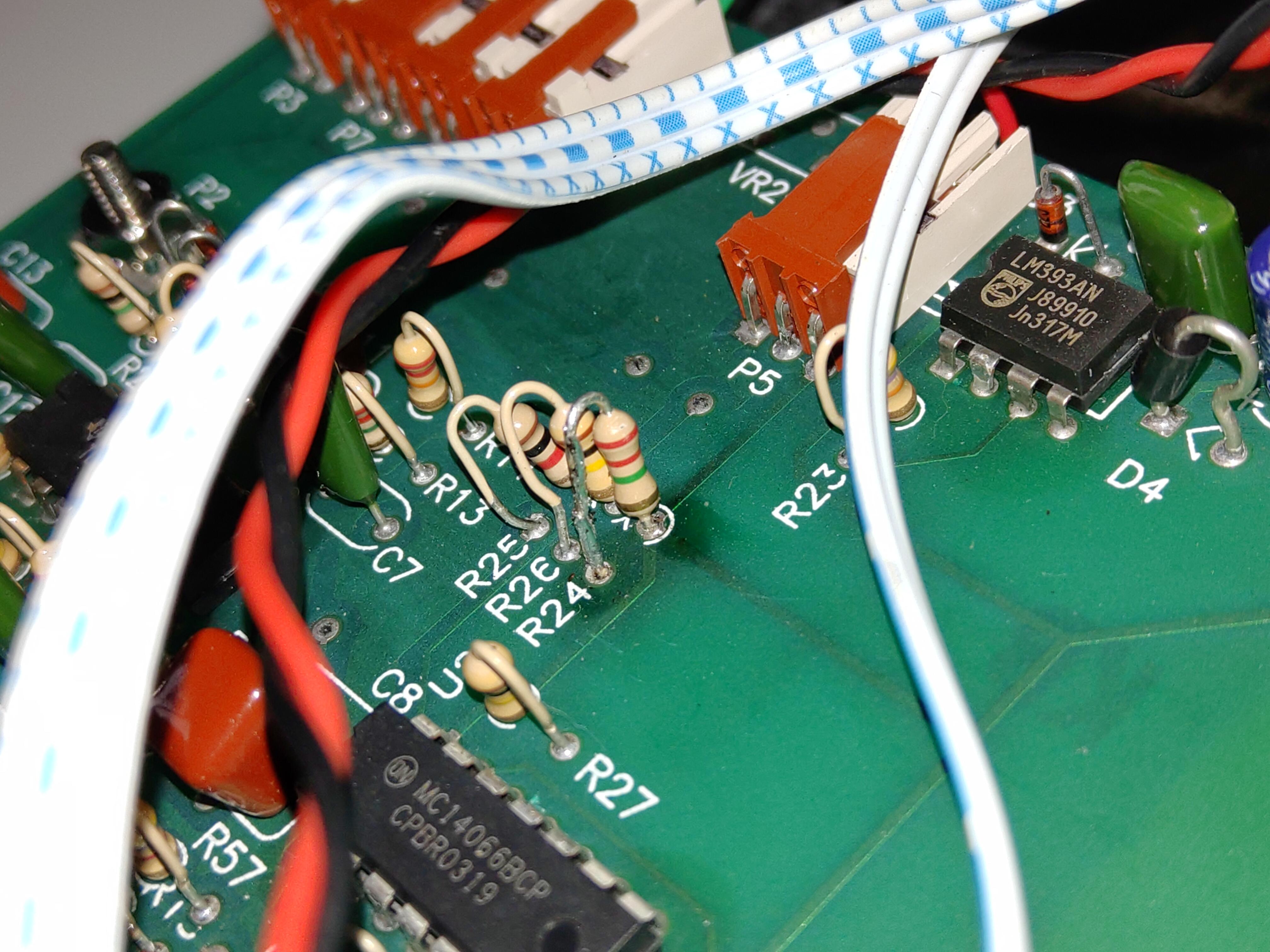

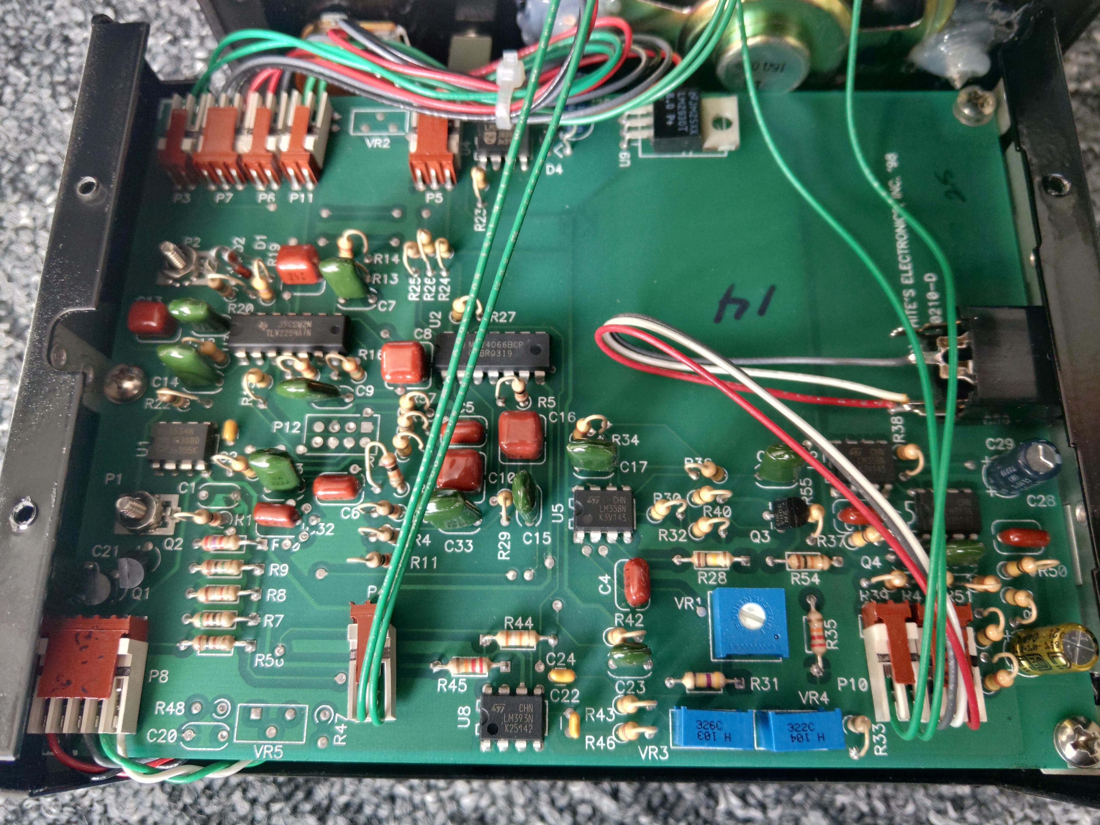

              here is some photos guys as promised. not perfect but i tried my best. it defiantly looks the part mind in pic 0. pic number 1 is before i even did anything to the board.
                Can you show a pic of the threshold pot (back side)? Try putting a voltmeter from the center lug of the threshold pot to ground. It should vary from 0V to 0.85V.
                  505-0210-D revision board.
                  not Bills mod. just a mod. thx for the pics.
                    is this what you needed to see.

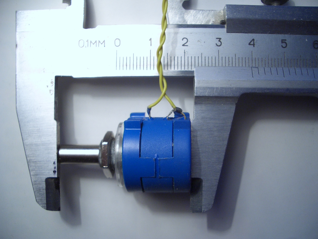

                    when i bought the B100k potentiometer it came as a pack of two. i have checked the resistance of both of them. one measured 74 and the other 85 ? i tried each of them on the board, but neither make any difference. ware is MR Bill when you need him.lol
                      the pot.

                            i have tested the voltage on the pot. it was measuring from 0v to 0.55v the battery is only showing at 11.24v due to using it over the last two day on testing. it has got me stuck on what i can do. every thing else works fine just i have no all metal mode with a loud constant tone. plus no working threshold. i followed the mod steps which are not that many to be honest. which i did to a classic 2 once before. that all went strait forwards, but this machine just wont have it.
                              connect 6 pin of U5 on GND (lower pin of R32, C18 etc). disconnect C16. measure voltage on 7 pin U5 and write the value
                              and do you hear a sound or not, in ALL METAL mode.
