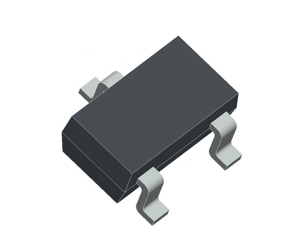

                  H Carl.
                  the part Q6 on the board is the same shaped typed component etc as Q7 but when i look up for a PNP BC856 i just get a different type shaped transistor.
                    Carl is right that's a PNP. It looks like the BC856 is only made in surface mount currently. Believe it not that detector is 30 years old! You can probably use a 2N3906 or 2N2907 TO-92 package.

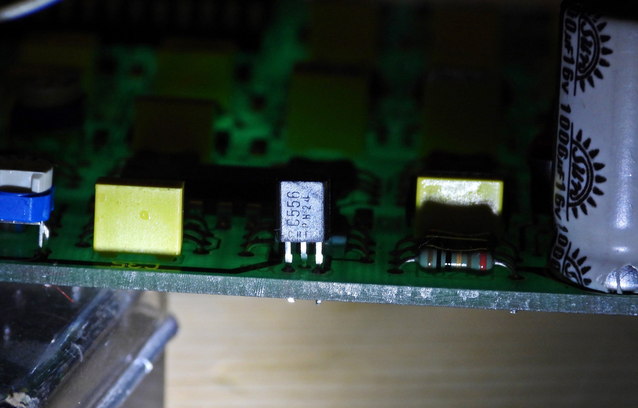

                          Hi Carl.
                          here is the Q6 component on the board.......
                          • #43
                            BC556
                            C B E
                            collector base emitter
