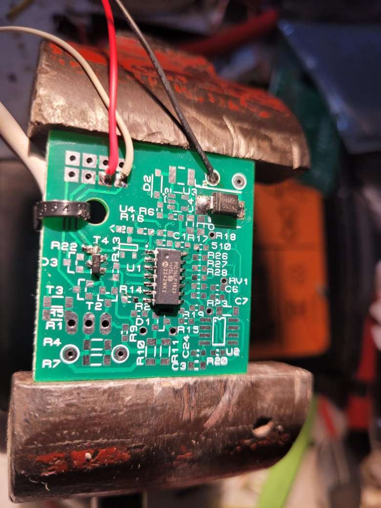

            • #51
              hi to all i cant get pic16f1823 just i have pic16f1824 is that a problem to work
              • #52
                Those two PICs are pin for pin compatible. The 16F1824 has more memory and a couple extra features.
                Therefore, the '24 can be used.
                However, you MUST have the Source code and re-complie for the '24.
                Did you use the Code David_1​ created???

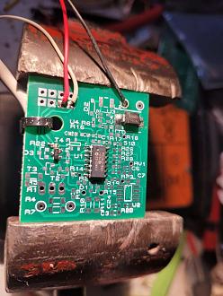

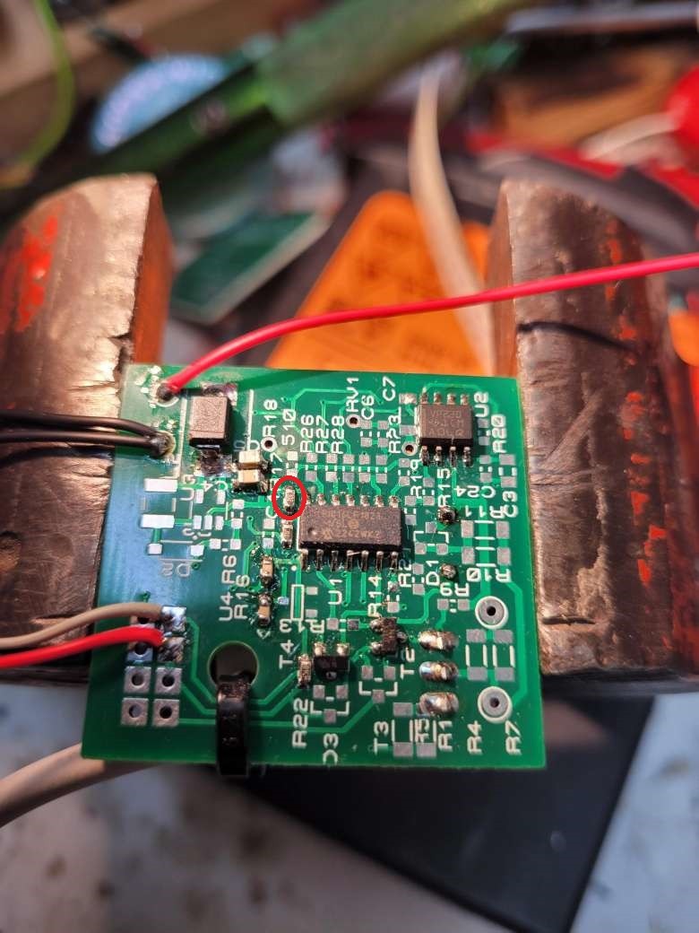

                • #53
                  I have spent the evening fighting with the adc, for my sins I do not have 3K3 resistors I use 3K so much I normally see them as the same, obviously in the battery divider and wanting to test Eddys code before I mess it up too much I ended up stacking three 0603 10k resistors in parallel to get closer to 3k3
                  single res in this pic in red circle

                    • #55
                      Thanks you friend EDDY 71 . but i ask you please i just have pic16f1824 then . Can this pic16f1824 work instead pic16f1824 i see it s seem resombling. I try many TL072 THAT I HAVE . Can you chow whitch mark uses.
                      • #56
                        This code is for a PIC16f1823 it should work on the 1824... all it does is flash the 6 leds, try it on your setup ?
                        • #57
                          well it works ,but needs a little tuning now.
                          it did have the blinking led (problem) well not really a problem. the coil did not measure 350 mH already forgotten the resistance lol will check.
                          so I added more wire to the coil, thinking that must be enough... still only measured 250 mH.. but that was enough to allow it to work.
                          without any way of measuring inductance, can you make a coil that should work ?
                          I am thinking could the detector itself, tell you to add or subtract more wire ? your thoughts ????

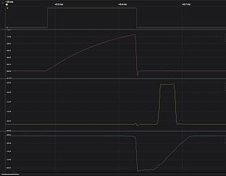

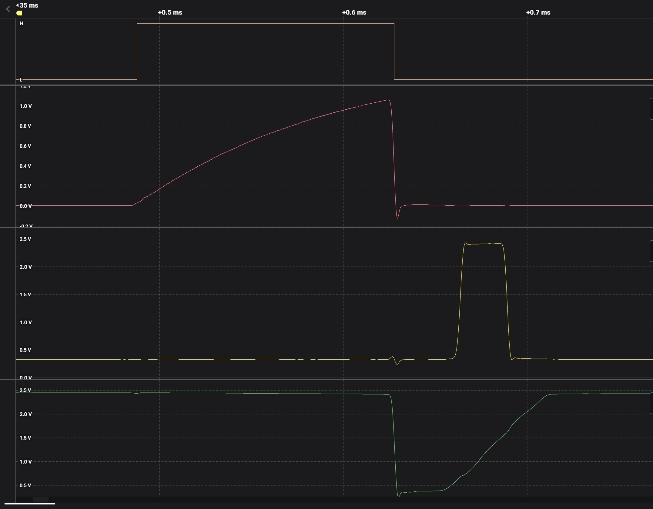

                          • #58
Name:	analog capture 3leds.jpg
ID:	409173 Click image for larger version
