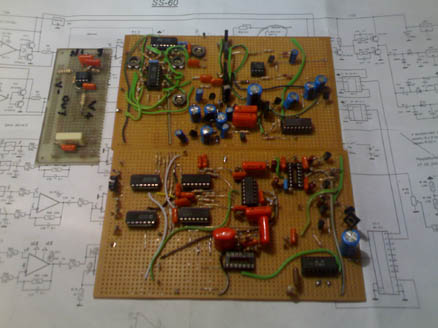

                I am near to finish the Anker SS-60. I must make the transmitter but i am not sure about DA1. It is a double Op.Amp so i will try with a LM747. Any idea ??:confused: :confused:
                  > LM339 is OK for 157UD2???
                  NO. LM339 is 4 comparators (LM393 - 2), 157UD2 is 2 ordinary opamps like LM358.
                    Thanks KT315.
                    I will try a LM358
                      Finito la musica but HELP
                      Hi. I finished Anker SS-60. I connected a coil that i have from an china detector to the oscilator and i tried the generator. Generator and power suply worked fine. But i must try all the detector. Anker gave me the turns for the coil at 39 cm diameter. May anyone to tell me where i can find a coil housing for a coil 39 cm ????? I don't like to make a coil 10in only for the test of SS-60. Or do you have a easy way to build a coil housing ??
