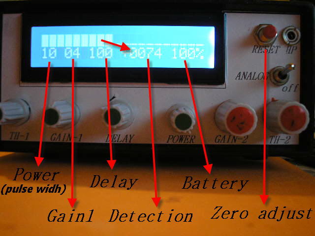

    Finally, ready my new project ,
    first , I can't find tel-12... part so use two battery but if you can find this
    part not need two battery.
    second, you can see original minediver in this address:
    http://www.pulsdetektor.de/projekte/projektindex.html
    I am busy and very tired, so test this metal detector for 4-5 time but
    understand :
    abut sensibility , with very good adjust with 35cm coil can detect
    50cm X 50cm at 2m. (I only can do this for two time because can't adjust
    very good in home).
    with 35cm coil detect small silver ring at 19cm
    and for other test like small coil , gold (because this metal detector have
    DELAY adjustment) must wait, because my battery under charge.
    If somebody have PCB layout tell , I send .
    be successful

                    front panel:
                    (In MINIDIVER if don't want LCD can don't use this, because this is very
                    sensitive and without LCD can use only headphone .but in minipulse must use
                    LCD)
                      Now you have set the sample delay at 95us!
                      And when you set Delay pot at 500-520, the sample delay is about 180us!
                      Minediver doesn't detect Gold at all!
                      yours!

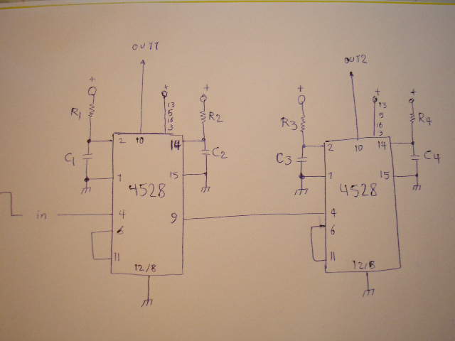

                            I forget correct , MINIDIVER part list before send,
                            so change this parts :
                            R3=10k (100k for 18V , we use 12V so must use less resistor for R3)
                            R19=10k (in minipuls I could set null with 100 ohm but in minidiver can't , so
                            use 10k for null set and can do this)
                              Max ,can replace 4538 with 4528 or not ? and how must calculate timing ?
