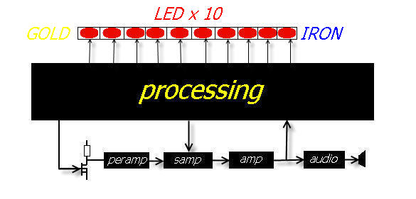

      Max, I want make metal detector with DISC.
      see this schematic , I need use difference frequency with difference
      delays and test output of amp and process this information for metal
      Discernment . what your suggest for these difference frequency and delay?
      for difference frequency and delay I don't Limitation.(for example can use
      10 difference frequency with 10 difference delay without any problem)
      with do this can understand this hide object gold or brick.
      so need your help for these frequency and delays.

            this is the most difficault part for a PI: discrimination !
            Many claimed it's possible...in a reliable way... but, untill now, nobody realized in a good way as I know.
            The most advanced attempt is PulseDevil by Dave Emery... I don't know results about... and advancement of project.
            You can see in many detectors (e.g. Lorentz or PulseStar serie) that object is discriminated by a measure of its resistivity (or conductivity... that at the end is same thing reversed).
            Way to do so is taking some samples in early phase of signal decay just right after the first delay ... then compare them (by formula inside MCU)with known responses from known objects made of various metals and with some background level from a later (or more later) sample(s).
            I haven't the right data but remember that there was a german pubblication about those values, a book or something.
            You can also avoid the pubblication and find your way but have to collect data for signal responses for various metals. Not easy to do.
            Best regards,

                            Originally posted by sisco View Post
                            Max , your idea about timing , I want first make new device for test your
                            idea but think and decide first test this timing on my minipuls.
                            so erase minipuls ATMEGA8 and programmed by new program (1KHz ,100us
                            PW ,15us , 45us first delay , 200us interdelay and 45us second delay) and
                            test , what you think ?
                            YES this work and I can detect GOLD with this timing.
                            this is my programm writed on ATMEAG8.
                            evrey step =3.75us for example A = 27 mean this time is 101.25 us (IN THIS TIME MOS-FET IS ON)
                            $regfile = "m8def.dat"
                            $crystal = 8000000
                            Config Timer1 = Timer , Prescale = 1
                            Stop Timer1
                            Config Portb = Output
                            Config Portd = Output
                            Portb.1 = 0
                            Portd.6 = 0
                            Portd.7 = 0
                            Dim A As Word
                            Startline1:
                            Start Timer1
                            A = 0
                            Portb.1 = 1
                            Do
                            A = A + 1
                            Loop Until A = 27
                            Portb.1 = 0
                            A = 0
                            Do
                            A = A + 1
                            Loop Until A = 4
                            A = 0
                            Portd.6 = 1
                            Do
                            A = A + 1
                            Loop Until A = 12
                            A = 0
                            Portd.6 = 0
                            Do
                            A = A + 1
                            Loop Until A = 53
                            A = 0
                            Portd.7 = 1
                            Do
                            A = A + 1
                            Loop Until A = 12
                            A = 0
                            Portd.7 = 0
                            Do
                            A = A + 1
                            Loop Until A = 158
                            Stop Timer1
                            Goto Startline1
                            TIMING:
                            Frequncy = 1001.5 Hz
                            PW(ON PULSE) = 101.25us
                            delay= 15us
                            first delay = 45us
                            interdelay = 198.75us
                            second delay = 45us
                            OFF PULSE = 592.5us
