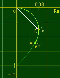

                          Exercise No 2
                          Exercise 2 "Normalized Transfer Impedance of conductive nonferrous object "
                          Attached FIG. 6 shows transfer impedance of a conductive nonmagnetic object in which flow whole set of eddy currents. You can see, in above mentioned WEB site, an animation - how moves point M when we increase frequency and how - if there is different cracks in the structure. The shown impedanceform is valid for most nonferrous targets and for halfspace (salty water and conductive soils without ferrous mineralisation). Only metal foil has slight different impedanceform because skin effect is inessential at low frequencies (the whole thickness of foil is used by eddy currents).
                          Because this impedanceform is normalized, it is independent on:
                          - diameter of target,
                          - diameter of TX loop,
                          - conductivity of metal or of halfspace,
                          - distance between sensor and object,
                          - ampereturns of TX current,
                          - turns of RX winding.
                          NOTE the following regularities:
                          - The impedanceform at low frequencies seems like those of an object having single eddy current.
                          - The cutoff frequency fc seems as if no difference with such one object.
                          - The magnitude of signal at high frequencies is remarkable greater (approximatelly 30%).
                          IMPORTANT: It follows that if we design a wide band metal detector displaying impedanceform in complex plane, we can discern the shape of nonferrous targets. If the impedanceform is half-circumference, the target is like bracelet or ring. If the impedanceform is stretched at high frequencies, the object has no large opening.
                          Using this normalized impedanceform, you can solve following problems and answer to following questions:
                          1. Plot in normalized form frequency functions in Cartesian coordinates Re(f) andIm(f).
                          2. Plot in normalized form frequency functions in polar coordinates: Magnitude vs. frequency and Phase vs. frequency:
                          a) in linear scale
                          b) in log scale,
                          c) approximate log scale as Bode plot.
                          3. Explain what is the difference in comparison with some frequency functions of single eddy current.
                          4. Are there errors in the figure on the WEB site?
                          HINT: Pay attention to inscriptions on axes; they are different from our exercises. Note that at nonferrous conductivity, imported inductance (coordinate Im or X) is always negative.

                            Z=R+jX
                            Hi Aziz,
                            You have used two times the incorrect notation
                            Z=R+jXL
                            The correct notation is
                            Z=R+jX.
                            Please read [2] Chapter 30 to understand why.
                            In our case L is an irreal imported inductance, because is negative and transient (depends on time or on frequency). As you knows, a real coil has positive inductance which is almost independent on frequency. This will become visible when we start exercises with SPICE simulator.

                              Mike,
                              thanks, I meant with XL (w*L) the reactance of the coil of course.
                              I will write only X in the future.
                              Aziz
