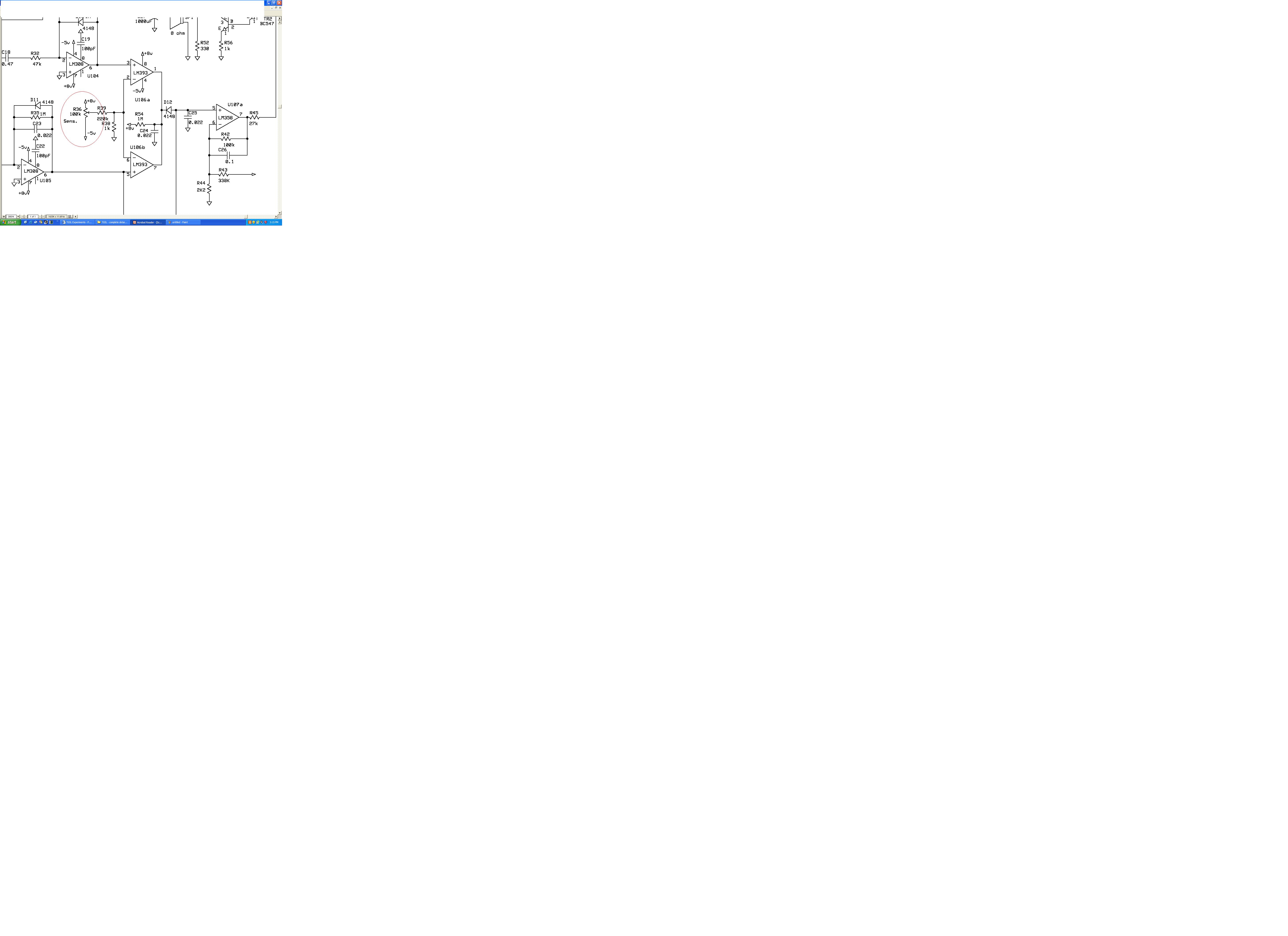

    Here is something I'm looking into that could greatly affect the sensitivity and depth of our TGSLs.
    The quiescent output voltage of the LM308 (pin 6) is supposed to be 0 volts.
    If it is not, then it will change the detection to varying degrees.
    The threshold range of the U106 comparators is about 3.6 mV to 36 mV (controlled by sensitivity pot R36). If the LM308 quiescent output voltage is not zero, it will directly affect the the detection.
    It is also important the both LM308 outputs have the same quiescent output voltage (if not zero), otherwise the GB and DISC channels will detect at different thresholds.
    I just measured mine by removing the RX coil.
    My disc LM308 output voltage is about 7 mV, and my GB LM308 output voltage is about -2mV. (I see some high freq noise there, but not sure if significant or just something my scope sees.)
    So my case is not ideal, but no too bad, but if sensitivity threshold is at 3.6 mV, you can see there is a big relative difference. A negative offset would definitely reduce your detector sensitivity. In my case, I don't know if the amount I have is a problem or not. It could mean my LM308 precision ICs are not so precision as they should be. I got them for about 50 cents each. Or maybe a voltage gradiant along the ground buss is responsible, although it seems to check out fairly well. Could it be some high freq noise that get's rectified at the inverting inputs creates a bias??? Anyway, an area to check out.
    QUESTION FOR OTHERS
    I am interested if others could try disconnecting their RX coil and measure DC voltage at LM308 pin 6 for both LM308s (or whatever IC you have there).

            • LM308 quality
              Back to the LM308 quiescent output voltages.
              I learned that the LM308 quiescent output voltage seems to vary with the chip. So the offset is due to each chip, not the circuit.
              I swapped the chips and now my TGSL works a little differently. Actually seems a little less sensitive with -3 mV offset on the DISC LM308 and about 7 mV on the GB LM308. In other words, the positive offset on the DISC channel may actually have been helping a little to boost weak signals when combined with noise and for certain sensitivity settings. But this is sort of a comedy of errors.
              However, these little offsets are dwarfed by the typical noise signal I see there in my workshop. So you would think the would not be noticeable.
              But because a lot of the noise pulses are filtered out by the low pass filter that follows, I think even the small offsets do have a noticeable effect.
              What I would like to see is a lower noise level and LM308 quiescent output very close to zero.
              I think I'm going to need to get to a noise free environment to really start to analyze this.

                            Here is all I did! (plus a noise free environment) It just allows pins 2 & 6 on U106b to use a minimum of -.03V as a reference. The "threshold" of my LM393s is -.25V. This mod is impractical though, as in actual use my circuit functions just fine.. and with R36 set to a minimum tends to be a little noisy as it is. But, I wanted to spark some ideas on what might be going on with other circuits.
                            One thing I might actually use this for is use with my 7" coil. It air tests at around 33cm.. but it might give the detector a little more edge in the soil. The 7" coil is very quiet.
