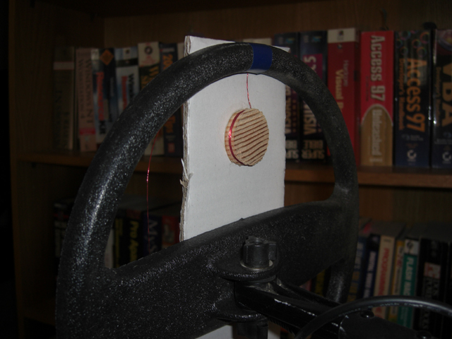

                  4. Hypothesis: current, not voltage, in TX coil is what matters! A more resonant coil can have higher current. Need measurement of TX coil current.
                  Results: I rigged up a "sniffer" coil to sample the magnetic field of the TX coil. This should be an indicator of the current in the coil. However, it turned out that dfbowers TX coil current was about 4.5% higher than mine. Would not explain 16% higher null voltage.

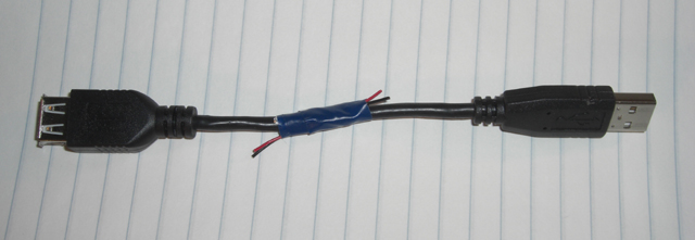

                  I wired up some "bypass" USB connectors so I could have the TX coil connected to the PCB while the RX coil was disconnected, and vice versa. Then measure RX null with all combinations of connections and injecting the signal into the coil side or the PCB side.

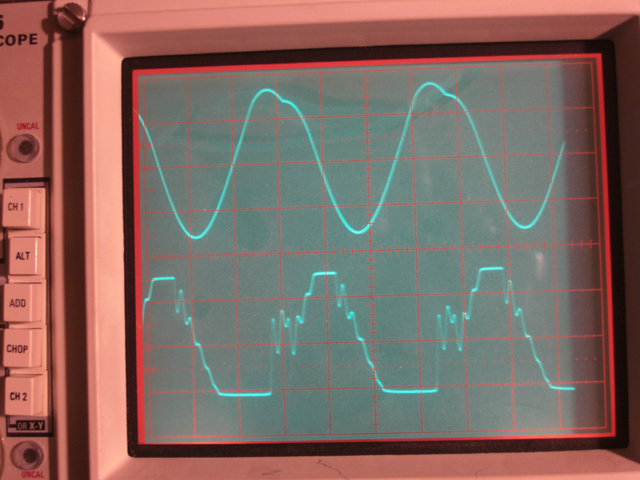

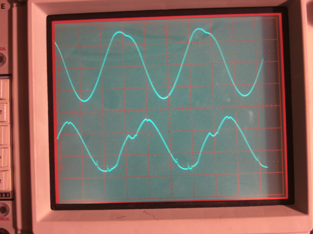

                  Test
                  The most convincing test (with least amount of dangling alligator clips and questionable probe contacts) was as follows:
                  I injected an approximately 16 V pp signal into the TX coil while still connected to the PCB -- in other words, PCB power was turned off, the oscillator was not actually running, the TX signal was coming from an external signal generator, tuned to about 13.7 kHz, same as oscillator freq.
                  Then I took an additional 6 foot USB extension cable and added it to the existing coil cable, and compared results of the 12 foot cable with the original 6 foot cable.
                  Interestingly, with the 12 foot cable, my null was larger than dfbowers. With the 6 foot cable, dfbowers null was larger than mine.
                  6 foot cable: Vnulldfb / Vnullsb = 3.5 / 2.9 = 1.2
                  12 foot cable: Vnulldfb / vnullsb = 3.1 / 2.5 = .8
                  It was pretty hard to stabilize these voltage measurements, so fairly approximate.
                  Conclusion
                  My best conclusion is that the cable contributes some capacitive coupling of the TX to RX signal that modifies the null signal. My PCB has a longer PCB cable to the female connector by maybe 9 inches, causing our two cables to be slightly different.
                  So the higher null signal in dfbowers PCB is not due to more gain or resonance -- just a different cross-coupling in the cable.

                  2. RX bypass cable

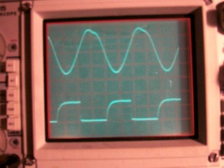

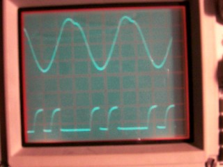

                      Then for no good reason I started thinking about sync pulses. The sync pulse ideally is a 50% duty cycle, or "dwell", square wave pulse. However, not all TGSLs are ideal. And it turns out that the gain of the Synchronous Detector is directly affected by the sync pulse dwell. As the dwell departs from 50%, the gain should diminish.
                      Now it also turns out I had experience to show that at low DISC pot settings, most TGSLs exhibit some really wild looking sync pulses. I was so alarmed at these waveforms that I devised the "SB mod" to clean up the sync pulse on my TGSL circuits.
                      Perversely, as nature likes to play with mortal fools, in the end it seems that really horrible looking sync pulses don't seem to harm the TGSL one bit. But it was something I made note of.
                      Flash forward to the present and reexamine the RX coil noise difference between dfbowers TGSL and mine. If his TGSL had less gain for some reason, that could explain why his noise seems less than mine. Since the sync pulse can affect gain, I decided to take a look there.
                      I had been testing with both of our DISC pots at minimum. When I compared our sync pulses -- hola! What a difference. dfbowers sync pulse consisted of two separate spikes, while mine looked like the normal slightly rounded square wave. dfbowers TGSL is afflicted with the typical "spiky sync pulse" syndrome when the DISC pot is near minimum. As the DISC pot is turned up, his sync pulse becomes normal.
                      See the following video comparison of dfbowers sync pulse vs. SB sync pulse while turning DISC pot min-to-max-to-min by hand.
                      http://www.youtube.com/watch?v=KDzPHPvO_4c
                      The reason for the difference in the sync pulses is because my PCB has the "SB mod", which works nicely, makes everything look better, but doesn't do a damn to make a better TGSL!
                      However, it offers an explanation why dfbowers TGSL has slightly lower gain at minimum DISC pot setting.
                      To confirm this, I observed the noise at the LM308 output while turning dfbowers' DISC pot from min to near max. While not easy to evaluate, it seemed to me that I could clearly see the noise get larger as I turned the DISC pot toward max, due to the more symmetric sync pulse. In fact, the noise looked very similar to my PCB.

                      In each photo, top trace is TX oscillator voltage, bottom trace is LF353 pin 7 output.
                      1. dfbowers LF353 pin 7 output -- oscillations due to overdriven LF353 input by TX oscillator. This corresponds to the driving signal when the DISC pot is at minimum.
                      2. SB LF353 pin 7 output - less oscillations due to "SB mod" voltage divider from TX oscillator. The small blip appears to be an overreaction by the underdamped LF353 to the small bump in the oscillator signal.

                                I wired the USB cable opposite of dfbowers (black/green, white/red), so I need to use a USB crossover cable to connect to dfbowers coil. This could add a little noise maybe. I do not need the crossover to connect to my new coil (the Alien).
