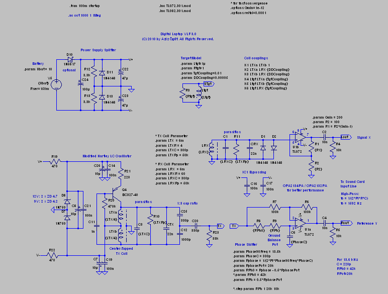

                Digital Laptop VLF First Cut Finished
                Hi all,
                Ok, the first cut of the design is finished now. But I was not happy with the distortions of the LC-oscillator from TGSL. So I made a modified Hartley LC-oscillator with it's own power supply voltage regulator (simple Zener-diode stabilized). It is driven with double voltage (bipolar power supply) and achieves at least 30 V pp coil voltage or 60 mA pp coil current. The LC-oscillator is quite efficient and consumes less than 2 mA. The TX coil is a center-tapped coil and delivers perfect sine waves (one of the advantages of balanced architectures). The high TX coil voltage must be divided via capacitor divider into some reasonable level before it is fed to the phase shifter. The output of the phase shifter is fed into right input channel of the sound card.
                The amplifier is trivial and it's output is fed to the left input channel of the sound card. The single-ended RX front-end needs a simple RX coil (no tap).
                Below is a short view of the complete schematics. I will provide a spice file later.
                Cheers,
                Aziz

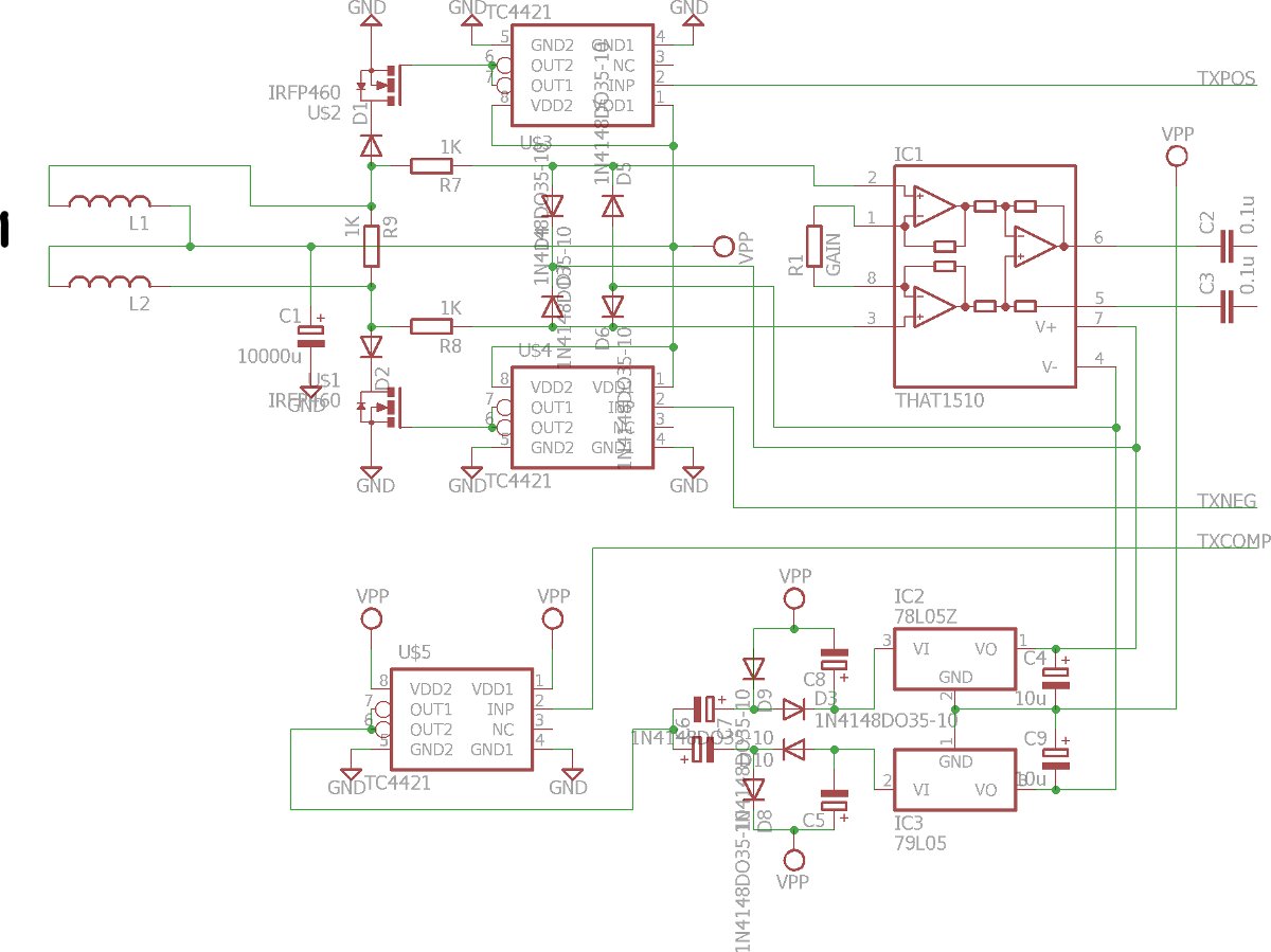

                  AND not only that but a FRONTEND for PI or VLF ( VLF tx not shown ) This shows the differential Pulse drivers ... diff amp and bipolar supply generator for the amp. The bipolar supply is generated by clocking a mosfet driver chip into cap /diode networks in usual fashion. The FPGA provides the clock and usually synchronous with TX pulses or whatever you like. For VLF a separate coil with 24 bit DAC and linear amp provides the TX signal.
                    here's a test for differential input .....
                    Hi moodz:
                    question: dfbowers recently experimented with coil connections for the TGSL where the RX coil is not grounded at all, only the shield around the cable is grounded (and one of the TX wires). Does that meet your requirements for differential inputs?
                    Also: what do you think would be the minimal, easiest microprocessor for trying a digital TGSL, meaning sampling the 15 kHz RX signal directly and doing everything digital after that. Low power would be very important too.
                    -SB
                    Take a 1.5 volt battery and 1k resistor. Connect -ve of battery to "earth".Connect other end to approximate centre of coil ... if the signal jumps significantly your circuit is not 'balanced' or differential as common mode rejection should not respond significantly to the voltage bias. For a digital TGSL I would put everything into an FPGA as it can drive the high performance ( or low performance ) ADCs and DACs. See my other post on this thread. Does PI as well as a side benefit.
                    Moodz

                            Hi all,
                            as you can see in my last post, the reference TX signal (reference Y) and RX signal (signal X) will be fed into the sound card input line. These represent not the complex channels X and Y. Only a basic lockin-amplifier can be realized with these two input signals.
                            For a true complex lock-in amplifier, we would need:
                            - Signal Channel (S)
                            - TX Channel in-phase (X),
                            - TX Channel quadrature-phase (=in-phase+90 degree) (Y)
                            Damn, but we have only two input ADC channels. Three would be required.
                            Therefore we have to make our own quadrature-phase channel from the in-phase channel using digital signal processing techniques. All we need is to do a phase shift of the TX channel by 90 degree. Damn, we are inventing the wheel digitally: a digital phase shifter.
                            I am soldering the new schematics. My test software needs also some changes. When it is finished, tested and finalized, I will put the final spice file and the schematics here. Stay tuned...
                            Aziz

                              Hi Aziz:
                              You decided not to drive TX coil from audio output this time I see. Any reason?
                              Also, you are not simulating a TGSL if you use lock-in amplifier arithmetic. TGSL uses the two channels a little differently. The two SDs are not exactly 90 degrees apart. The DISC channel sync pulse phase is adjusted by the DISC pot, and the GB channel sync pulse phase is adjusted by the GB pot -- so they can have a quite variable phase relationship.
                              Instead of quadrature arithmetic to derive the amplitude and phase, the two demodulated RX signals are low-bandpass filtered, amplified, and applied to a "threshold logic" detector, which triggers only when both signals go above an adjustable threshold. The result is a binary signal, from -5 to approx 0 volts.
                              The binary signal is actually applied to a low pass filter, whose output is applied to another threshold detector. So the pulses actually look like an RC integrated square wave -- a "exponential triangle" wave. Only the pulses that have time to rise above the threshold will make an audio tone. So it is kind of a "pulse-width" filter, only allowing a pulse longer than some time increment DT to pass (and subtracting DT from the pulse width).
                              That can all be modeled in software -- doesn't mean it is a good digital design, but would be interesting to model the behavior of an analog TGSL.
                              -SB
                              P.S. your oscillator seems to have nice properties.
                                Hi Aziz:
                                The reason? purely out of curiosity and just for fun.
