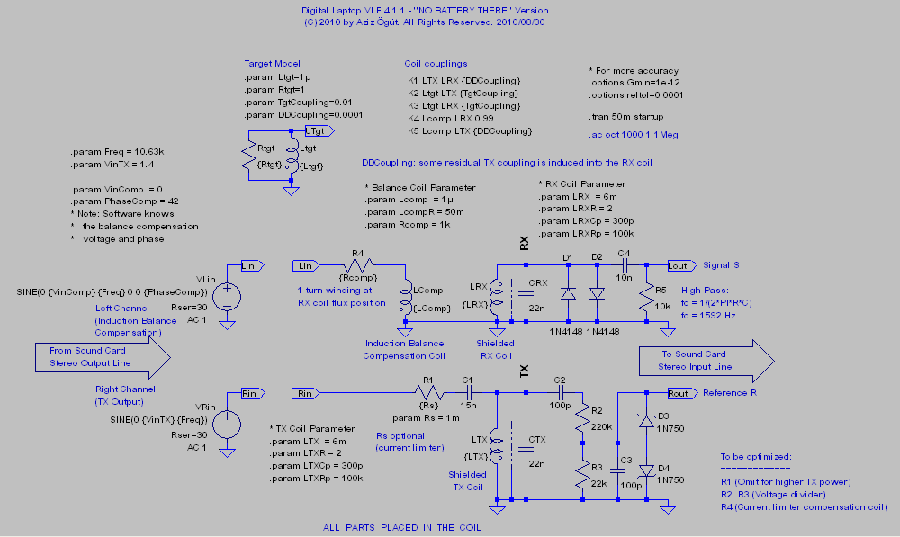

            Digital Laptop VLF Detector (KISS proven)
            Hi all,
            this is the ultimate simplest digital VLF detector. It's working passive only (no battery required). Some requirements for this detector:
            - high Q coils necessary (low resistance coils)
            - good quality resonant capacitors
            - external USB sound card (24 bit/96 kHz)
            - state of the art software (not implemented yet)
            The receive signal (RX) is strong enough to go above the noise floor level of the good quality sound card. The sound cards usually are AC coupled. So we can spare some DC blocking capacitors. Some parts needs to be optimized. If you like, place all the parts in the coil housing.
            Note: The transmit reference signal gives huge infos about the ground and target too. To get 3 pair of phase and amplitude information, you need:
            3 digital Lock-in amplifiers (software):
            - Sensing transmit reference against internal transmit frequency (internally generated) -> sensing the detuning of the transmitter
            - Sensing receive signal against internal transmit frequency (internally generated) -> sensing the detuning of the receiver
            - Sensing receive signal against transmit reference (note: reference clock from the TX voltage now) -> sensing the difference between RX & TX coil
            I have tested all variations. It delivers the required infos.
            If you process all the 6 parameters, you will get a perfect ground balancing and discrimination VLF detector ever (provided that, you can code it).
            If you need more TX power, plug a power amplifier to the transmitter. It will boost your transmit coil and increase the detection depth. Take care, the TX voltage can go really high.
            Now the induction balance mismatch can be compensated via the other output line connected to a compensation coil (1 turn winding). This should make coil developments easy.
            Please, do a spice simulation and see, what happens.
            Cheers,
            Aziz

              • #82
                Hi Simon,
                regarding the induction balance compensation:
                We need it for a defined RX phase and amplitude only. It is not intended to make it perfect 0. No, this is not recommended. We need some signal in the RX coil to lower the phase noise. But the RX phase lag is very important to have a coil with defined condition for a reliable ground balance and discrimination.
                Of course, one can balance the coil perfectly. But this is not recommended.
                Aziz

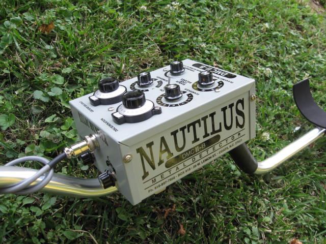

                  A little practical observation along with what Aziz is saying about not having a perfect null. I'm suprised that I'm the only one who commonly posts about Nautilus metal detectors. It's an old analog design but still has a good following with relic hunters in the southern U.S. Sure does clean up field of relics!
                  Nautilus has manual "air" balance as well a manual "ground" balance and adjustable Tx power. In practice, the best coil (air) balance is a bit noisy and I find that I need to adjust slighty off to one side for best performance. I have seen many others post this observation as well. Probably applies to many other designs as well?
                  Don

                      • #86
                        Hi all,
                        regarding the last schematics: There is a small bug, which I didn't consider. The receive resonant tank capacitor CRX should be of course larger than 22 nF.
                        The resonant frequency of the transmitter is approximately:
                        C = (C1 + CTX + coil to shield capacitance), C2 can be neglected
                        L = LTX transmitter coil inductivity
                        f = 1/(2*PI*sqrt(LC)), resonant frequency
                        C = 1/(4*PI*PI*L*f*f)
                        To get the CRX, just put LRX and f into the last equation and you get C.
                        CRX = C - coil to shield capacitance
                        CRX should be approximately 15nF + 22nF ~= 37 nF (shield not taken into account)
                        I usually tune the TX resonant frequency with my PC software by entering the frequency and observing the TX voltage with either an oscilloscope or the receive coil. At the maximum TX voltage, the TX resonant frequency is found. Then I plug a switchable capacitor bank to the RX part. Switch in or out some different capacitors until I get the maximum RX voltage.
                        Well, the small circuit is finished. I will plug it soon.
                        Cheers,
                        Aziz

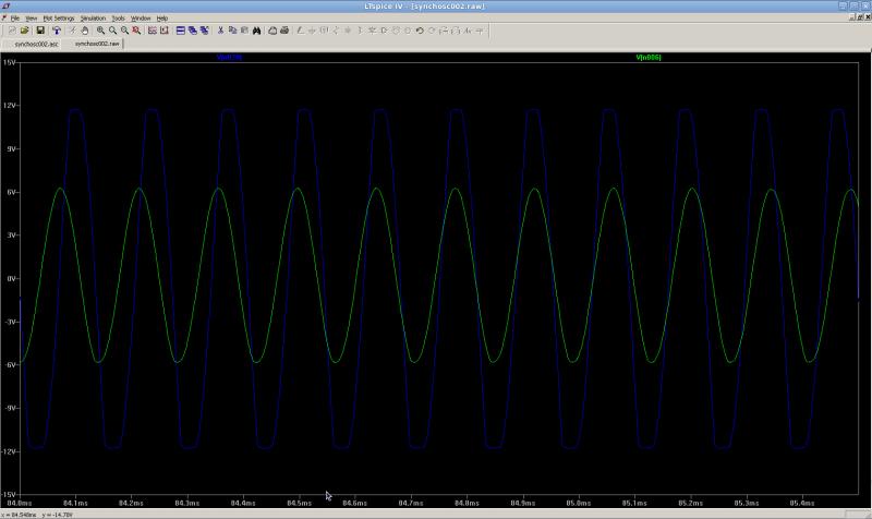

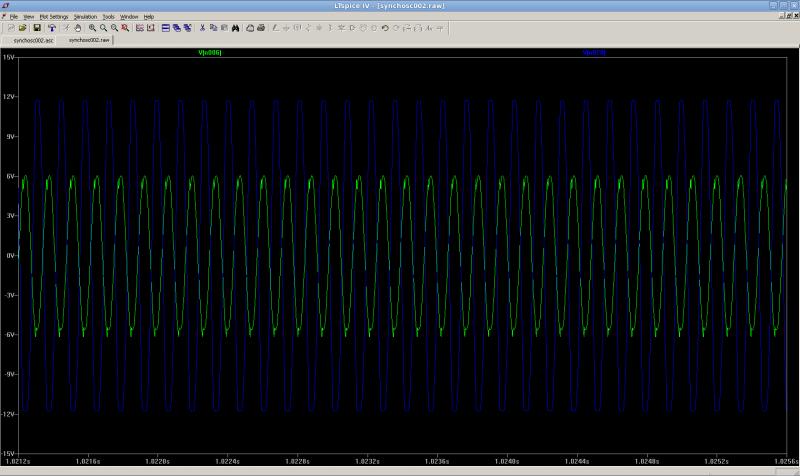

                              I have built the coils and practical circuitry into the simulation. There are now two distinct control paths between the two oscillators.
                              1. A phase lock ( and amplitude ) path through the coils
                              2. A frequency lock path internally ( ie not through the coils ).
                              The FLL frequency lock loop path maintains the two oscillators within 1 hertz of each other ( no crystals here ... the absolute frequency wanders a bit but the two oscillators are freq locked together ... but not phase locked ).
                              The important phase information now is undisturbed by the frequency servo control. Full phase and amplitude is brought out as four channels.
                              1. Tx Amplitude
                              2. Tx Phase
                              3. Rx Amplitude
                              4. Rx Phase.
                              The results seem to indicate that the coils can be couple of meters apart and it still recover accurate phase and amplitude.
                              I am sorry ... a small digital circuit has crept into the design. A single chip implements the FLL however it is garden variety logic ... so not to worry. A voltage tuned wein bridge oscillator forms the TX and the RX is still the classic sync oscillator ( phase amp ). The coil coupling is set to .01
                              The Kiss rating is better than 9/10
                              Moodz.
                              Below is output of the TX oscillator (blue) and RX oscillator in phase lock and Freq lock. Note the characteristic 'notches' on the the RX waveform. The phase relationship is 180 degrees here. One would hope that a target would alter this.

                              Below showing not phase locked but frequency locked. Rx coil was open circuited.
Name:	Screenshot-LTspice IV - [synchosc002.raw]-1.jpg

                              • #90
                                Don
                                To dfbowers et all.
                                If there is no target signal, the RX receives AIR & GND signal, ie synchronous demodulators operate with phase information for a carrier frequency. Without carrier frequency, the output of demodulators is only interference and noise. That's why you think that no need ideal balance in RX input.
                                I searched WEB for circuit diagram and manual for the Nautilus DMCIIB, which dfbowers showed in posting # 83.
                                Unfortunately I did not find anything useful, even there is no owner's manual written by the manufacturer or by designer of this detector.
                                The DMCIIB is very interesting for me, because its designer, Jerry Tyndall was experienced radioamateur (call sign WB4TFX). He ought to apply his amateur knowledge for receiving very weak radio signals covered with large interference and noise. He must not use voltage across TX coil as reference signal for synchronous demodulation. He should extract phase information about the carrier frequency from the received signal.
                                I will unravel whether Tyndall has tried to apply correct radio receiving principle in metal detector.
                                My request to all is: if someone has circuit diagram and / or instruction manual for DMC IIB to send them to me.
