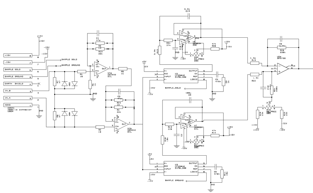

    attached is a input signal conditioning circuit.

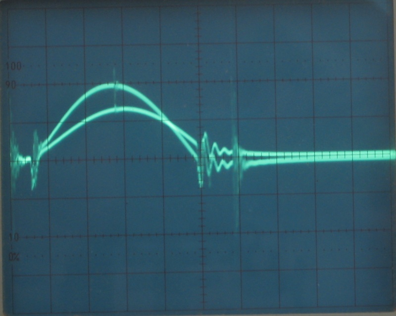

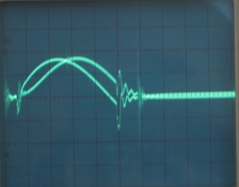

    The scope shots show the signal as it arrives at the board.
    The feedline is a twisted pair, plus ground from the center tapped RX coil.
    Signal with target and without target.
    A distinctive phase shift, as well as a change in amplitude can be seen.
    The scope settings are 5uS/div and 50mV/div.
    As is, the sensitivity gives 70cm for a 1 Euro coin. (In air, inside the house) The discrimination is outstanding.
    Many things can be improved and I would much appreciate help for the improvements.
    #1 Question: Impedance matching. The Twisted pair of the CAT5 cable has a nominal impedance of 100 Ohm.
    A home made twisted cable with all 3 legs, that is, the twisted pair and the ground, all 3 twisted together, gives a cleaner signal of greater amplitude. Obviously, the ideal cable could improve the S/N considerably.
    How should the ideal cable be?
    SUGGESTIONS?
    #2 Question: the signal conditioning circuit.
    I am sure it could be improved.
    I wonder how I should chose the capacitors of the filters?
    The output should match the input of an ADC. Is this level shifter OK? Probably I should use an AGC amplifier, because of the large dynamic range needed.
    SUGGESTIONS?

                          Good work ....the impedance of the cable is one thing ... but what is the impedance of the coil and your front end input over the bandwidth of interest. An LT spice sim could be written to determine this but theory and practice are different .... the method I have used in the past is using a Return Loss bridge over a swept frequency range ...
                          http://www.qsl.net/n9zia/rlb/index.html
                          The AD8307 log detector is works from DC to over 500Mhz ... you would also need a variable oscillator / or a wideband source / or the working circuit ( conditions apply.)
                          ReturnLossBridge1.pdf
                          This circuit is for RF but could easily mod for low freq to DC operation.
                              [ATTACH]13201[/ATTACH]
