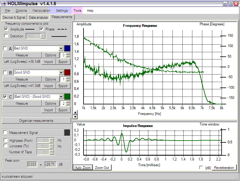

                          I obtained results with phase error trying to use the soundcard of my PC as metal detector. As you see, the phase of bad ground changes in too wide range, which is impossible in theory.
                          My computer shows two drawbacks at collaboration with the software HOLMImpulse:
                          1. The soundcard can not examine bad ground at frequencies above 7500Hz.
                          2. The microphone amplifier in soundcard operates with AGC (Automatic gain control). The settling time for gain reduction is about 4 seconds, ie my "metal detector" operates allways in motion mode.
                          I have two questions:
                          1. How to make the soundcard to examine frequencies up to 20kHz?
                          2. How to disable the AGC of microphone amplifier?
                          Does anyone know the answers?

                            Is your sound card built into the motherboard of your computer? If so.You could buy a cheap second hand slot in sound card and disable the agc on it's board.some old cards used bigger components easier to work on.

                                Hi Mike,
                                don't use the microphone input. Use the stereo line input.
                                Microphone input is often restricted (band limitted) to the speech frequency range (max. 8 kHz). It has a high input impedance and has a high gain, which is very very noisy. Mic in is usually mono channel.
                                Well, some "incompetent hardware *******s" implement a low pass filter on a high quality high sampling rate sound cards (low-pass fc << nyquist frequency). I have one sound card, which has a SR of 96 kHz but the bloody ******* allows me only 20 kHz bandwidth (I can not see the 20-48 kHz range even if I sample with 96 kHz).
                                And we have some "incompetent software *******s", which don't allow the high SR (96 kHz). Some of them even can't make the damn software stable & reliable.
                                Not every sound card is convenient.
