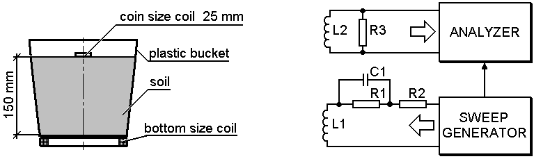

        Measurement of H1(f) and H3(f) when you have a bucket bad ground
        If the soil is conductive, its frequency response depends on diameter of excitation loop because it forms eddy currents and the value of fundamental timeconstant. For measurement of H1(f), the excitation loop should have the diameter of TX coil. For measurement of H3(f) the excitation loop should have the diameter of target (eddy loop diameter). If the target is a coin, the diameter of coin forms timeconstants of the ground for frequency response H3(f). That means the spectrum shape of H3(f) will be different from spectrum shape of H1(f), therefore we should make two measurements.
        Let we measure responses when the target has size as a coin. The sensing system of measuring equipment consists of a plastic bucket filled with 150 mm soil layer as shown below. The bottom diameter of the bucket should be as diameter of TX coil. A coin size coil is placed on the soil. A large coil with diameter as TX loop is placed under the bottom of the bucket. If you have not enough soil, use a small bucket and place the large coil on the soil. The coin size coil should be placed under the bucket.
        Measurement of frequency response H1(f)
        For signal receiving we should connect the coin size coil as L2 in the circuit diagram. Resistor R3 is for damping. For excitation we should use as L1 the bottom size coil. If we use for measurement the soundcard of your PC, we have resistor R2 inside sound card. The resistor R1 is used as damping resistor. Capacitor C1 compensates the stray capacitance of the circuit. Note that the measurement needs a wide band circuit, therefore we should make damping of both windings.
        Measurement of frequency response H3(f)
        In this case for signal receiving, we should connect the bottom size coil as L2 in the attached circuit diagram. The resistor R3 has other value. For excitation we should use the coin size coil as L1. The values of C1 and R1 are different from previous case.
        Before each measurement with ground, we should estimate frequency response of the system without bucket with ground. For this purpose, the coin size coil is placed on wood pieces to appear in 170 mm height from bottom size coil and measure the frequency response of system. Then we should reduce the height of coin size coil to 150 mm. The resulting difference of frequency response should have phase lead 90 deg relative to TX current for all frequencies.

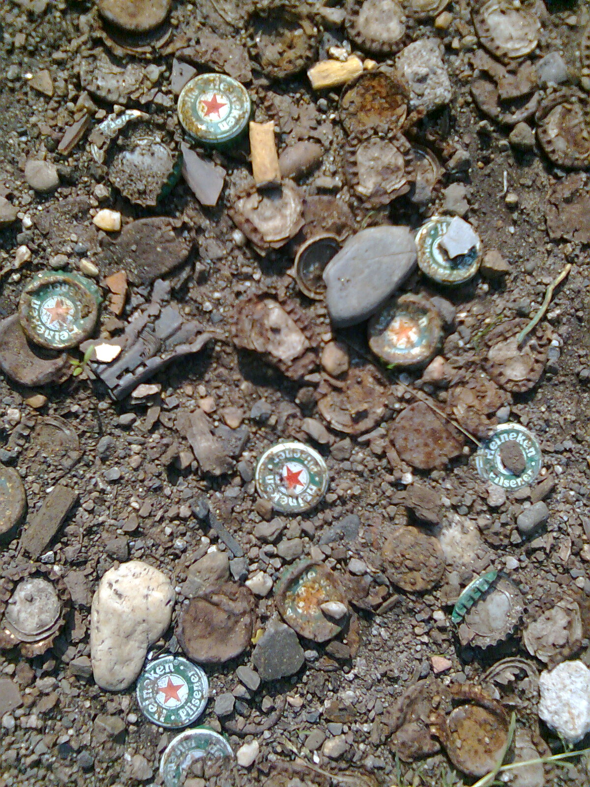

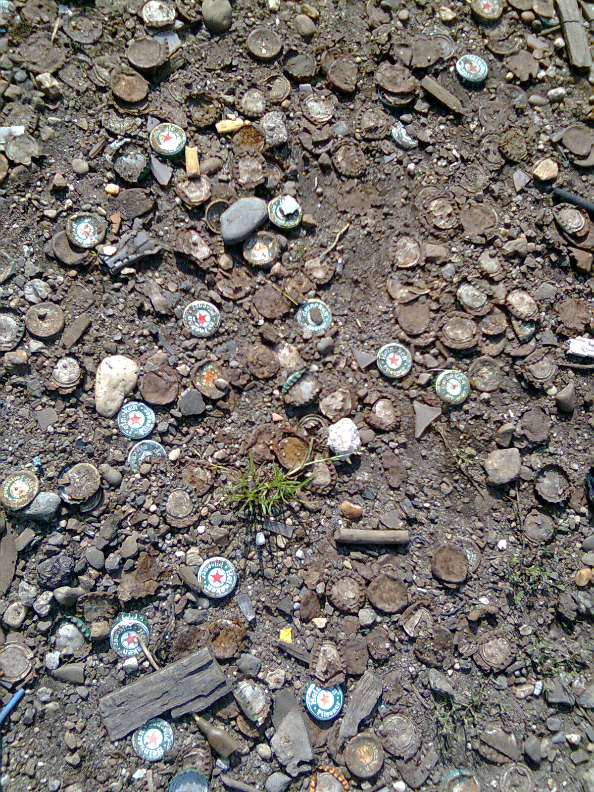

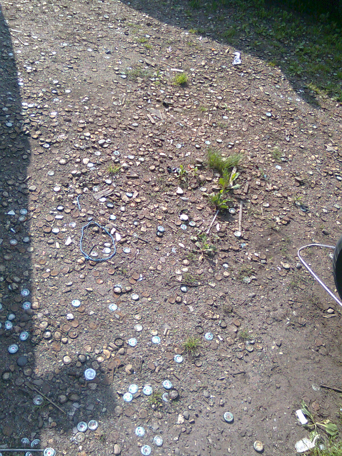

          For sale : worst ground ever
          I just ran into a site wich should be the nightmare for any MetalDetector :
          This ground is heavily polluted with the fruits of the Heinikus BottleCapus Ordinarus Tree :
          If you want some of it for testpurposes : I'll send it to you free of charge , transport costs not included
          kind regards ,
          Dennis the Mennis

          • #65
            kind regards ,
            Dennis the Mennis
            Ha! That is classic. Kind of a work of art.
            It gives me an idea - we should use our finds to do market research on consumer drinking habits and become high-paid marketing consultants for various beverage companies...
            • #66
              first thing i thought was "what a bloody mess"
              if i saw that i'd switch detector off and walk else where.
              to late now , many area's ruined by such rubbish , but has anyone invented a plastic
              bottle cap yet ??
              come to think of it , living in the modern age , plastic drinks "cans" with plastic ring pulls ,
              and pref bio-degradable .

              • #67
                In Europe we have already alot beer in plastic bottles with plastic screw-caps.
                I guess there is a chance to find something valuable at such a trashy place but first you have to clean up a bit.

                      • #71
                        imagine if you had to live there, must be a right old dump, but far as detecting it looks like tramps live there so i give the place a zero in finds
