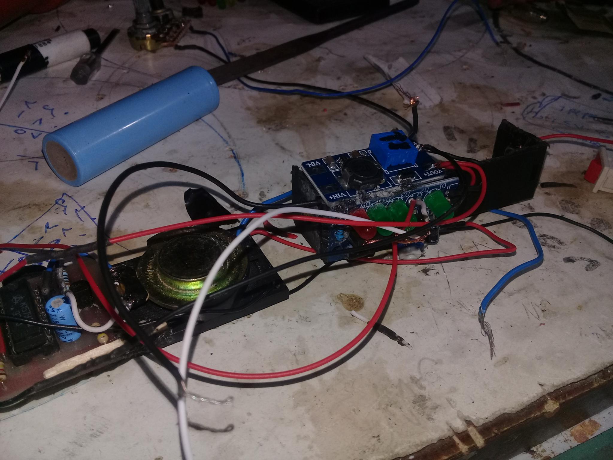

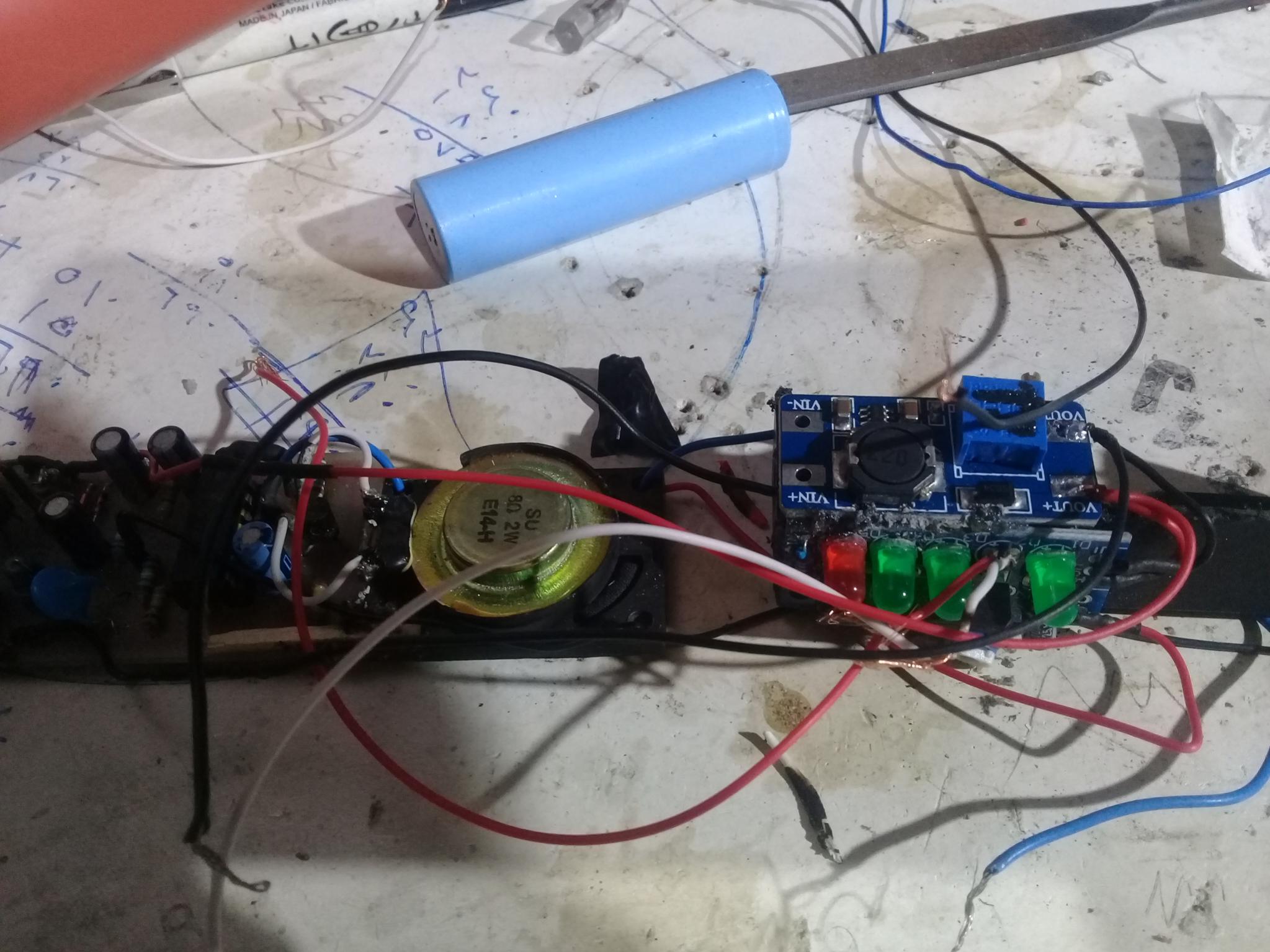

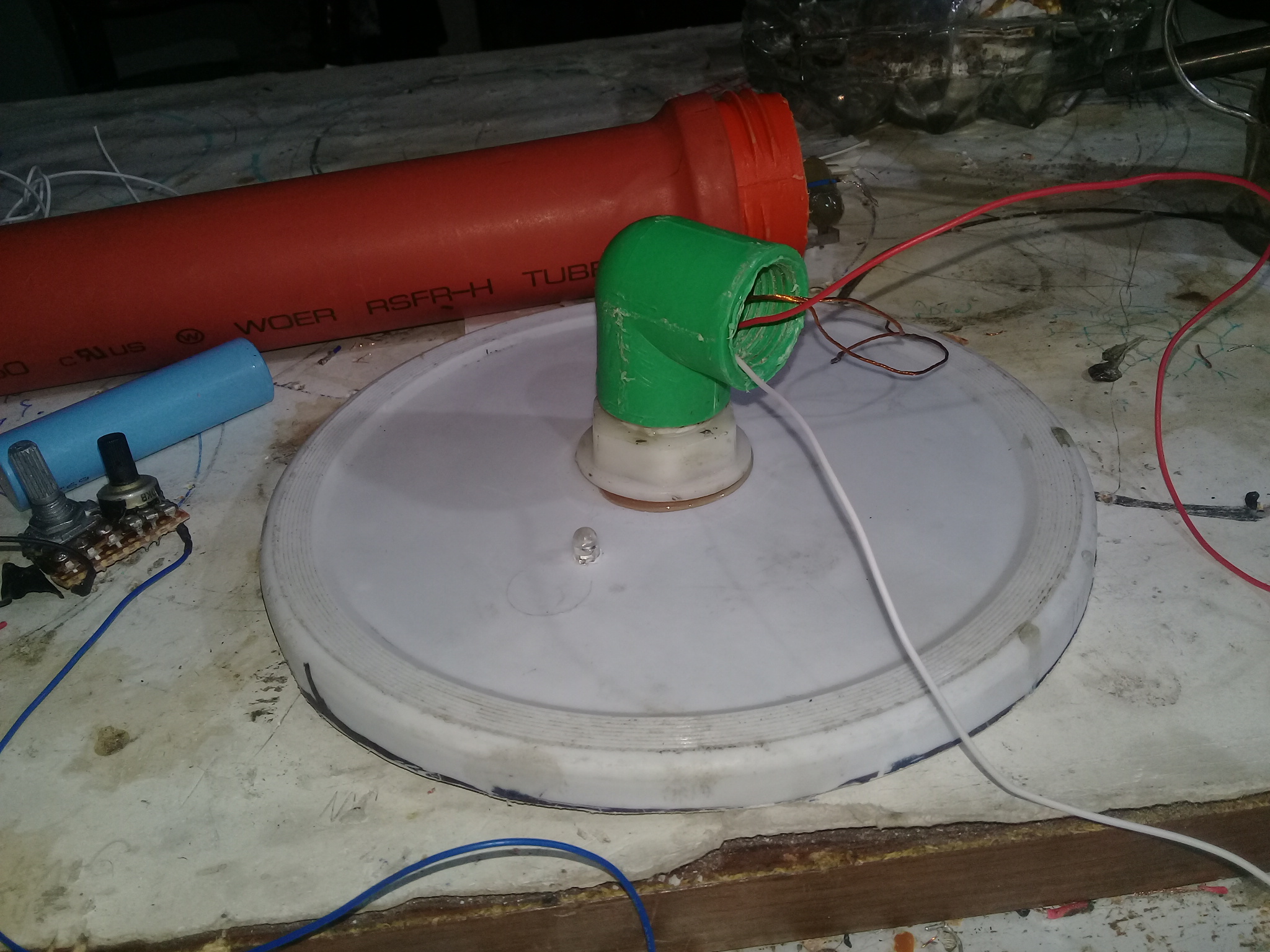

                  Hello my friend, I am now working on the Pirate Metal detectorUnderwater
                              Salam, I am happy for your reply and that you can built a good detector now!
                              I saw complete series Chameleon with Haifa, now I know Egypt better. *laugh*
                              Very "hot" country, perhaps homebrew MD will be the best solution for you.
                              Sending detector by post-parcel from Turkey to correct person might work.
