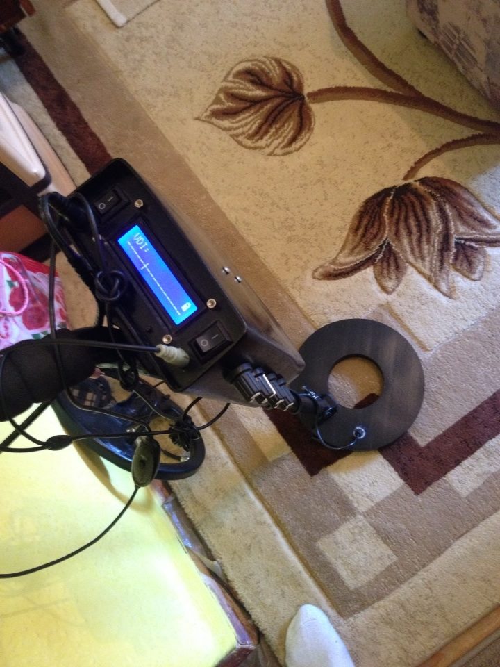

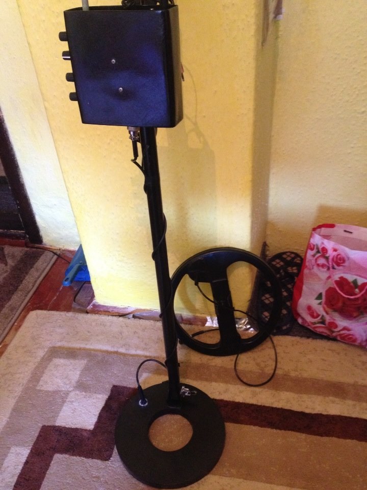

                • My IDX Pro with 2 coil CC 22cmm and DD 27cmm
Name:	idx pro 1.jpg
ID:	341292Click image for larger version
                  • Originally posted by seadoggy View Post
                    [ATTACH]30656[/ATTACH][ATTACH]30657[/ATTACH]
                    Well done looks very professional.
                    Are you happy with its performance.
