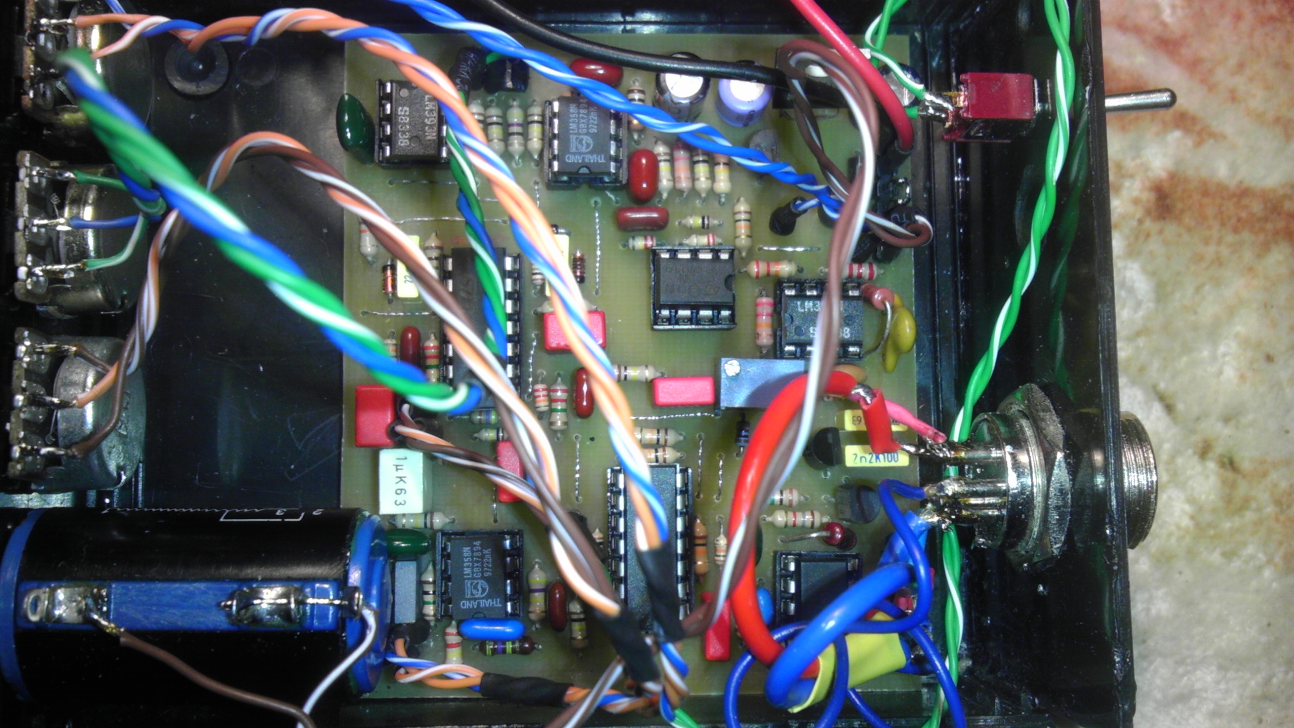

        • This is my detector, but I have a problem setting the GB. Key PP raboti.Pri me how when you turn the detector is silent, and when I move tresh sound constant sound and no reaction to metal.

              How to set up GB? switch PP how it works? ТХ 5.25 АС volt (multimer) TX-0.75 33 , RX-0.15 265

                  Try increasing the capacity of the capacitor in parallel with the RX coil. I want more details about your coils and capacitors TX and RX. The videos do not help us much if you do not publish here the parameters of its coils.
                  • Tx -33 turns 0,75 ,Rx -265 turns 0.15 /Tx 6.554 kHz Rx 4.604KHz http://youtu.be/RP74P89ACJQ
                    Tx 1mF Rx - 30nF

                      The inductance of the coils TX and RX? You have used a different diameter wire. I use wire of 0.20 and 0.60. My inductances are: 34mH for RX and 0,580mH for TX. You have to get these inductances. My capacitor for RX is 36nF, and TX capacitor is 1,22uF.
                      • Well, what function key PP plays. Upon my only constant sound and no reaction of metal.
                        Remove ferrite! Tx 0.558 MH, RH 35mh
                        • problem is solved ,bad contact.
