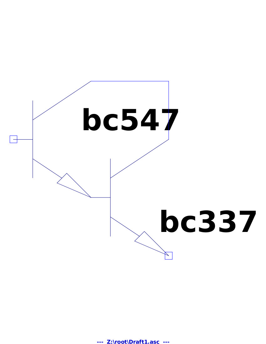

    • Hello to all
      I thought I'd replace the transistor BC517 (untraceable) with BC547-BC337 couple in Darlington configuration audio amp.
      you think you can do?
      I'm building IDXpro Silverdog pcb.
      Thank you all

        No,u can't.
        Because mpsa13/bc517 is darlington type.
        • Hello
          I explained bad, practically the BC517 is replaced by 2 transistors (BC547-BC337) mounted and connected in a darlington configuration.
          hfe the gain is the sum of the 2 transistors.

          • I remember, that some years ago for another project, I replaced a MPSA13 by only BC337 and it was working very well. Even until today, I never changed this transistor.
                  thanks Blobber
                  I try BC337 hfe looking for a good gain.

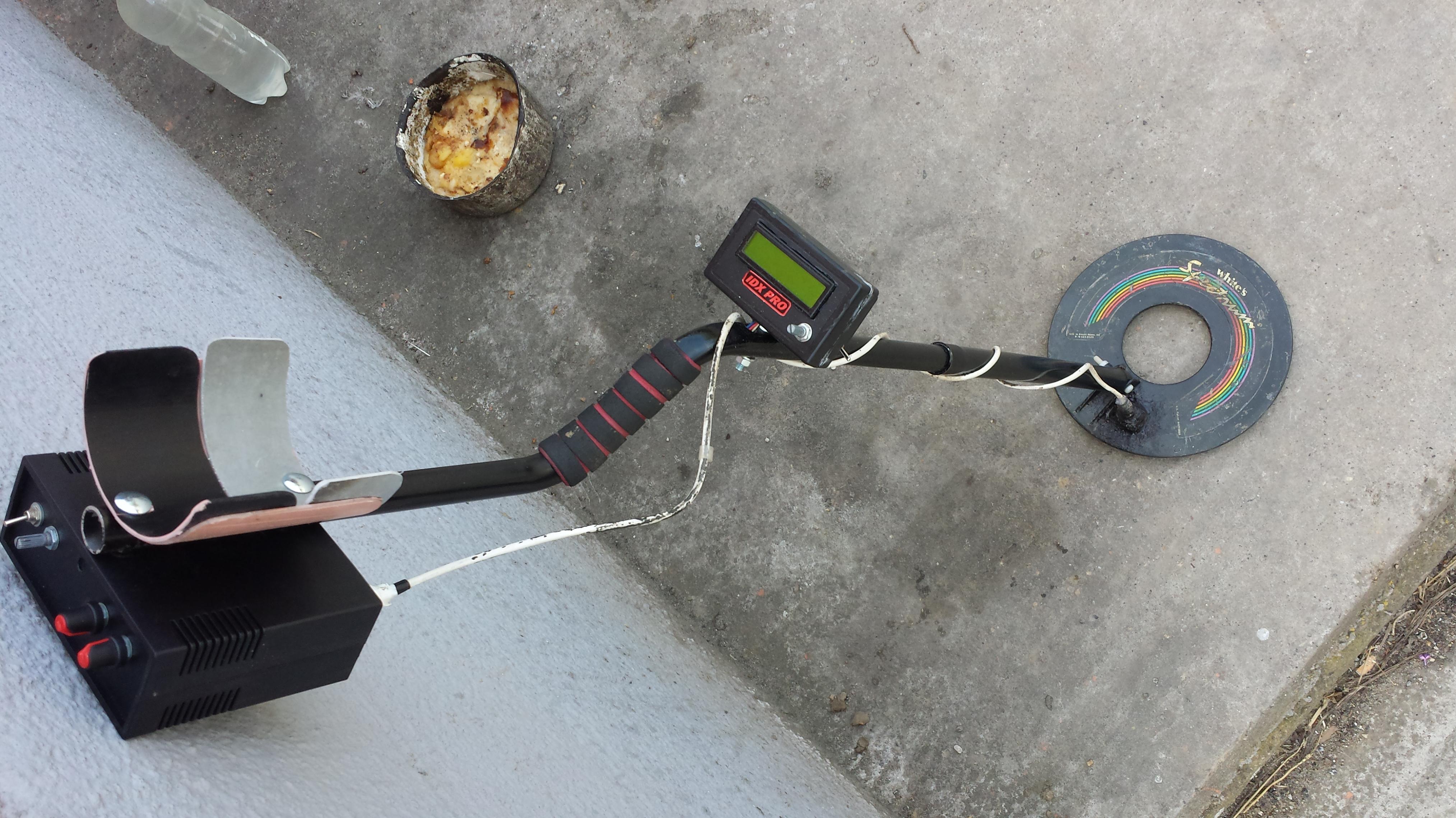

                        This is my with arduino vdi, but with unfinished cosmetic's.

                        • Thats very nice man ! We hade the same idea even the foam grip is the same black with red! Is your stem made of 2 piece's can you separate them? Thats what I wanted to do but have no idea how to make it. I like the coil thats my favorite of the White's design. You helped me a lot thanks again!
                          • Very nice design!
                            How is your performance in air?
                            You have made two gaps in the graphite layer, right?
                            • Thanks!
                              Yes I have made 2 gaps so the layer is not continuous. Well with a 50 eurocent ( I have no 1euro at home) it's almost 33cm. It performs a bit better than my TGSL in air test.
