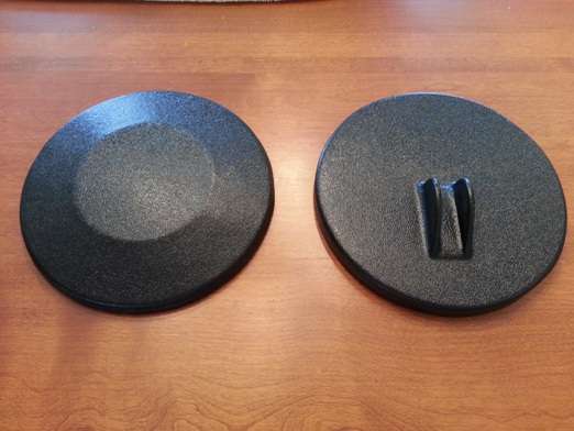

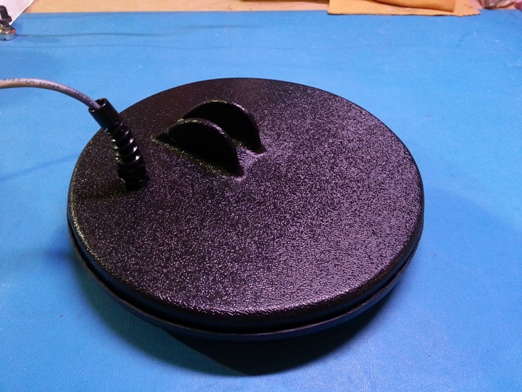

          • My project of the week..
            http://www.youtube.com/watch?v=buU4h2QpgOw
            I wanted to see how cheap I could build an 8" coplaner coil for IDX. Turns out, under $20.00! I did have to break out the vacuum forming machine. This was not an easy project compared to a DD coil as tuning was a little tricky between the Tx coil and the bucking coil.

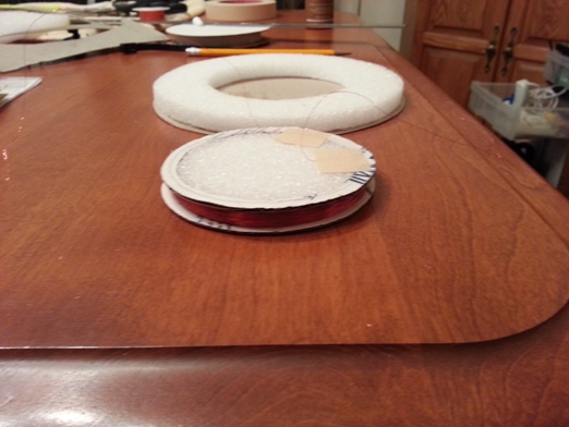

            Start with a sheet of 1/2 inch foam board from a craft store - It's "large cell" foam, that is somewhat brittle but also stiff.

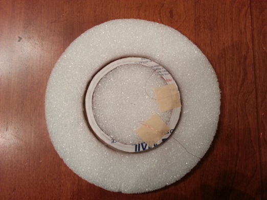

            It is cut into a donut shape to accept a spool for the Rx coil.
            The Rx coil is wound on a homemade spool of cardboard with a foam center.
            The foam "donut" is then glued to a sheet of stiff cardboard and the Rx spool is glued into the center.

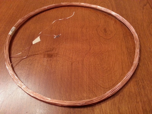

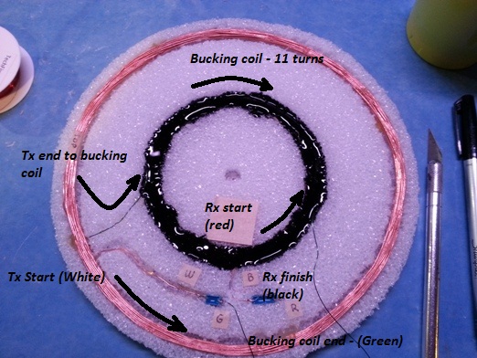

            The Tx coil is made on a separate former and held together with Cyan glue. Then this coil is simply glued into a channel cut into the foam. The bucking coil is wound opposite the direction of the Tx coil - directly on top of the Rx coil.
            After tuning and nulling, the inner ring is filled with slow cure epoxy.
            Rx coil - 3.25" - "about" 425t for 34 AWG wire (35 mH) wound counter clockwise + 33nF cap
            Tx coil - 7.5" - 34t for 22 AWG wire (583uH) wound counter clockwise + 1 uF cap
            Bucking coil - about 11 turns wound on top of Rx coil wound clockwise
            For the best null, the hot end of the Tx coil must be connected to "Tx start" (P8 pin 1)
            The grounded end of the Rx coil must be the wire closest to the bucking coil - " Rx end" (P8 pins 3 & 4).
            For the tricky part - When the bucking coil is wound around the Rx coil opposite direction from the Tx coil, the frequency goes up by about 60Hz, so a turn or 2 will have to be added to the Tx coil to bring the frequency back down to 6.59kHz.After tuning and nulling, the inner ring is filled with slow cure epoxy.

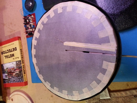

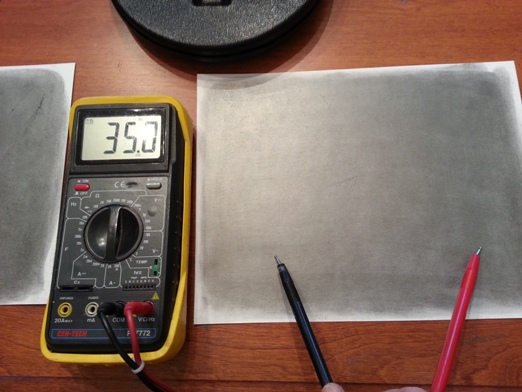

            For shielding, I used heavy gauge paper, covered with graphite powder from the hardware store. I just dumped some on the paper and rubbed it in until I got a conductive sheet of paper. The paper ended up with about 35k Ohms of resistance across the entire sheet yet is not detectable by the coil. A drain wire is then attached with masking tape and a bit of conductive glue made from a slurry of rubber contact cement and epoxy. Amazingly enough, rubber contact cement can become conductive if enough graphite is mixed with it. (maybe someone can comment on the effectiveness of this practice, but I can demonstrate that it does work).
            For a cable, I just used Belden 8723.
            Enjoy!
            Don
            • Very good job Don. I have a stock coil (concentric) of 9.5 "and it works great. Here in Spain there are areas with highly mineralized land, land of red clay, and concentric coils barely detect a coin. Coils DD, compared to concentric defend themselves a little better in these conditions. Congratulations on your good work.
              • Amazingly enough, rubber contact cement can become conductive if enough graphite is mixed with it. (maybe someone can comment on the effectiveness of this practice, but I can demonstrate that it does work).
                Great work Don
                interesting about just rubbing the paper with graphite.
                No need to doubt your results with the rubber glue.
