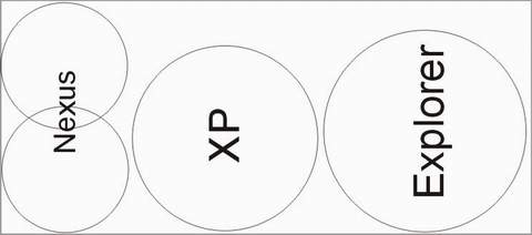

                      Italian comparative test of Nexus Coronado:
                      It is not clear which dimension ("height" or "lenght") of Coronados OO coil was used in account.
                      According to that test - XP is still the best!
                      Why?
                      Simply, just look on sketch bellow (it is 100% accurate, made in Corel)
                      No need for any further explanation...
                      P.S.
                      Don't know what "Standard" means for Garrett and "Super 12" for M6 coil?
                      It could be from 20 to 32cm in diameter.
                      • #41
                        Resonant OO coil is same efficient as non resonant DD coil with size relation like this:
                        • #42
                          Nice drawings. Thanks.
                          I do not know for Garrett, "Super 12" is 12" (inch) coil or about 30cm in diameter.
                          Of course test say nothing how perform competitors with same bigger coil. We cannot simply say better, but probably better (some detectors may become unstable with bigger coil).

                            Most probably it is like that, but i was not sure and that's why didn't include it.
                            Not so important.
                            Garret is pretty tricky thing (already talked much about it on other topic).
                            Don't know nothing about M6, never saw it in my life...
                            Nexus is ok, fact is that it's coils are OO resonant ones.
                            OO resonant coils are just good, close to perfect (in theory).
                            But those lacking on practicality and comfort of using in some situations.
                            Those are just perfect on leveled soils with a lot of space...

                              Agree, except that you avoid to answer my (repeated) question which dimension is valid in case of OO coil "height" or "width" ("lenght").
                              6" is the diameter of one of the loops. So we should really compare the area under each coil, rather than the diameter.
