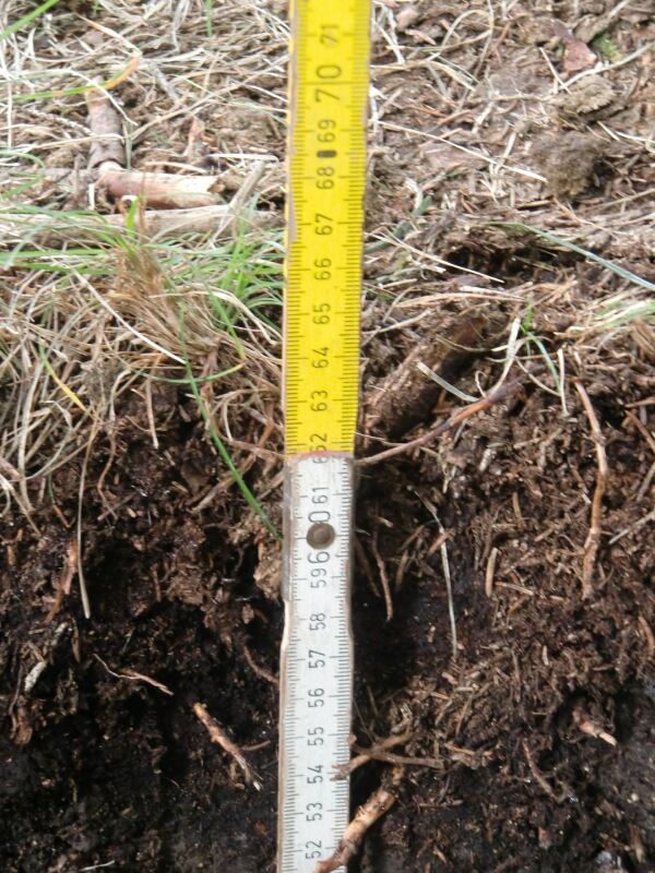

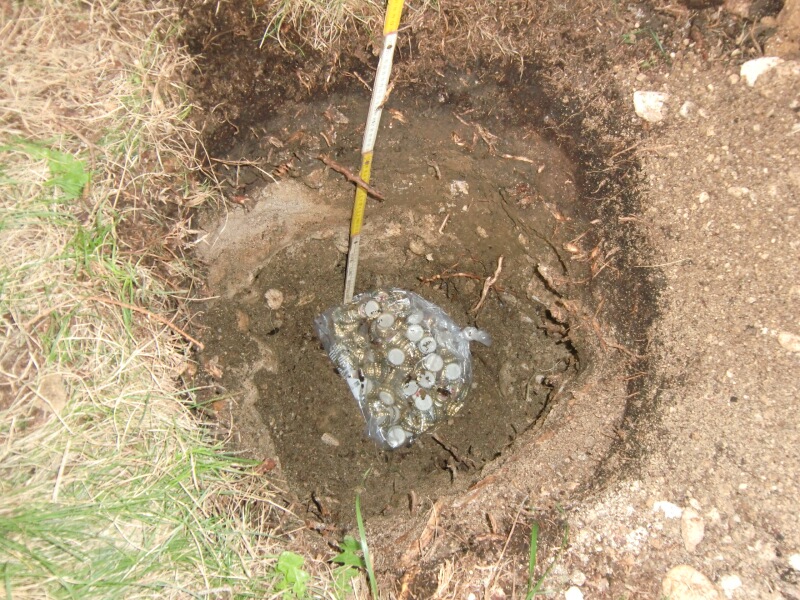

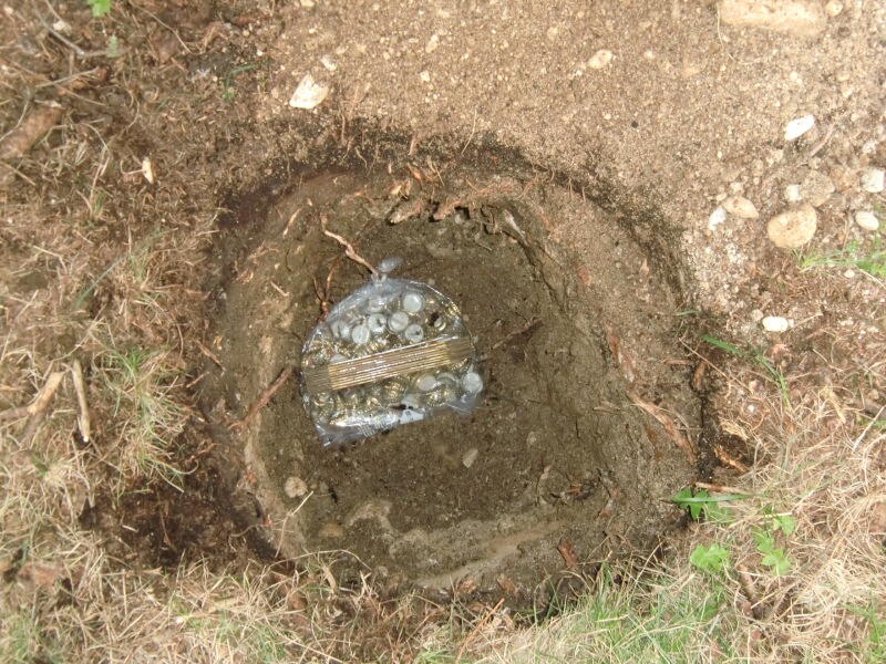

          But even my around 2 years old Blisstool already passed
          through the "cache @ 2 feet"-test last year - one pound of
          bottlecaps in fridge-bag at a diameter of ca. 20cm / 8 inch
          in high mineralized loamy soil.
          The LTC64 detected it with a very long and fading sound -
          if you ever should get such a signal it's a very deep target.
          There exists absolutly no doubt that the new Blisstool with
          38cm / 15 '' coil will pass the 1kg coins @ 2 ft test under
          usual conditions !!!

          • Try to put in the same hole 1kg coins ,coated with varnish and no electrical connection between them!

                        No. Metaldetection works with induction currents so even lose "rusty" coins amplify the overall EM-field as we have tested already.
                        Besides: if metal-ions of long time ago buried corroded coins penetrate the surrounding soil this also improves the overall field effect.
                        Of course freshly buried old coins with bad surface contacts to each others are not as good detectable as new ones.
                        What really counts is the surface. A small thin layer of alu-foil 10x10cm is almost the same good detectable as a 10x10x10cm iron cube!
                        No matter if the alu-foil is cutted to tiny bits with no connection inbetween. You won't find a single coin-stack of 1kg where the top of this stack is at the 2ft mark, but if the 1 or 2 pound coin cache has at least 15cm diameter.
