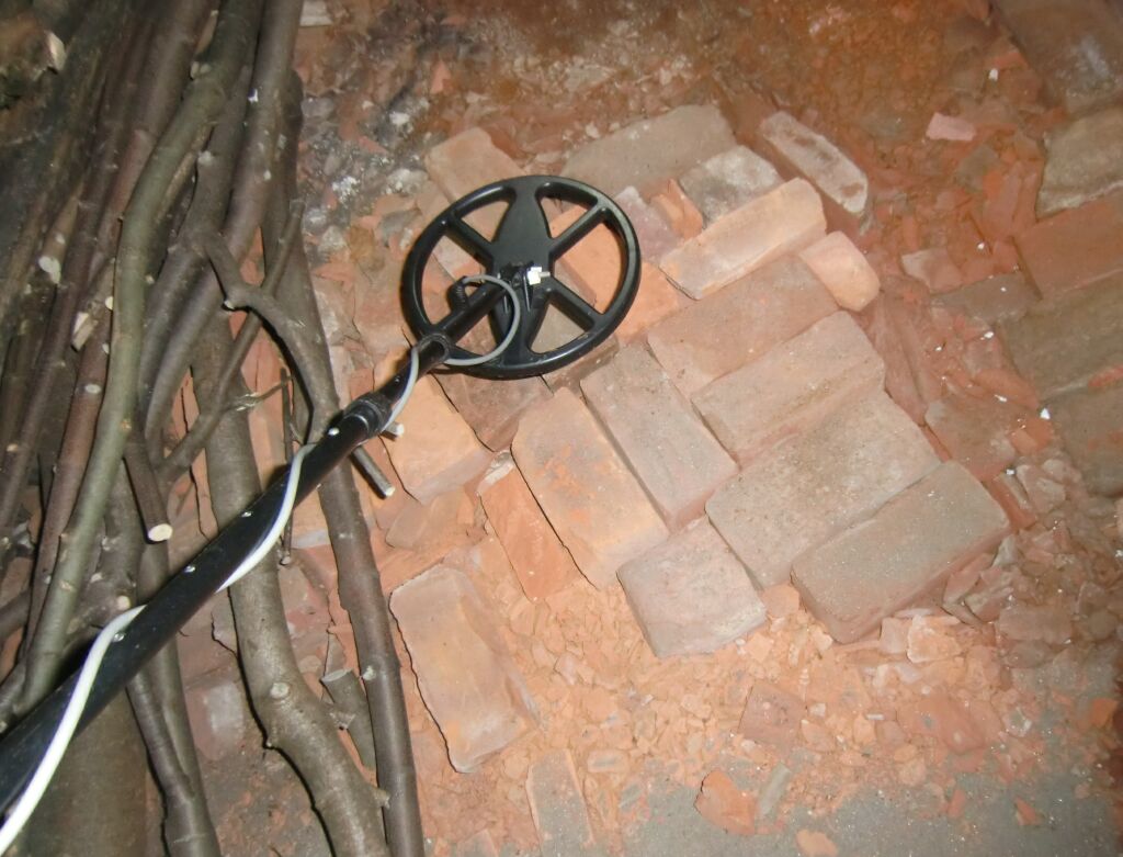

                        • Mineralized ground test & videos
                          As pronounced here now the mineralized ground test(s):
                          http://www.qooy.com/files/1CRJY1ZXGK...ineralized.rar
                          38MB, containing 4 short movies and 7 pix
                          Settings:
                          - Ground balance manual - rudely @ 7 (from 10)
                          - No discrimination
                          - disc level 3
                          - silencer @ 9
                          - threshold @ 1 and @ 5
                          The tuna-can with 8cm (3'' plus) diameter bottom up was at 25cm
                          (10'') and the canadian silver dollar, 1 oz. and 4cm (1.5'' plus)
                          diameter was at 15cm (6'').
                          You can draw your own conclusions but my personal fazit is:
                          Hunting at very high mineralized ground is a problem for the
                          Blisstool unless it is not a relative big object.
                          Sweeping the coil too close to the ground may lead to false
                          signals if not done with extreme care and very slow.
                          Sweeping the coil 10cm above the ground works - in that
                          case you will get no false beeps or double beeps, but of
                          course reduces alot depth.
                          In the videos the coil was moved sometimes up to 20cm
                          above the surface. No problem for the tuna-can. but the
                          coin was just detectable from 10cm above ground
                          (total distance 25cm).
                          Of course under real search conditions you may find
                          seldom ground conditions heavy like that - perhaps
                          if there is volcanic stuff, black sand or heavy loam.
                          And those bricks I have used are not all completly the same.
                          But my test area is compact and contains bricks down to 50cm
                          all over and not just a few are on the floor.
                          Because in the first place I want good test results that's why
                          I'm interested in good test conditions, too. Now it's clear that
                          the Blisstool can penetrate even very high mineralized ground
                          and does not just detect this ground with double-beeps - BUT:
                          small stuff is a problem because of the needed higher coil-ground
                          distance and so alot overall depth gets lost. Working at higher
                          threshold level under such conditions either needs alot training
                          or can lead to failure-signals.
                          The max. detection distance for the 8cm tuna-can was ca. 50cm
                          (25cm bricks, 25cm air). Air only would have been ca. 75cm.
                          Btw: the Blisstool with 11'' coil is still deeper than the
                          Garrett GTI 1500 with 18'' coil - this has been tested very far
                          away from e-smog and at middle mineralized ground.
                          But the Blisstool is not that lightweight as my modified
                          hang around the neck GTI and doesn't cover so much ground -
                          thats why I prefer the GTI in steep areas - but not all the time.
                          An experienced Blisstool user will find 50% deeper targets
                          compared to a beginner who may even get mad or crazy
                          by that erratic background chatter or works therefore at
                          minimum threshold level which of course leads to less
                          sensitivity. You can compare this in the videoclips too,
                          you can see 2 tests @ threshold 1 and 2 tests @ th. 5.
