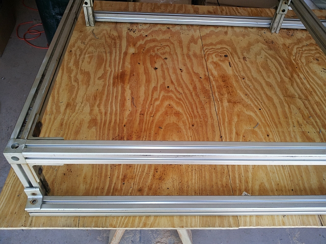

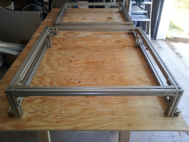

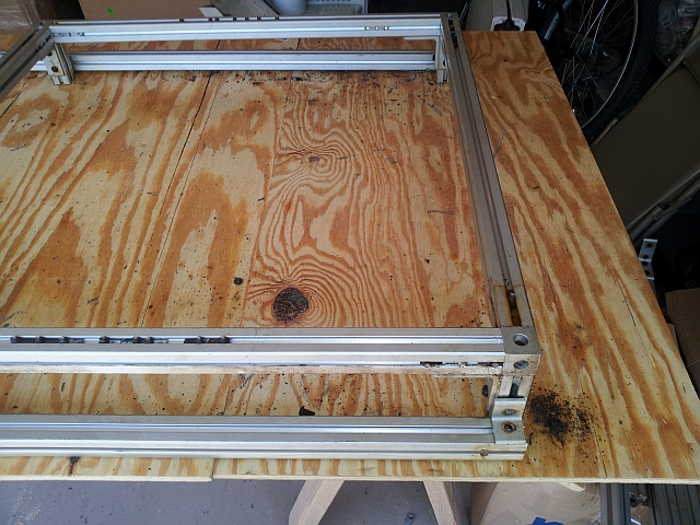

    Started laying out the frame this weekend. I built a raised work bench approx 4ft x 8ft and 30" high for laying out the frame.
    I made good progress on the frame. I have the two sections cleaned up quite a bit, and have the connection bar ready to couple on both sides.
    Attached are pics of the frame and work bench.

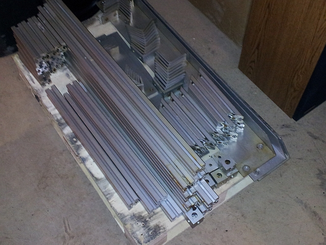

                        OK, Been working on the chassis parts lately. I almost have all of the salvaged 80/20 extruded aluminum torn down, cleaned, and ready for assembly into a chassis. I received the generator yesterday too, yay! That's the last major piece I've been waiting on, so from here on its build, build, build.
                        Attached is a screen capture of the cleaned up and disassembled 80/20 aluminum.

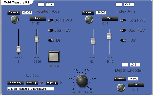

                        Been working on a project at work this week. It was a quick turn around 2 axis measuring application. The great thing about it it, is it gave me another good run at the Flowstone software. It looks like that will indeed be promising as a GUI and Phidget interface. Got to try out some features I hadn't before, namely data logging and multiple Phidget Axis control. Learned some helpful stuff.
                        I have a screen capture of that GUI just to show an example of what Flowstone can do.

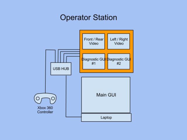

                                Operator Station
                                Using those LCD screens, here is what I will try for the operator Station.
                                Keep in mind, the Flowstone can create nice little applications that I can scale to fit nicely into each of these screens.
                                I will use 4 of these screens for the Operator Station, and 1 in the Rover for a diagnostic display.
                                The key to this configuration is the USB interface. Multiple displays can be interfaced to the same computer. Tonight, I will see if I can indeed run 4 screens on one laptop. Obviously, I will be using a powered USB hub for this test.
